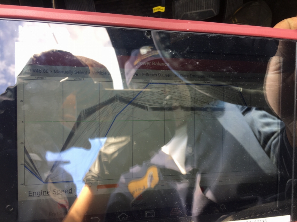

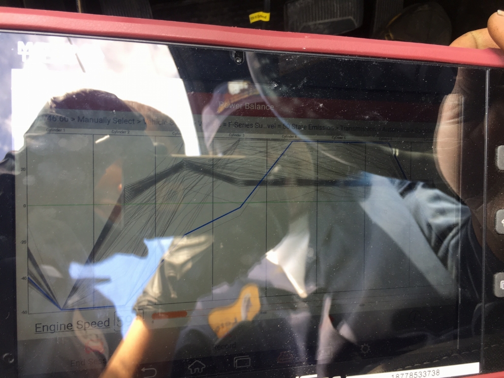

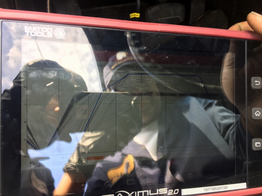

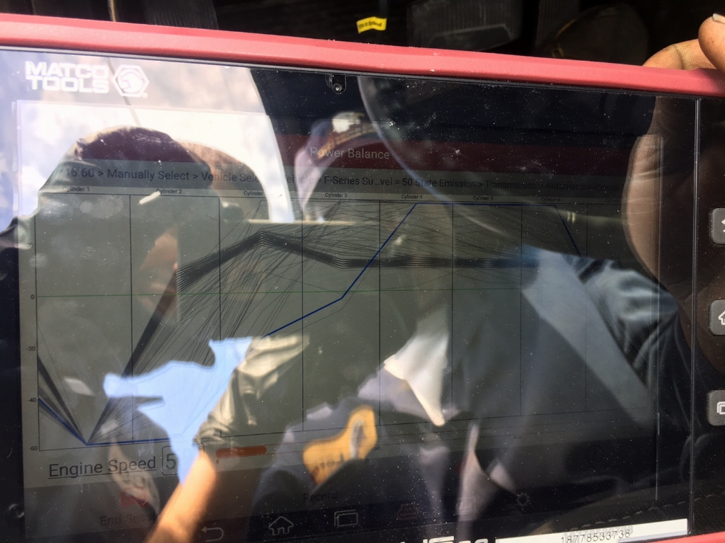

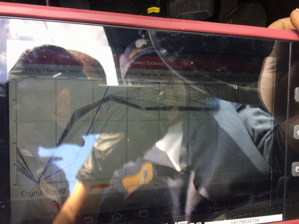

my god you canadians and piss poor pictures and sideways videos...
thats either a cracked piston or broken valvetrain(cam/lifters)

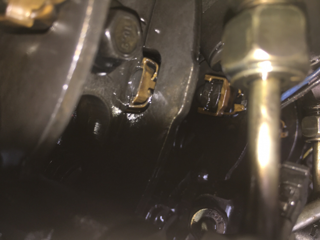

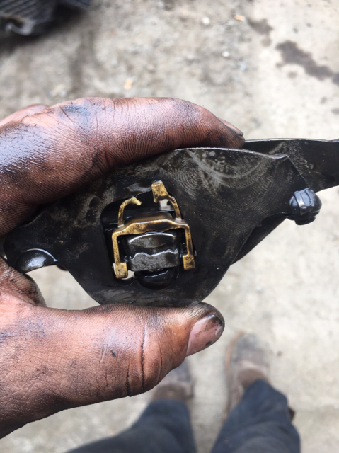

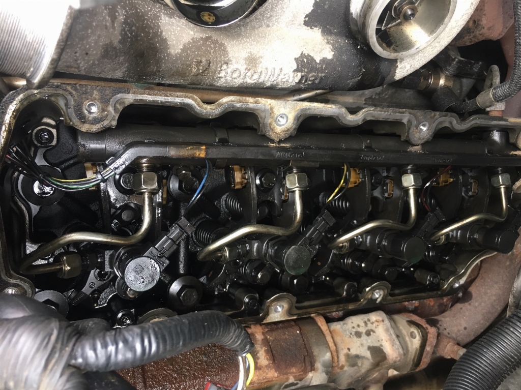

Got the driver side valve cover off,
Thinking I see a broken rocker?
DEEZUZ
NO PUKESTERS
Jun 30, 2011
6,934
223
NWI
I don't see anything broken. If your focusing in on the yellow plastic holder, that's nothing to worry about. Are any of the rockers loose? Start and run the engine see how it looks.
Roccafellas
May 7, 2017
357
That crack in the second yellow clip not the clip the metal button inside of it
DEEZUZ
NO PUKESTERS
Jun 30, 2011
6,934
223
NWI
casting mark.
please start in on the other side... Where #1 is
