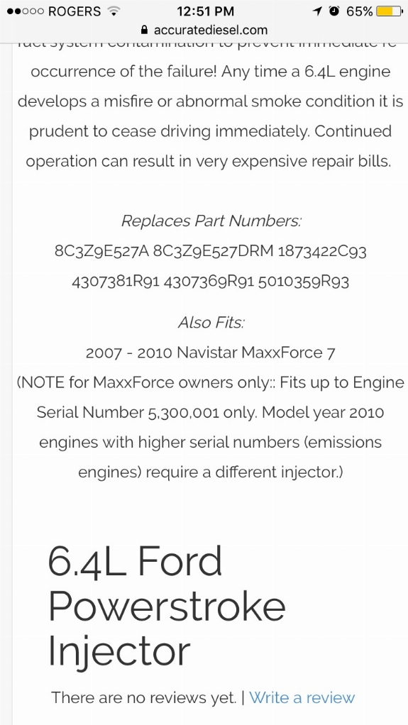

Question for you guys.. upon discussion with this guy about his new injectors, scheduled a trip to go get them. But out of curiosity i asked the make, he said International, I did some research just now just to make sure they would work if there from a maxxforce 7... sure enough I found what I think is a problem. Man it's a good thing I haven't paid for them, already dealing with one guy whos unresponsive for my refund.
Problem is that upon reading it says 2010 and up maxxforce's have different injectors... well.. on the info card on the box it says 2010..... so maybe buddies selling them so cheap because he knows they wont work and is a scammer? You guys tell me, i'm going to post the info car, tried a search of the part numbers to find nothing..
are these the wrong or right injectors?
webb06
Aug 14, 2012
3,892
12
Seneca, MO
Look like 6.4 injectors to me. If that's what's actually in the box.

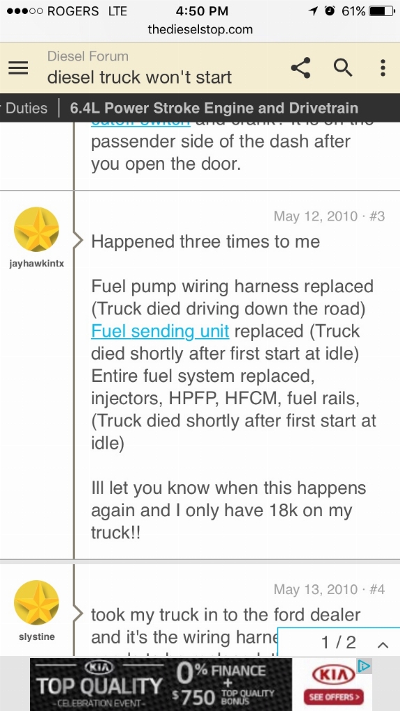

So I just got back from the machine shop everything going smoothly so far lol. Knock on wood! The blocks painted Crank and pistons basically the short block is put together I just brought the upper and lower lower oil pan. I was standing there looking and noticed that they took the high-pressure fuel pump out and I was wondering to look at the wires so I grab the actual harness that sits underneath the cover and I looked at it and as I'm talking to the guys telling them that you know sometimes these wires chafe cause problems sure enough I look at the wires and they're both chafed I mean bit right through down to bare metal they both looked at it and were shocked so I'm wondering if maybe that caused a problem what are the odds though the guy that I bought to use Block from gave me an updated harness with the loom on the wires so we're going to use that but just as I was telling them I look and I see that it chafed the wire I wonder if that could've been the problem!
Roccafellas
May 7, 2017
357
If this is the case,
I woulda replaced the fuel system for nothing...... obviously not nothing but I mean there would of been less worry!
If the same thing happened.
Should I also wrap them in electrical tape too? Over the loom for added protection?
