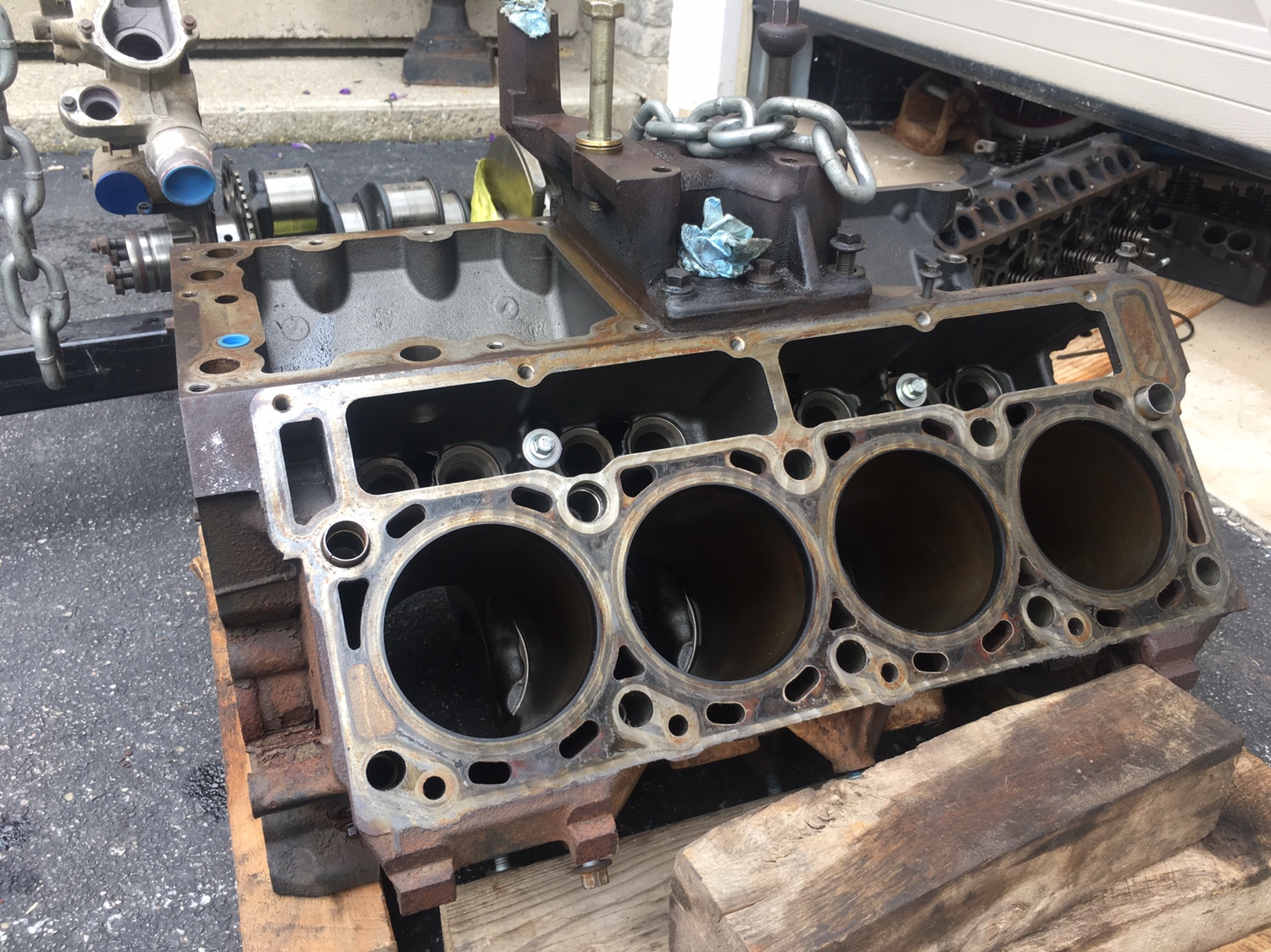

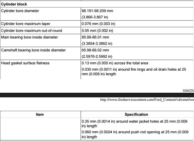

Hey guys.. can someone give me a hand... the machine shop where my engine is
Is asking me for the "standard bore size"
He apparently went off his books and found two.. one is saying theres a little wear which he thinks is possible
And other one is saying the block is .10 under...... which is impossible... so..
can someone give me "the standard bore size please"
Thank you.

See attached images...
rockycreek
Aug 23, 2016
38
Macon, GA
I uploaded those from my phone and I can't tell if they're large enough to read...
98.2 mm (98.191-98.209 mm)
3.87 in (3.866-3.867 in)
