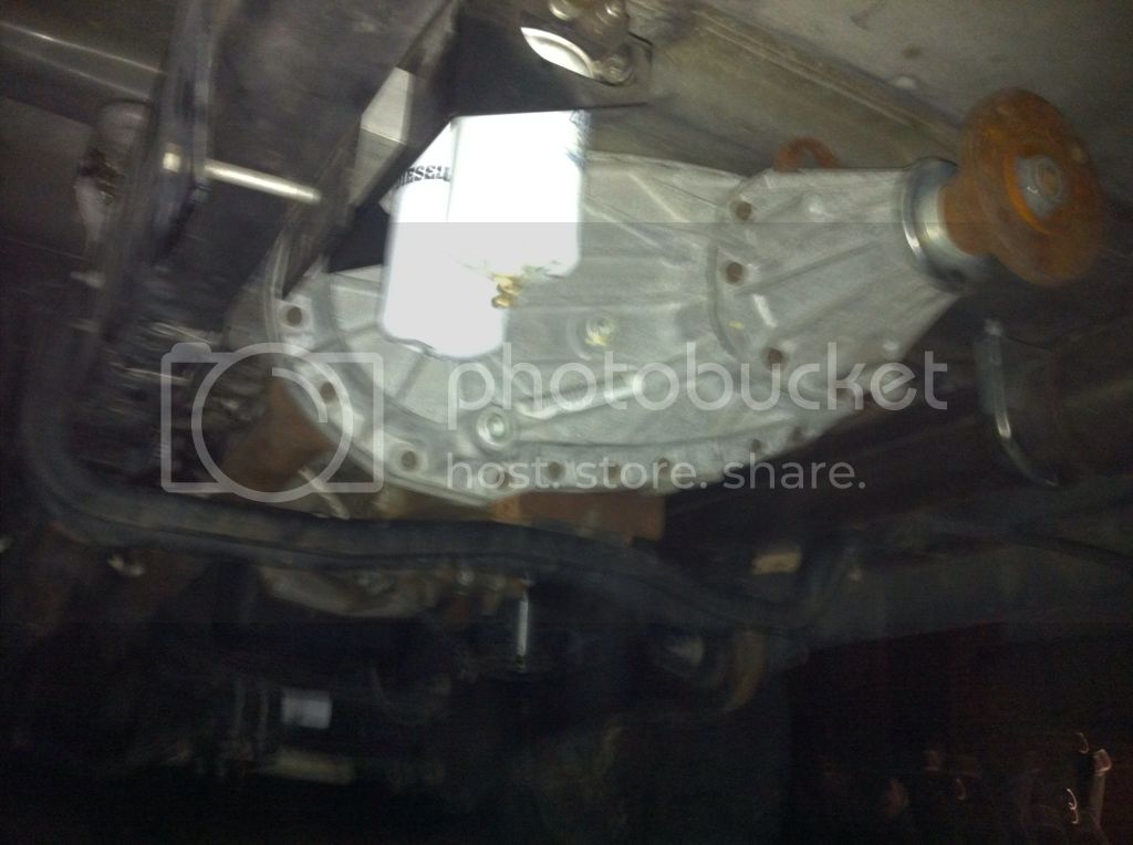

Transfer case is in, front drive shaft had enough flex to get bolted up, had to stretch it a bit so probably needs to be lengthened, rear drive shaft needs to be shortened, probably gonna measure the difference in lengths of transmissions and lengthen front drive shaft and shorten rear by the difference

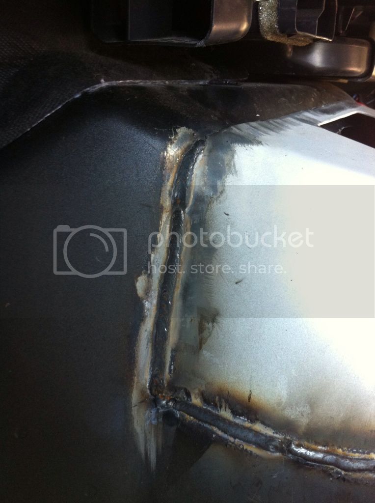

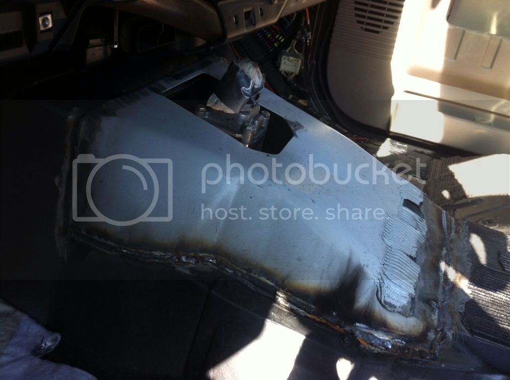

Floorboard is welded in, except for the top line, my buddy and I decided not to attempt it due to possibly melting dash pieces or nearby wiring, gonna rtv over the welds for peace of mind and figure somethin out for the top line, interior is going back together tomorrow and driveshafts are going to the driveline shop in town on Monday, depending on how long that takes should be at ford soon

Excellent job with the floorboard....I'm sure that couldn't have been easy. Well,almost there.

That dash panel comes off with just a couple screws too. Paint the welded section with a good primer/sealer then a good coat of paint. Then silicone it if you must. I'd seriously take the time to pull the panel and finish the weld all the way across. You've gone this far don't take a shortcut now. Good work though.

Don't be a pussy and install it yourself LOL I've done it a couple times and requires some break dancing moves
Haha I missed this post when reading over comments, I threw the best moves I had at it by myself lol I failed, with two more sets of hands it took less than 2 minutes
Thanks for the advice bud. Any specific primer/paint/rtv brand I should use in your opinion? Ill see what I can do to get the top line welded in.
