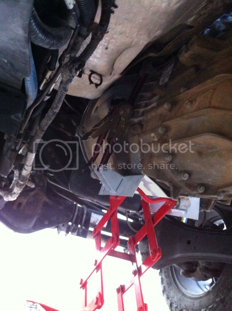

brooksfruge
Jul 28, 2011
179
Houston, TX
ran out of daylight before i could get the input shaft all the way in, but its close
