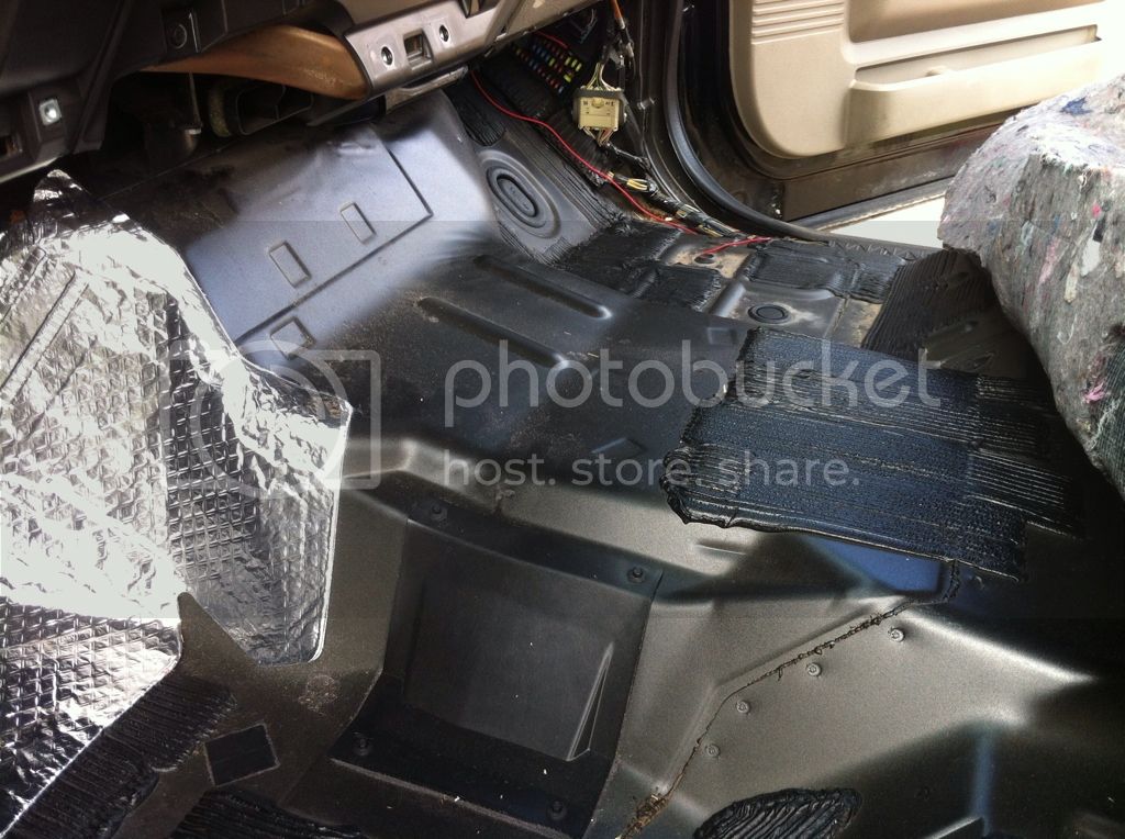

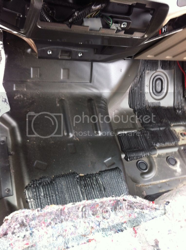

andddddd heres where things get sketchy, floor boards are alot different than i thought....not really sure how i should go about this...any suggestions boys?

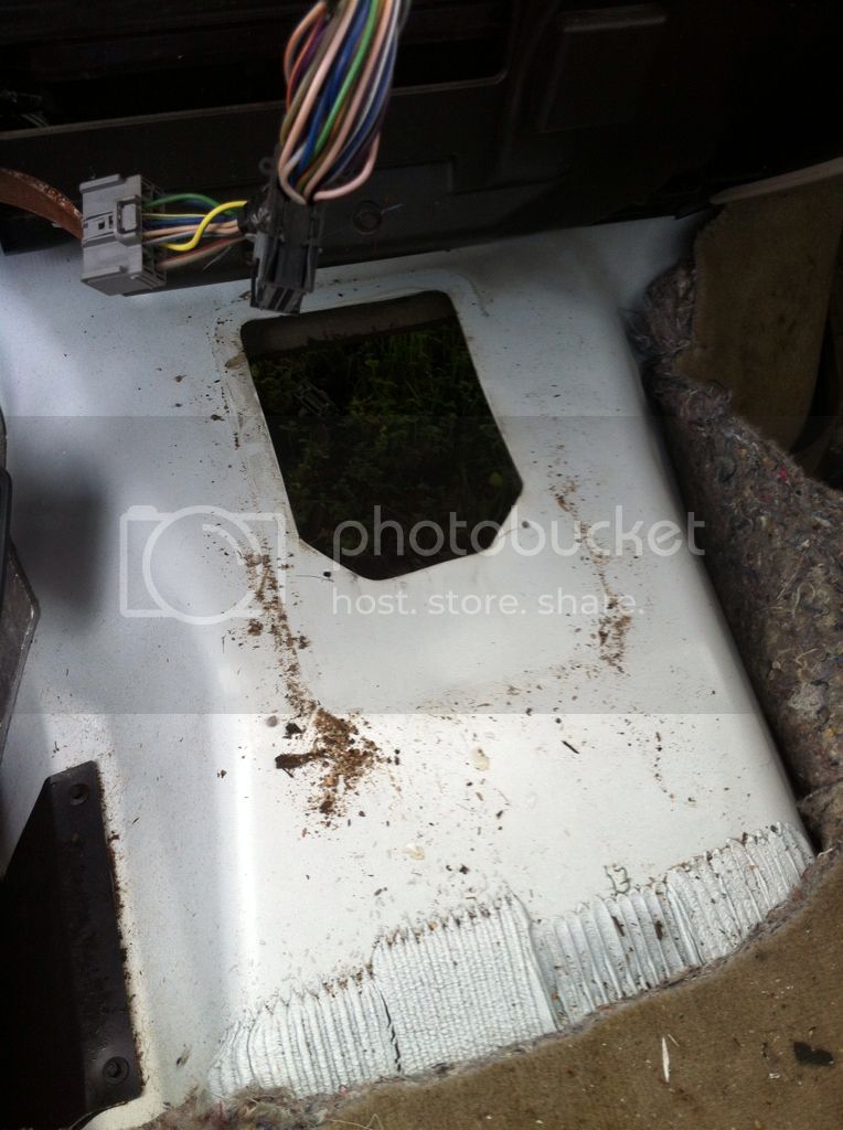

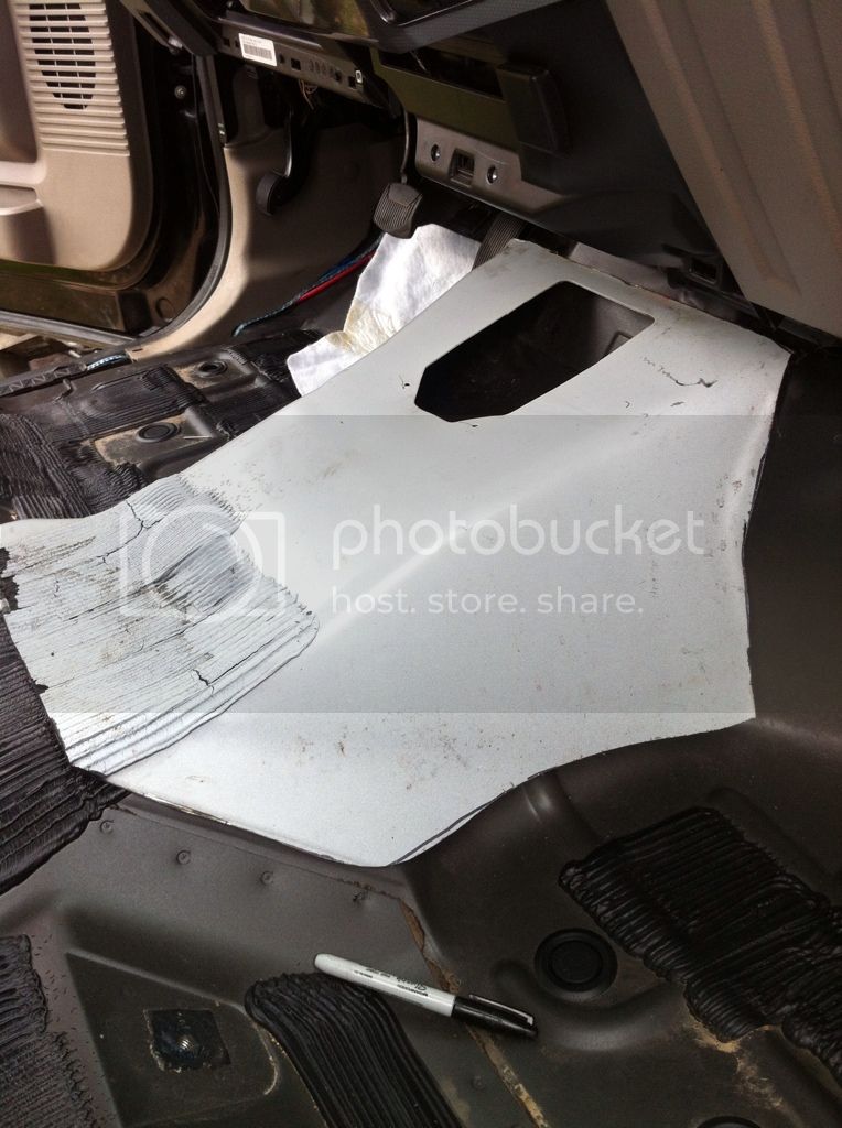

Looks like the floor is raised up to clear the trans.
yes the manual floor board is definitely higher to clear the bigger ZF6, only solution i can think of is to cut the floor board out of the manual with more than i need, and mock it up in my truck and cut a whole in my auto floor board leaving a 1in lip for the manual floor board, then use rtv sealant and self tapping screws to seal the manual floor board in my truck, either way its gonna suck :doh:

Cut the top of the tranny tunnel off the donor truck and match it to your truck to fit. Theres a thread on here of a guy who did it with 4r100 to zf6.

Cut, fit, tack it on, bolt the trans up, and weld it up once everything is fitted correctly. IMO.
Or use some very nice material and weld up something from scratch.

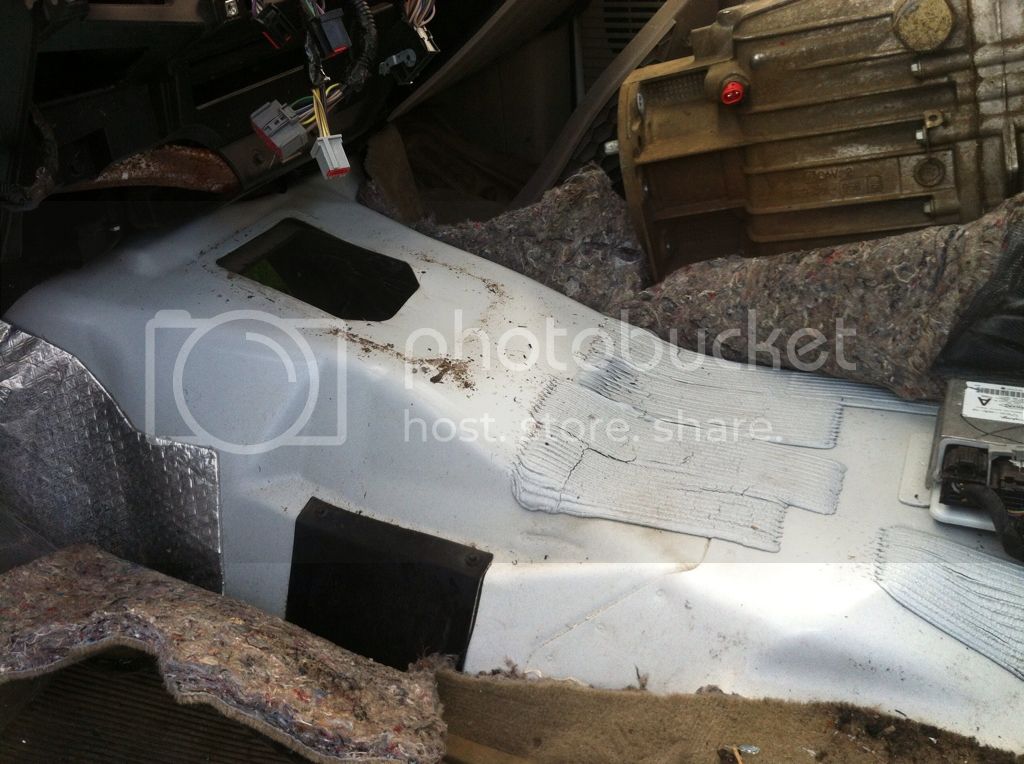

Mockin it up, floorboard modification is last thing to do before driveline goes together, I can finally see the light at the end of the tunnel!
