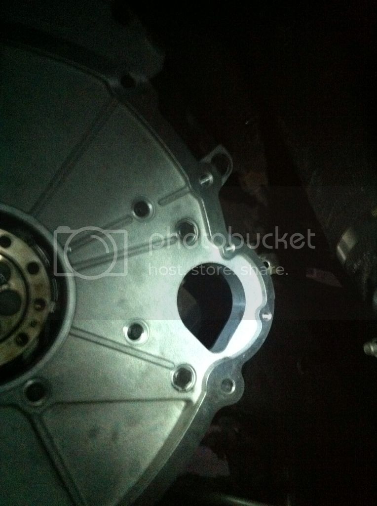

Manual rear cover installed

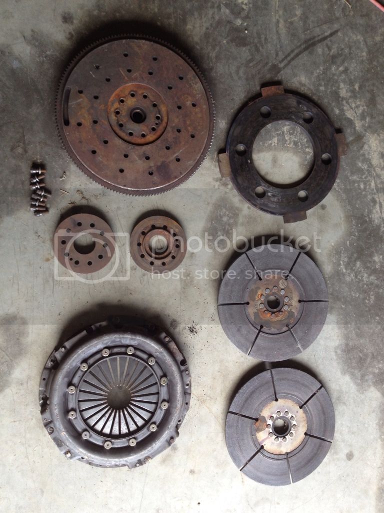

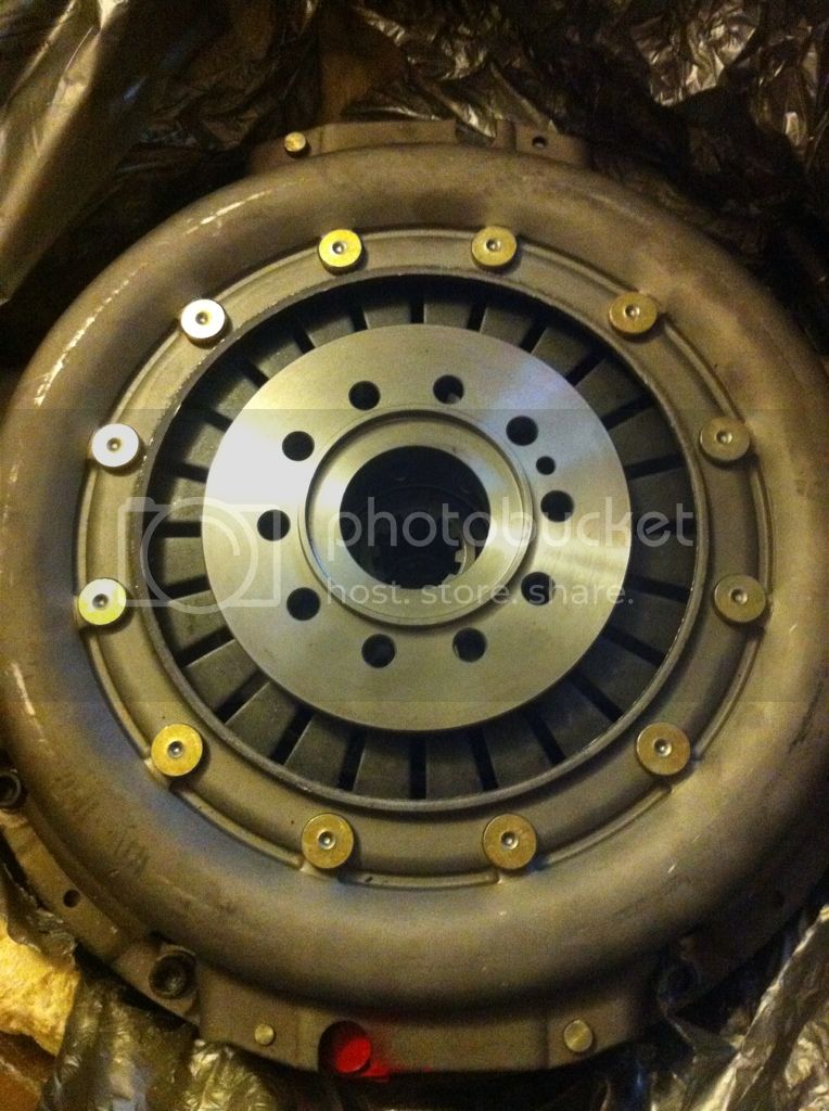

Sent the used sintered iron 3600 dual disc I bought to southbend to get remade into a ceramic button, just got it back!
This is what it looked like before....

Wow, they did a h#ll of a job on that.

Do you have any pics of your new friction discs?
Also, which release bearing and lever are you using?
They sent the clutch assembled as one piece, I just left town for work this weekend but when I disassemble the clutch to install it on the truck ill take pics, southbend sent me a throw out bearing to use and the stock lever will be used I believe
