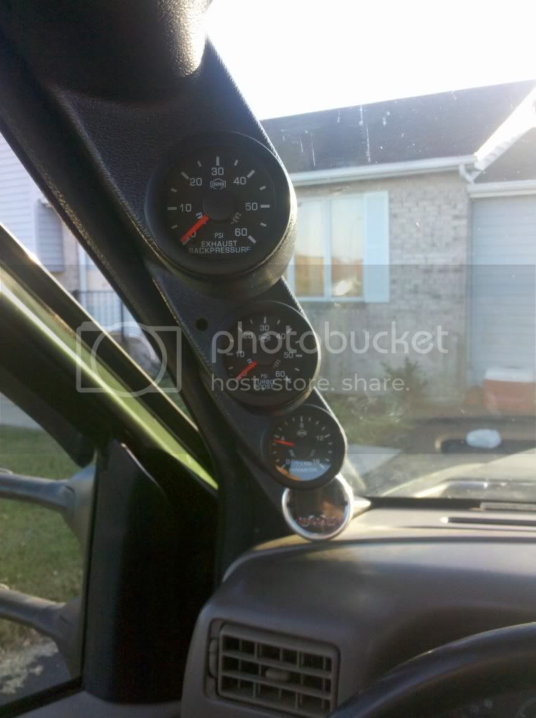

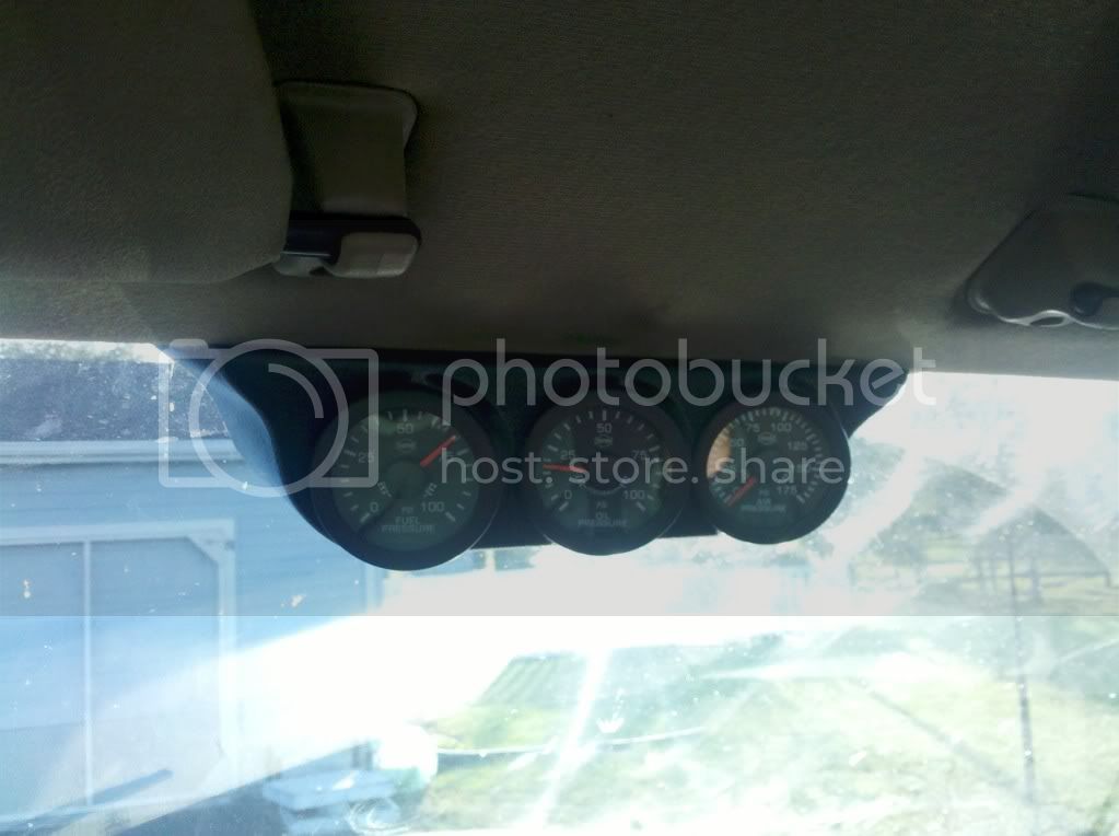

Some pics. Truck is still dirty but I was able to snap a few.

As for driving it. It is very responsive and turbo lights around 2000-2100 rpms. In my daily tune I see about 25-28# boost and around 22 backpressure. In my lowest hot tune I am seeing 48# boost and about 43# backpressure. I dont even believe that the wastegate is needed or has opened yet with this set-up. I have not ran any of the higher tunes as I am still trying to break in the clutch. I only have about 350 miles on her so far. One thing is for sure though, the 4.88's in the rear will be coming out and getting replaced with some 4.10. When I get into it I am speed shifting like a race car with how fast this thing lights off.
Cruising down the highway at 65 mph, 2100 rpm, I had bout 3# boost and egt's were 650ish.
