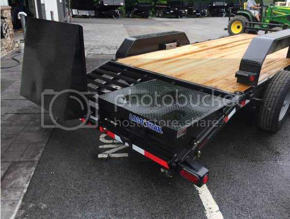

To start, I am liking the dual function ramps that fold back over flush with the deck, as seen here .
Seems pretty slick to me, concerned about not having enough length to make a nice approach angle though. Wont have the car at the trailer place to test it out :(.

you will never ever get the car over that angle with those ramps.

that trailer in the picture would get the job done, though I prefer the steel deck over the wood deck. A simple dove tail trailer will get the job done and pretty much anything that isn't slammed will clear fine. If a corvette can clear so can a nova.

i guess we can agree to disagree. How long are your ramps plus beavertail that the corvette clears? deck height?

That dovetail looks awfully short (I think mine is a 3'), and those ramps are super short. My pullout ramps are 5' long and when I load my lowered (not slammed) SS, I have to run 2x8's under the ramps to flatten that out. I can load it without the 2x8's, but it smashes the lower air dam until the front wheels hit the ramps.

Maybe it's just my perception of the picture. That dove tail looks fairly low, but again that is just my perception.
Mine is about the same as fasst9602's it sounds like but slightly lower deck height as I haven't had to use something as large as a 4x8, maybe a 2x4.

Car is a lowered 64, its not slammed but its fairly low. Those ramps are no doubt shorter than the average setup, it was a concern of mine to begin with. May have to do a different setup, tilts are expensive..

I use 2x8's. More surface area for the ramp to sit on, otherwise they tend to rock a bit on 2x4's.

You've got a 6' ramp with that set up, top of deck will be 24-26". W 5000lb axles. Should be able to figure out clearance issues w that.
