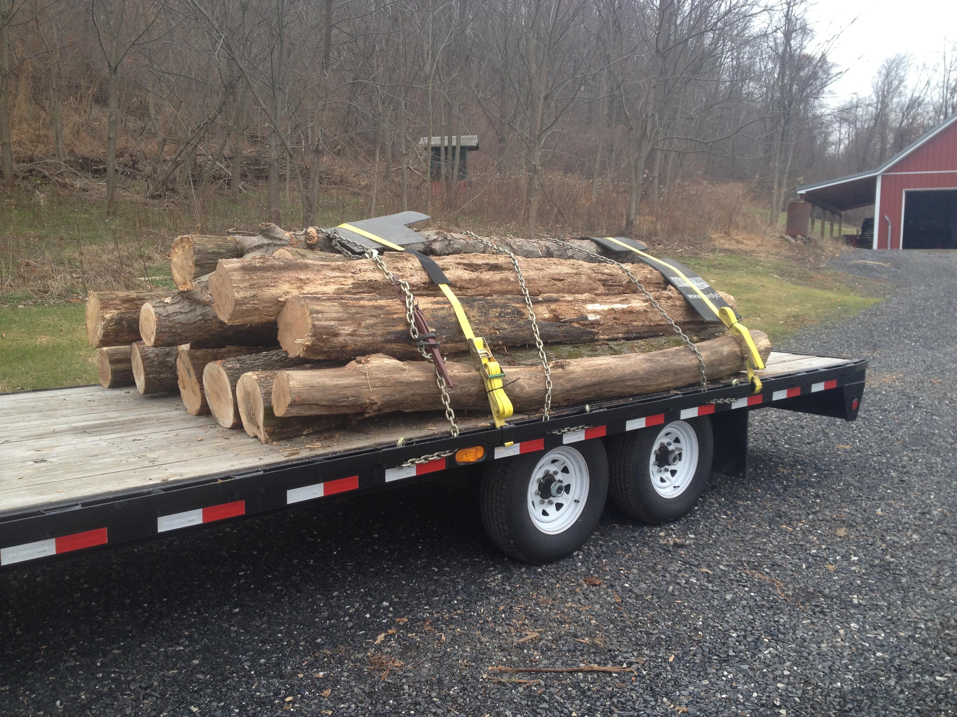

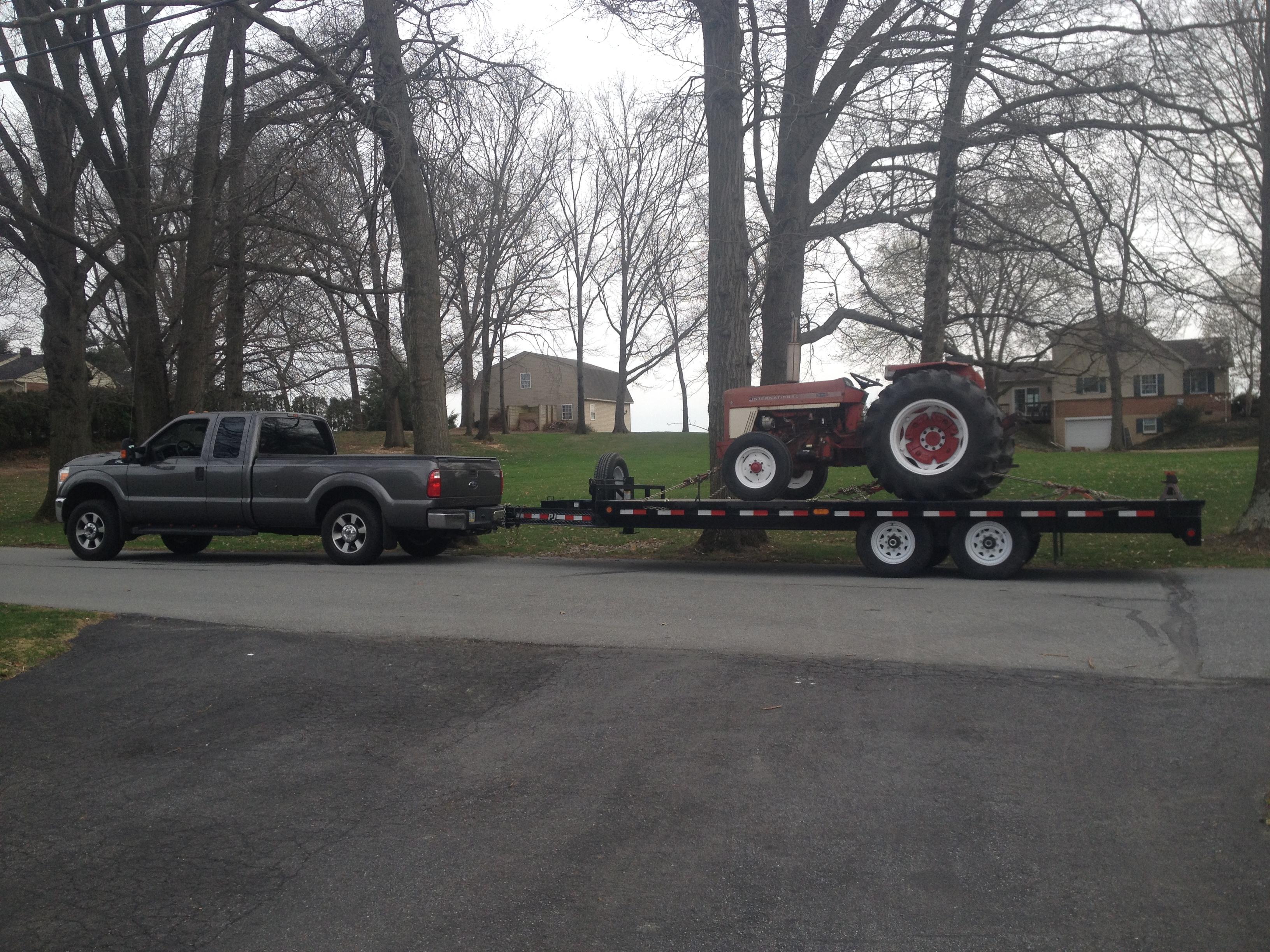

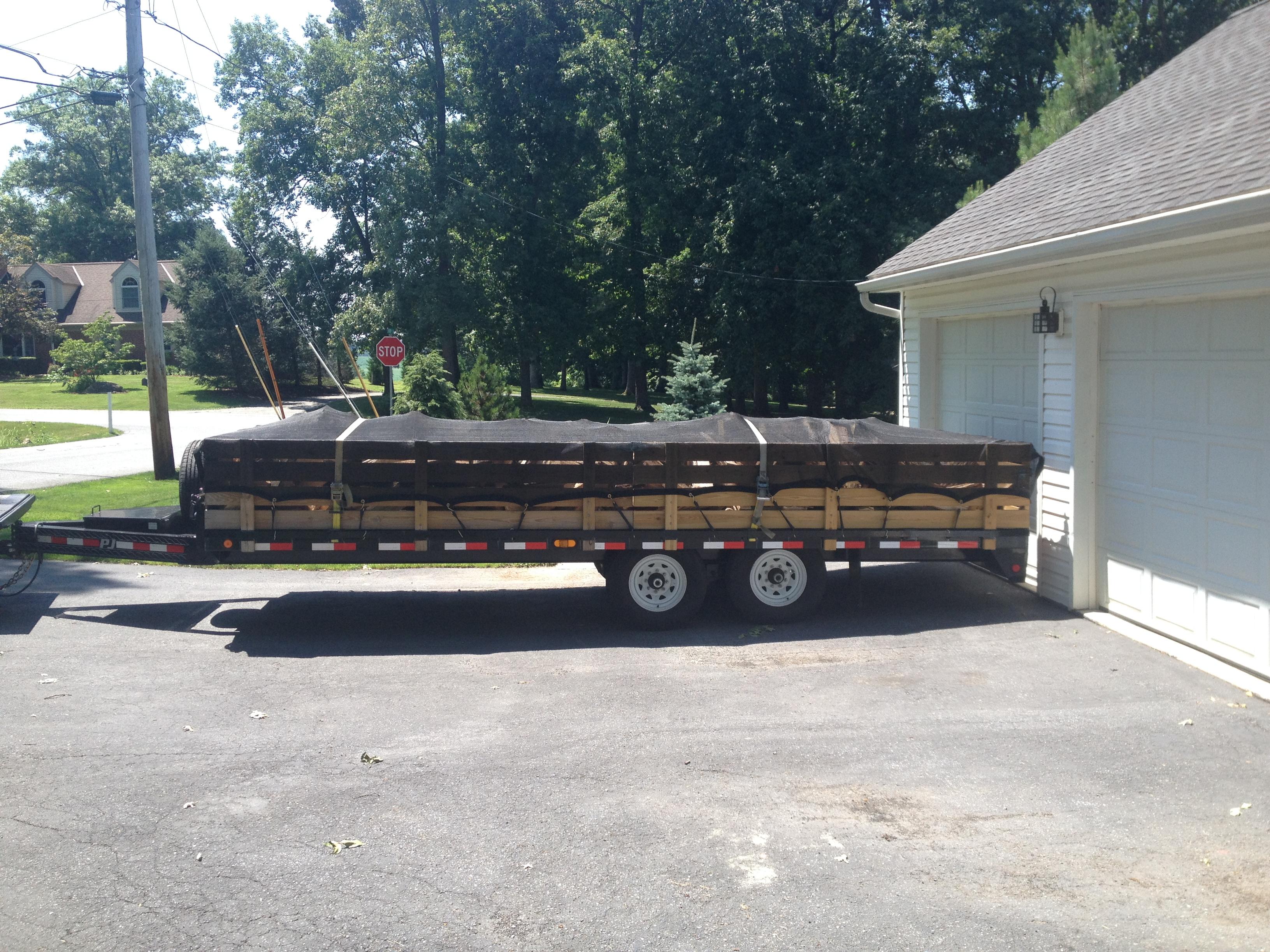

I have a 2012 PJ. I have been happy with my PJ. It was a little more expensive but, it is built very well. It has 7K axles and I have it registered at 9990. I am thinking about trading it for a tilt deck 2' longer sometime soon. Here are a few pictures.
