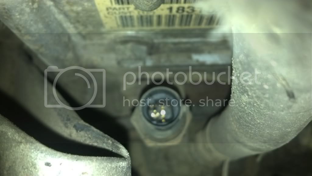

A 6.4 sensor will read 80 psi off that helps...

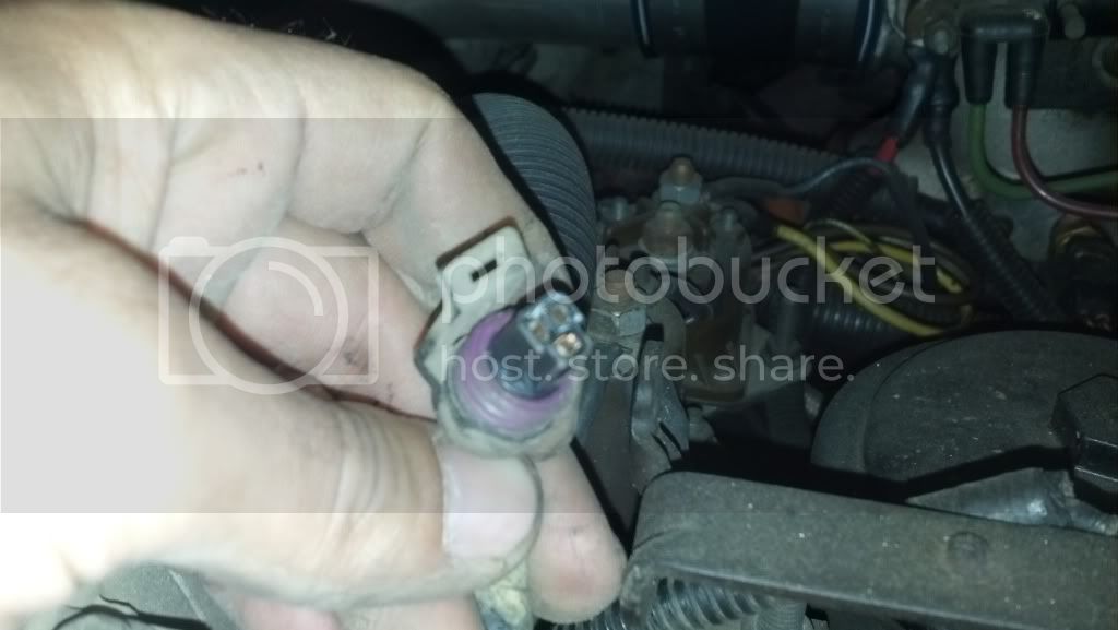

Yes. I don't know what kind of connector you guys have but the 6.4 uses this style...
