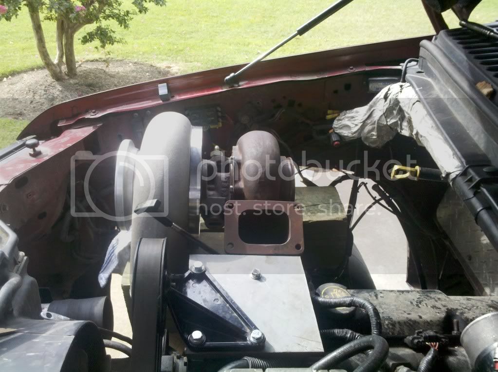

Here's a pic of the bracket during mock-up
