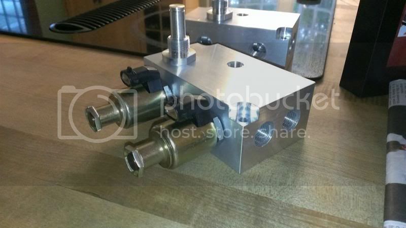

I assume the dual IPR setup is the same as the BTS style if it is you put them in series mine comes from OEM harness to IPR 1 then from IPR 1 to IPR 2 then out of 2 back to OEM.

I can let you know this week. Hopefully sooner than later my truck hasn't run in way to long. Me and Kevin are picking up a second Bridgeport mill this week so hopefully as soon as we get that going we can pump one or two out. The other one we bought is apart at the moment getting redone.

driveability. The single ipr is overwhelmed by the gen 3 and the fact that it returns back to the hpop reservoir
