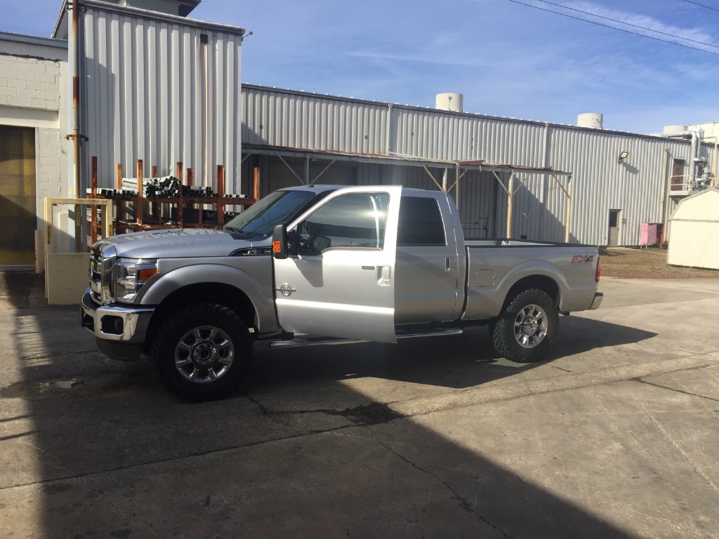

Not the greatest pics but here's mine. Carli leveling kit with 4" rear blocks, 1/2" PMF coil spring spacers, Carli Fox 2.0s, 295/65/20 Toyo AT2s and 20x10 Fuel Mavericks with -12mm offset.
I'm thinking real hard about selling the AT2/Maverick combo and going back to my stock Platinum wheels with 37/12.50s.

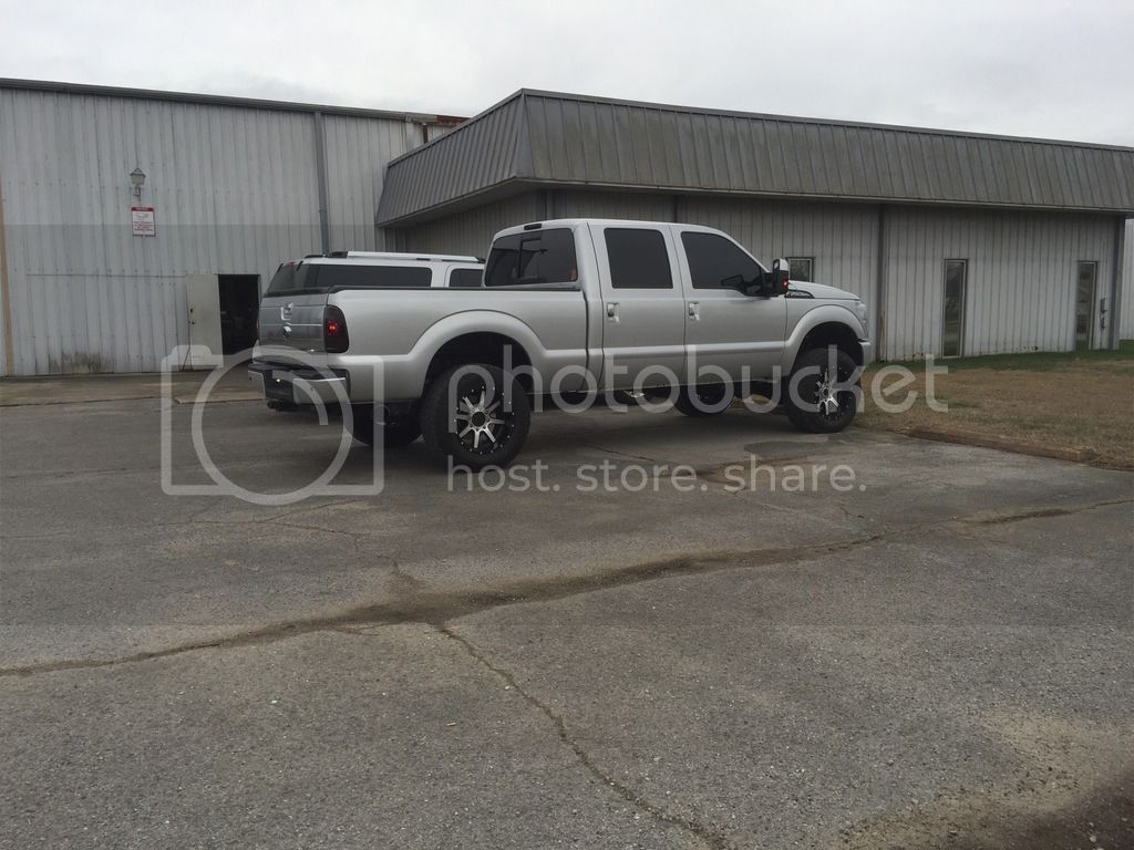

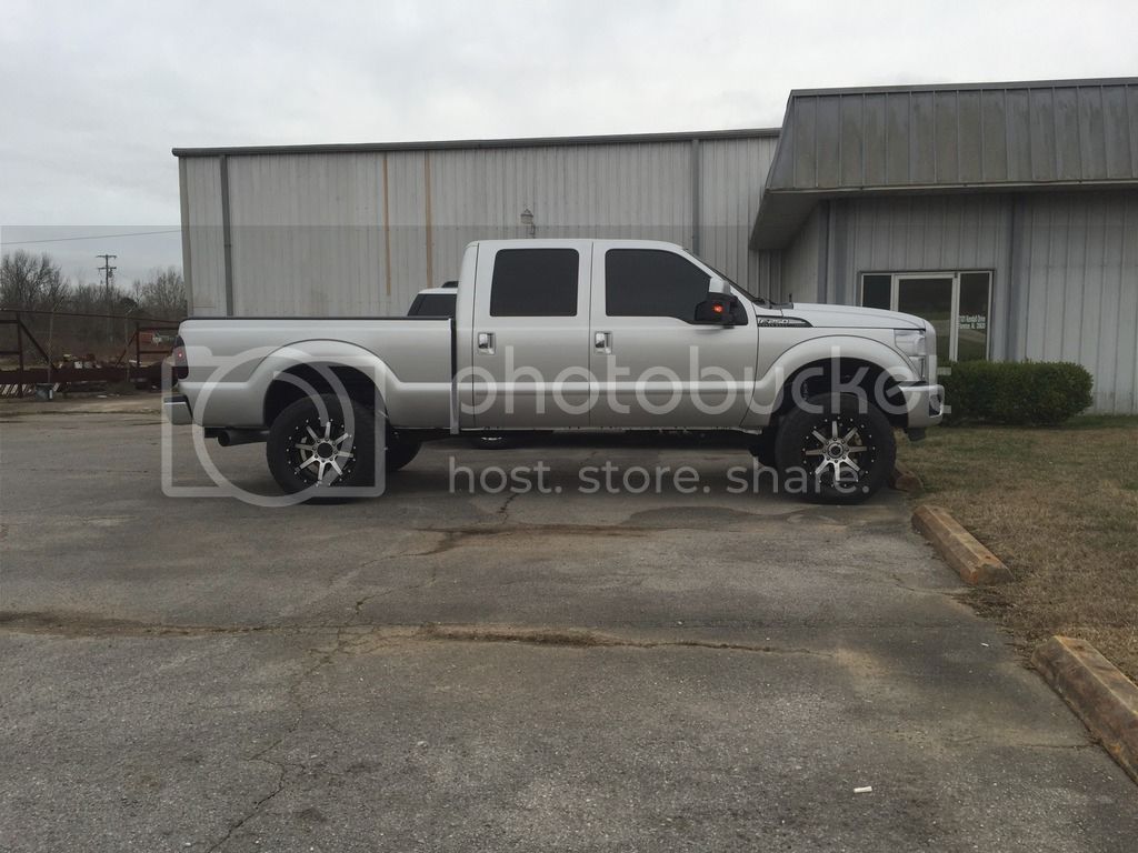

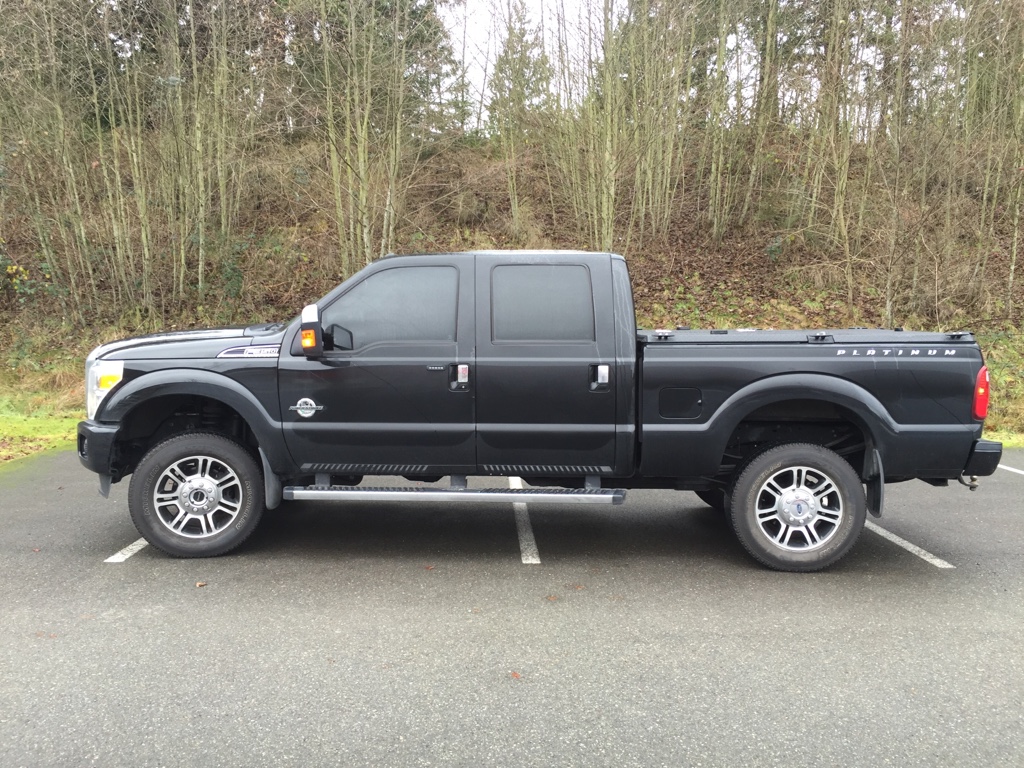

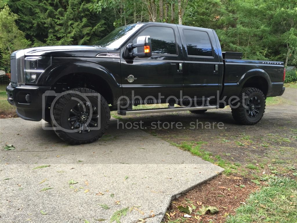

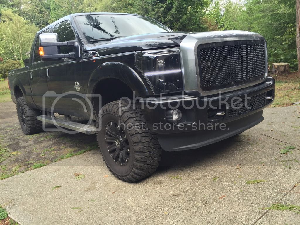

Before and after photos of my 2014 F350 Platinum. Before shot already has the ProComp level kit. 2.5 up front with track bar drop, rear is a 1" lift. The new wheels are 20" Fuel Lethal on 35x12.5 Toyo MT's.
