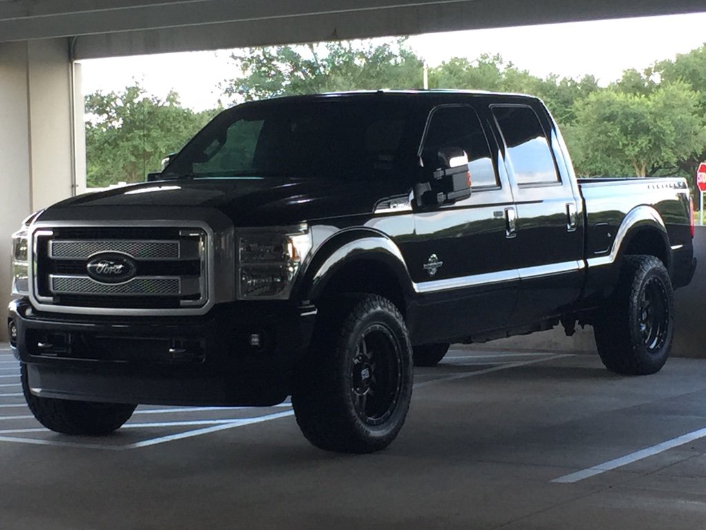

mine with 1.5" spacer. I want to swap to 350 blocks in the rear to get a little rake back because it drags when I put a load on it.
Carli 2.5 inch Pintop, Yokohama 37's, fuel 18x9 +20.[/QUOTE]
Now THAT'S a lot of tire! Looks good, any rub?
Damn that looks really good. Are you level now or little high in the front?
