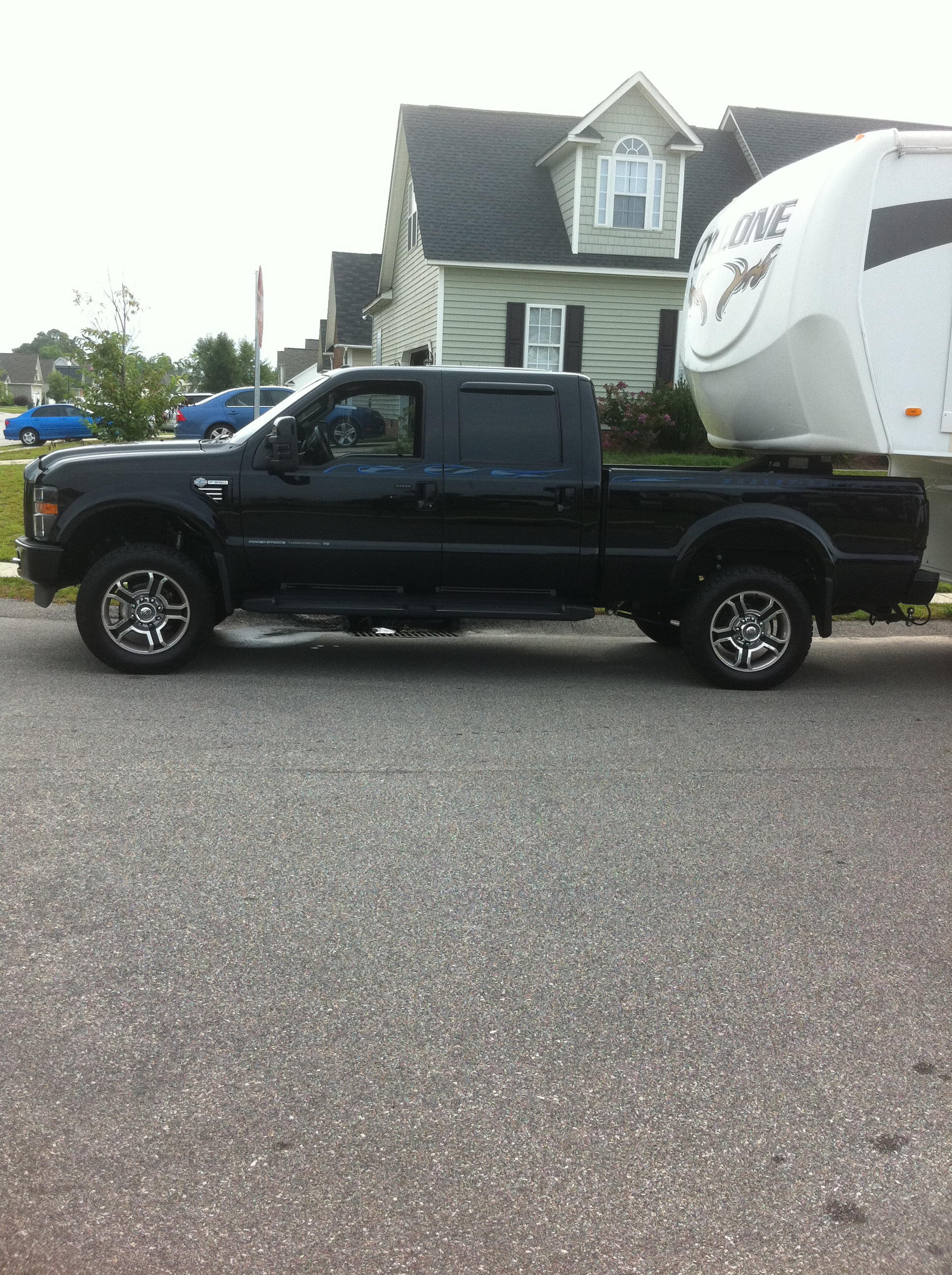

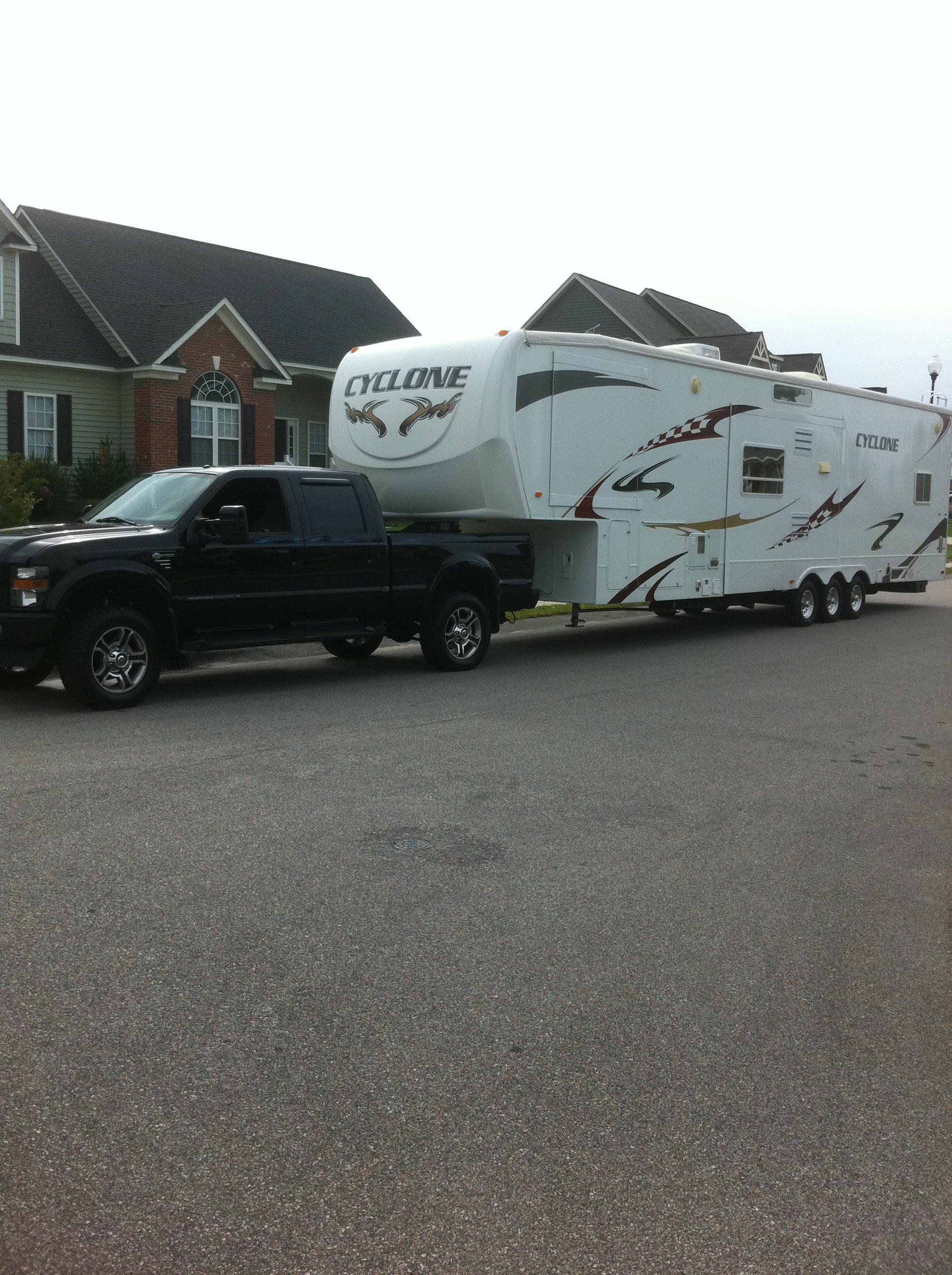

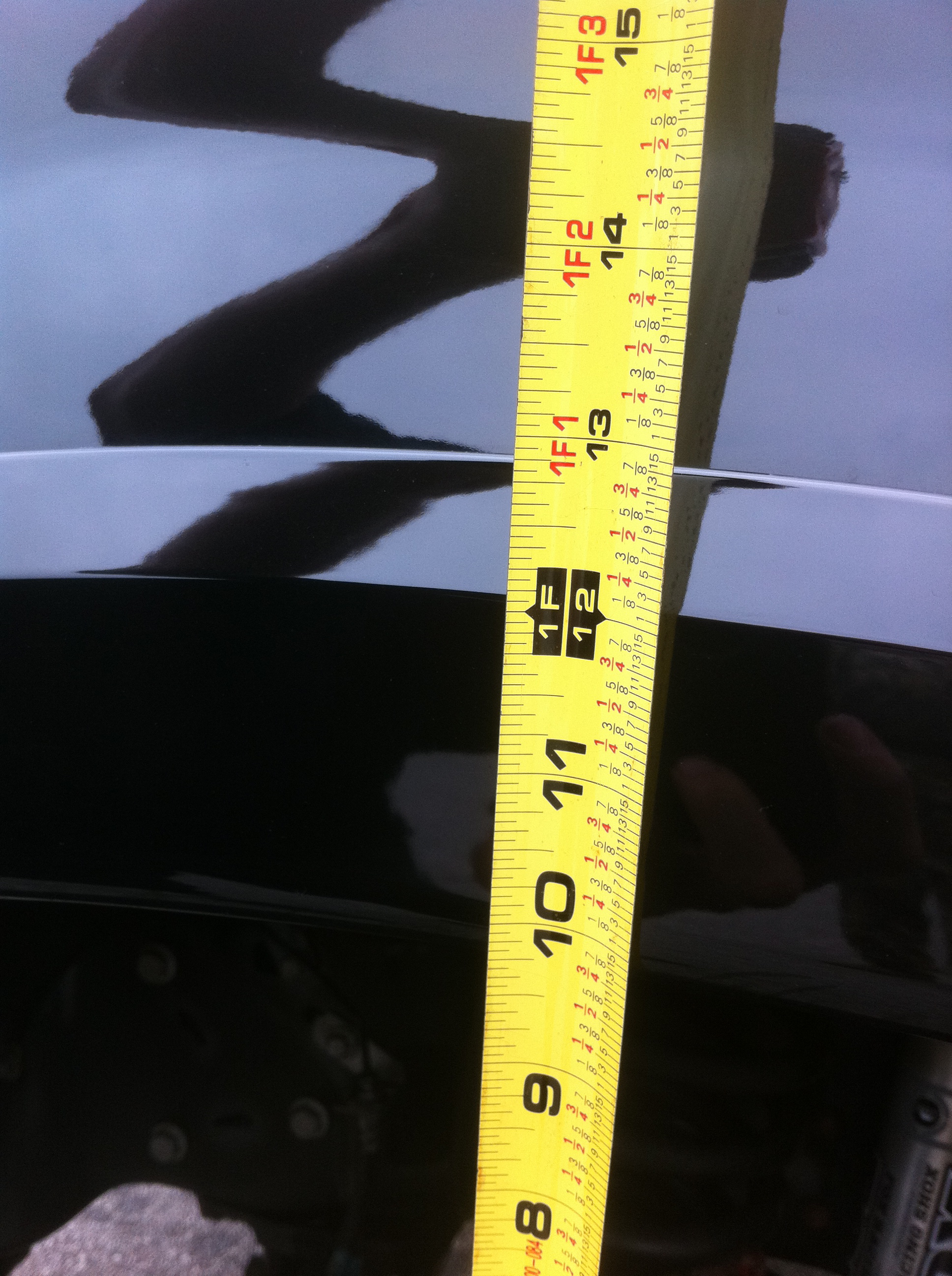

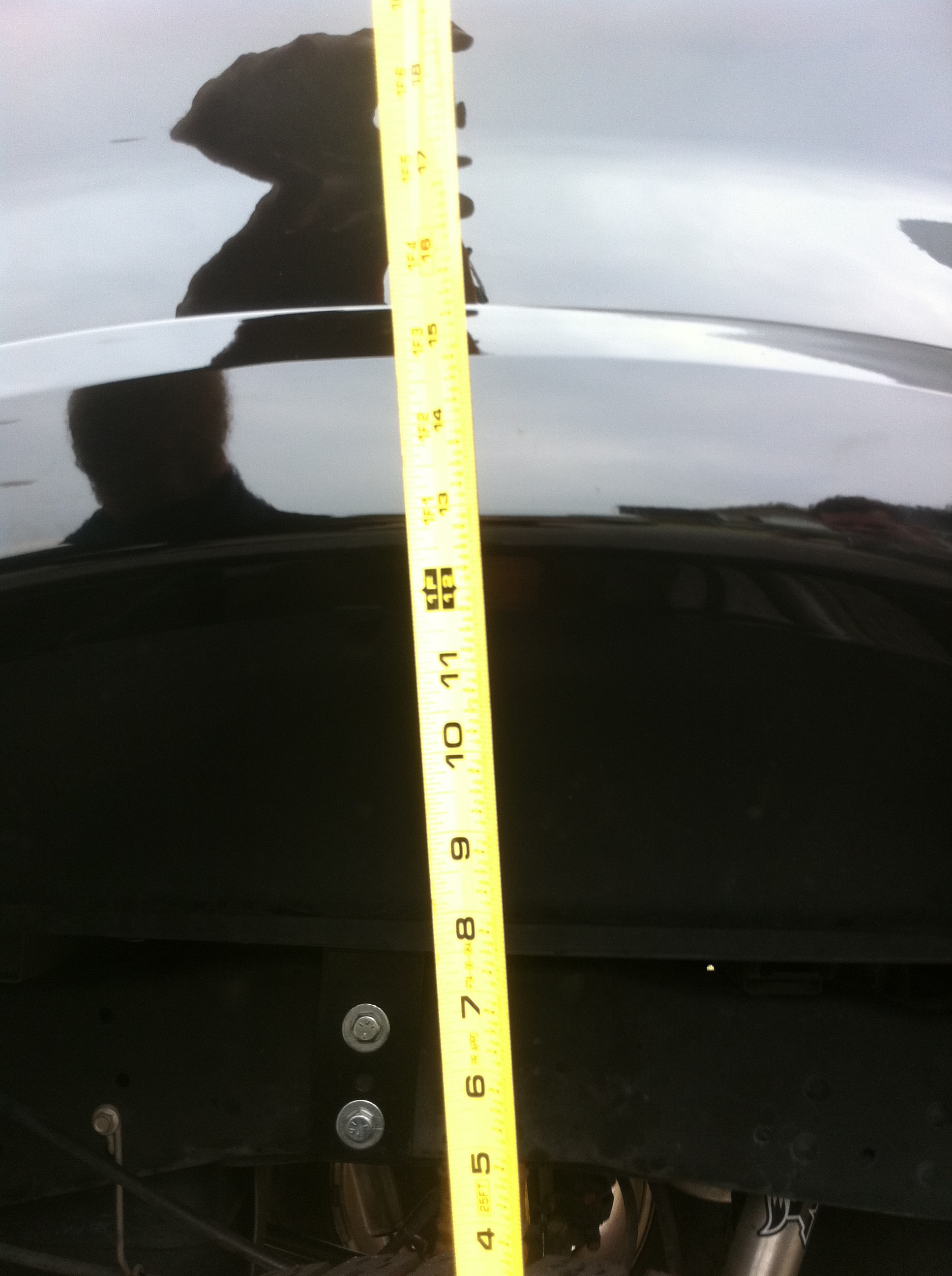

this thing works, look at my pics. this supposedly adds 2500 pounds to your rig. what ever. but, it def helps carry some load. also, when not loaded down, it puts negative tension to your springs. so, when you slam on the brakes, you keep level, no more nose diving! also helps in the curves. not quite as good as a sway bar, but there is a noticeable difference in sway control.
pic # 1 is loaded, 16,600 pounds.
pic # 2 is same, just closer view, showing little to no sagging in the rear.
pic # 3 is rear, unloaded, tire to fender 12 3/4 inches
pic # 4 is front, tire to fender 12 inches

also, due to me having a short bed truck, i needed a hitch that wouldnt crash my cab.
Pullrite 18K SuperGlide 5th Wheel Towing Hitch PR-4400
this thing is FULLY AUTOMATIC ! no sliders, no rails to adjust, etc. it is not cheap though.....
