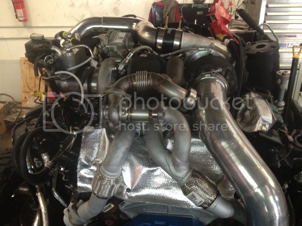

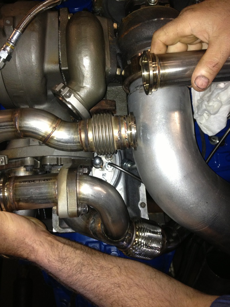

Now running in to the wastegate piping not working!
Going to extend the piece that connects to the up pipe and see how that works
Dzchey21
11,784
wyoming
Can't you just clock that different?
Just lay a little of that heat matting over the high pressure fuel pump Lines and all.

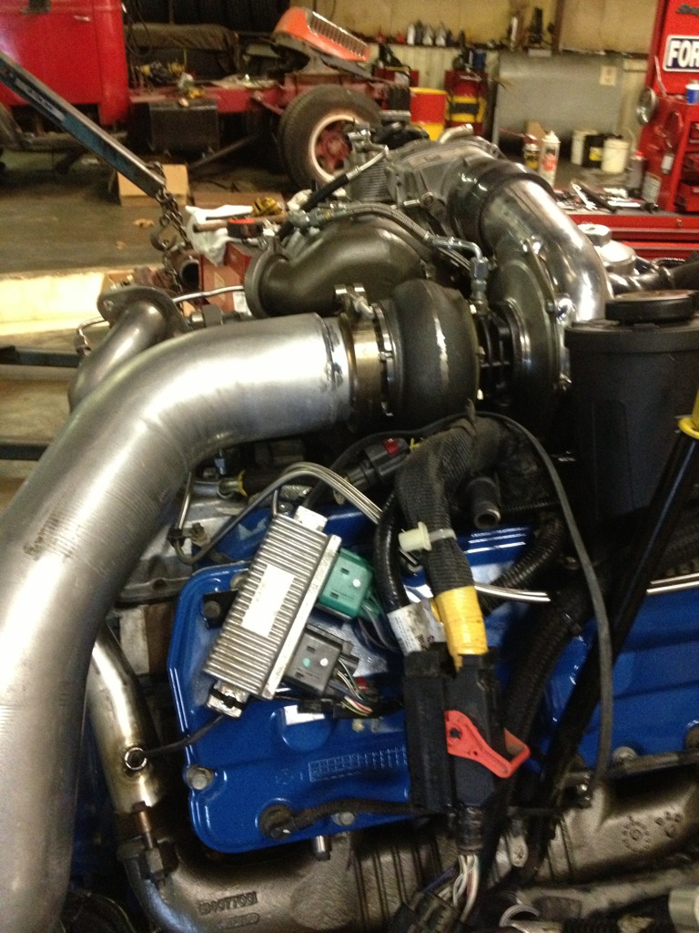

Got it running and took it for a drive. Came back finished hooking up wastegate. Power washed engine and underneath of truck. And retuned while I was washing. Now wont start and I pulled a p0232 code, secondary fuel pump circuit high. Did a little searching and didn't find much. Anybody have experience with this code and what I need to do? Figure I've got water in a connector somewhere

possibly lpfp , or something in filter , do you have an airdog? or the stock lpfp?
webb06
Aug 14, 2012
3,892
12
Seneca, MO
Key on source for airdog needed to be hooked up to the purple wire with white tracer that supplies power to the factory lift pump
