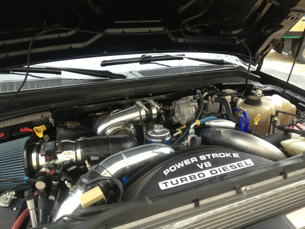

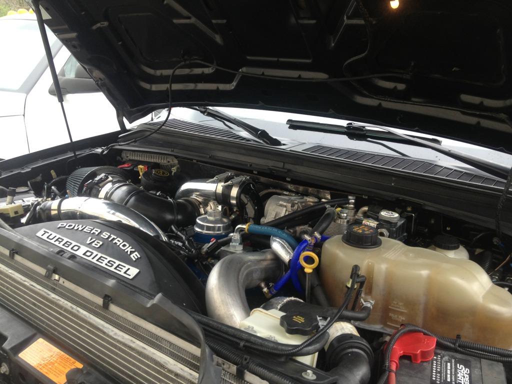

Looks good. I'm thinking I might do a 45 off the second pump now looking at it. I bout 90* fittings but looks like the 45* will work better.
I wouldn't recommend a 90*. Cuz it's gotta come straight up with the limited room there

I like the 45* fitting better then the stright fittings that I did on mine. That looks really clean and fits very well in there with the 45's

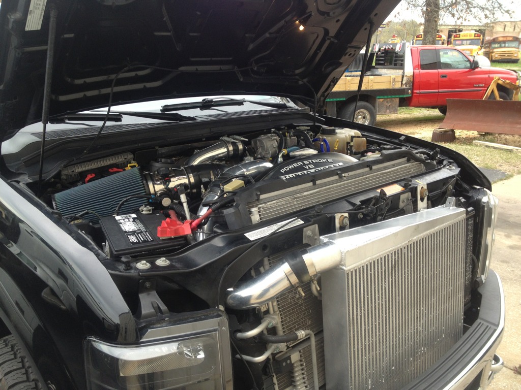

Looks good man. Congrats on getting her all together. I would love to see a big tune and some lead foot action!!!!

Looks like you need a longer boot or one of those modular plates mike makes now...(not knocking ur build, cuz everything looks good). Just wondering why the IC outlet fit isn't the greatest....otherwise good job.
I need something because it sucked putting it back on. Idk what the fix is.
