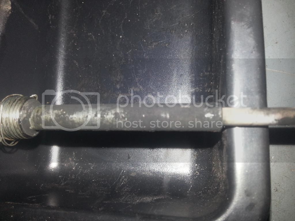

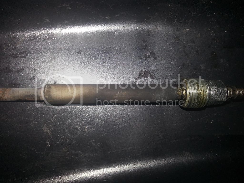

Who haz seen this before
DEEZUZ
NO PUKESTERS
Jun 30, 2011
6,929
220
NWI
And what caused it exactly and what symptoms did you have
DEEZUZ
NO PUKESTERS
Jun 30, 2011
6,929
220
NWI
Its a factory plug that was reinstalled into new heads. Had about 1000 miles on it.
Yes that is soot all over it
DEEZUZ
NO PUKESTERS
Jun 30, 2011
6,929
220
NWI
Yup. I had to use vice grips to get them out. The truck starts like **** and Grey smokes likes all hell. Has a fuel knock on a few cylinder. We removed injectors tested them, perfect. Went to do compression test and couldn't even get these out of the head. Yes they were torqued upon install
DEEZUZ
NO PUKESTERS
Jun 30, 2011
6,929
220
NWI
This is #7. It had a positive balance on graph and a fuel knock that went away when injector was disabled. I replaced injector and same thing in a few miles.
