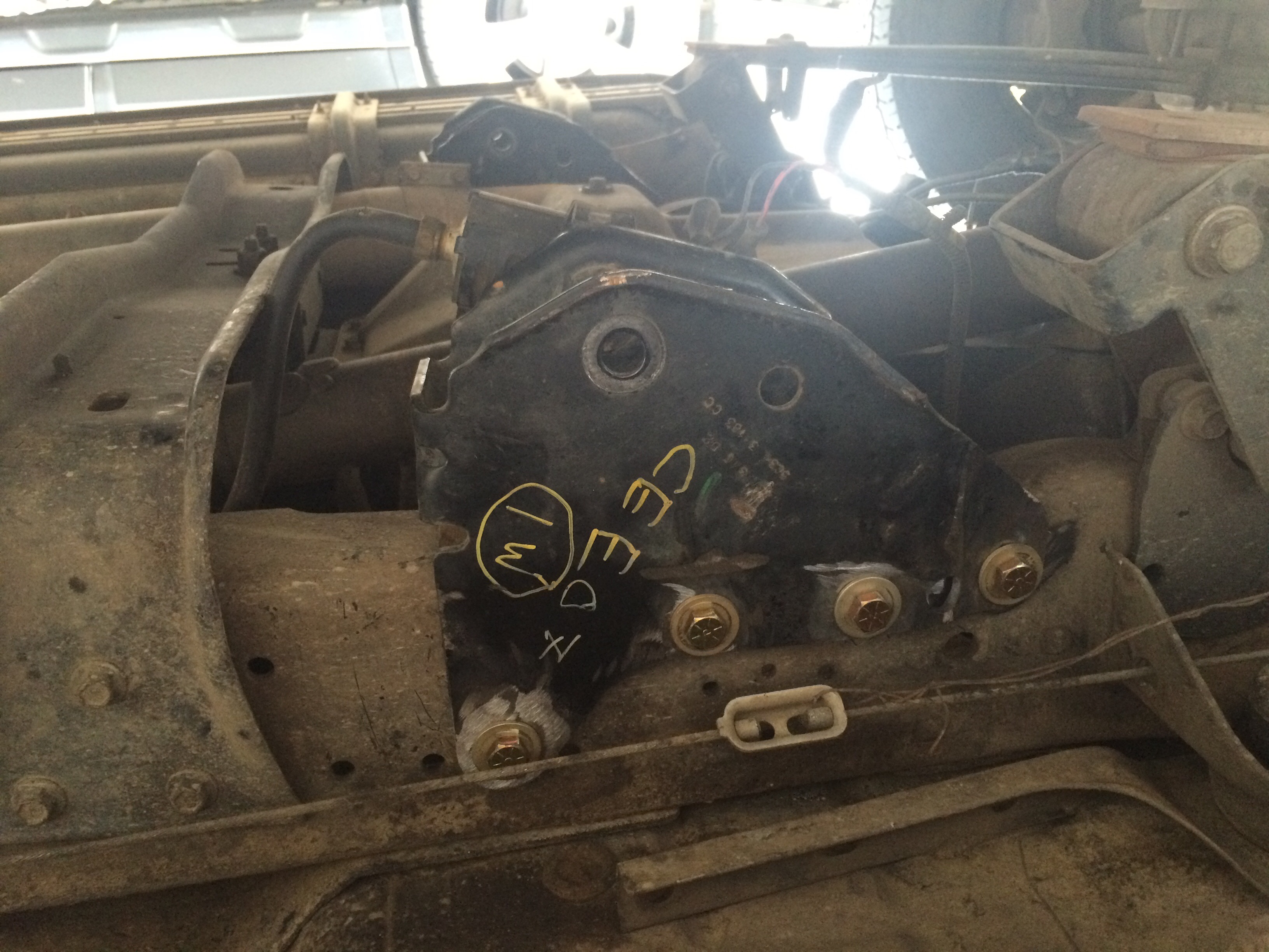

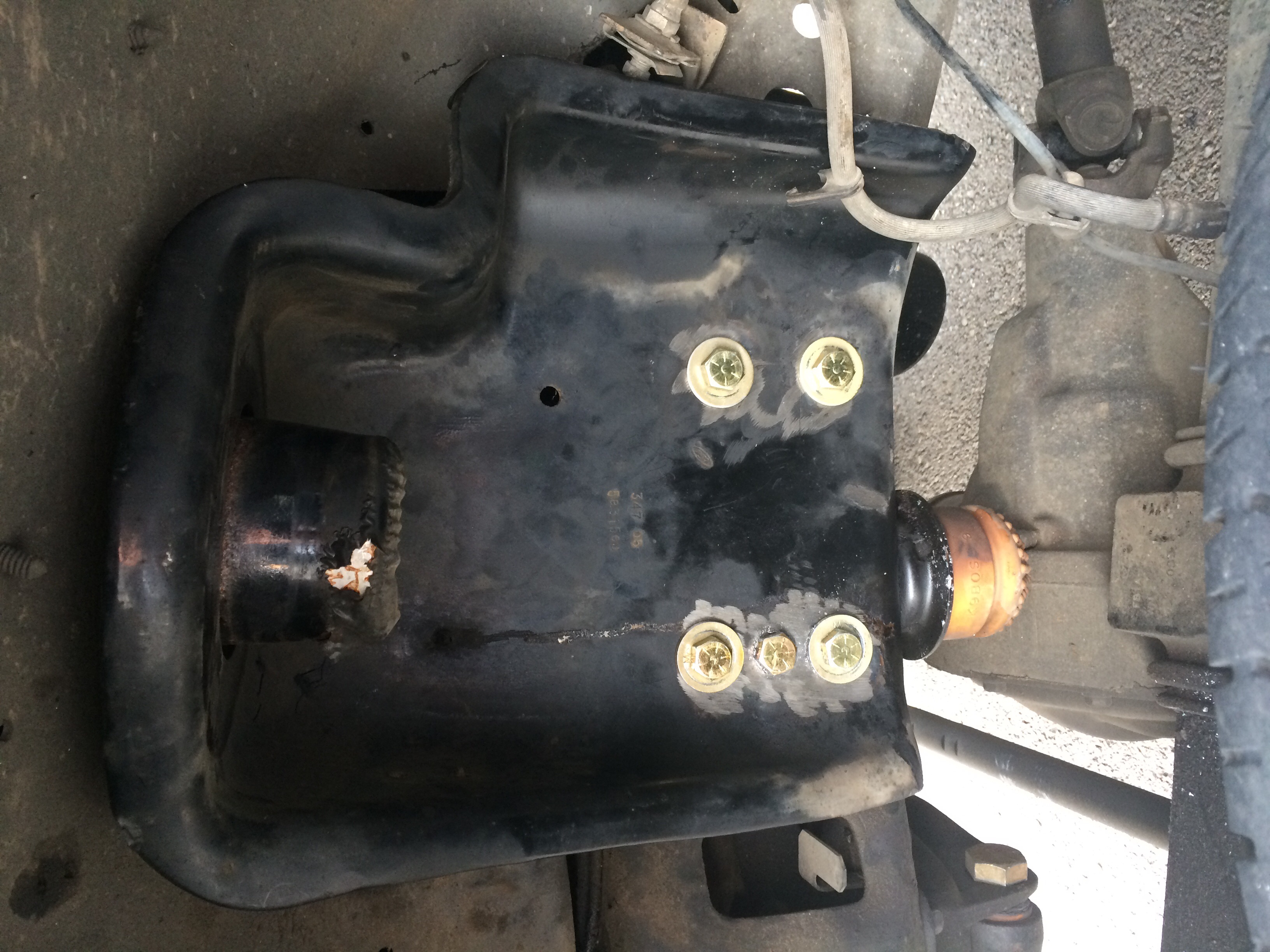

Some progress on the swap, only had to drill 2 holes on the driver side radius arm bracket and 1 hole on the passenger side. The coil buckets, resized 5 holes on each side and drilled 2 holes on the driver side and 1 on the passenger side just for your info

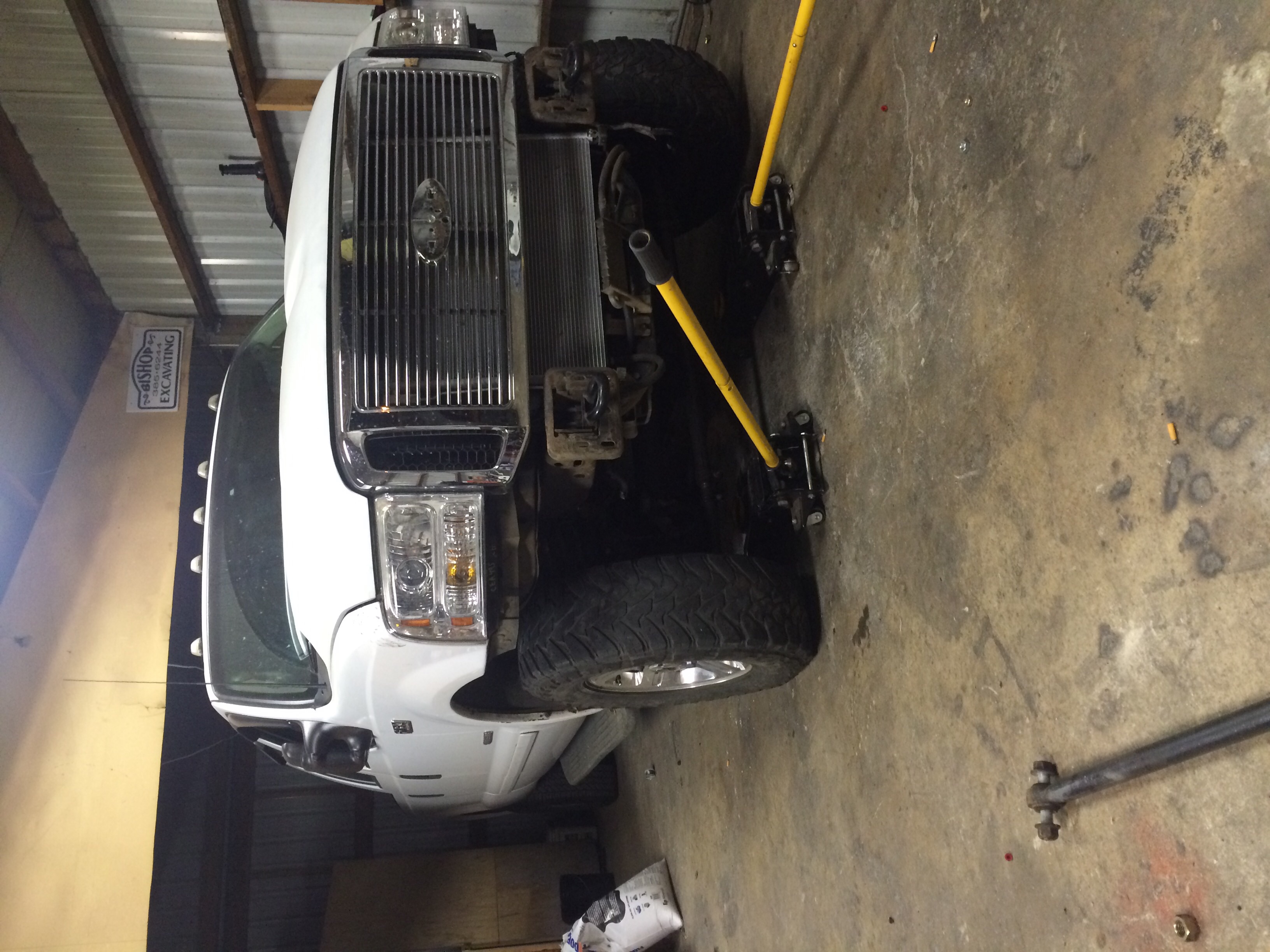

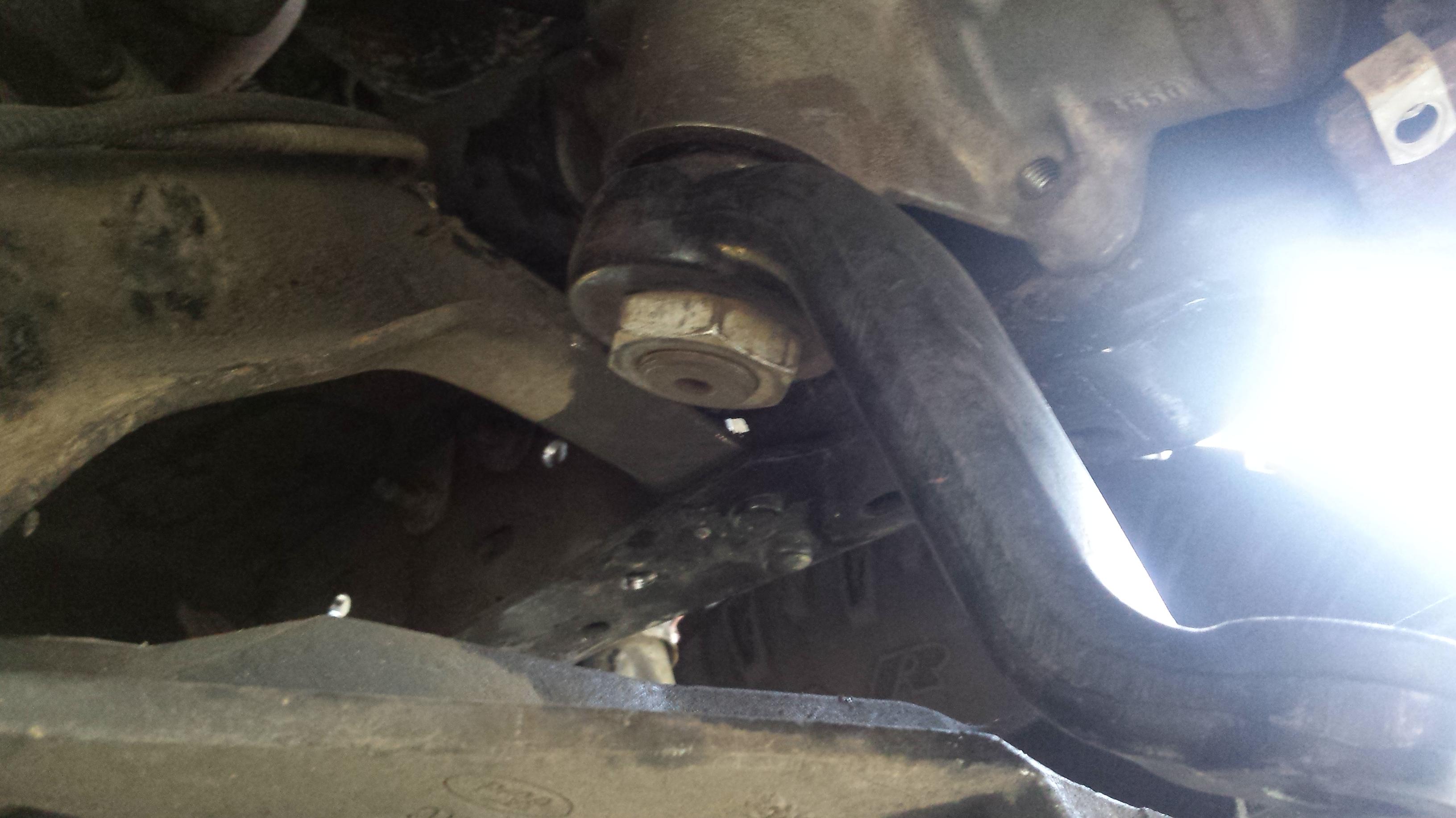

Have all the parts I need to do the swap. I have a 7.5" lift to go with it. I began this weekend and ran into a hiccup. I put the 05 steering box in, but when I put the track bar bracket in, the pitman arm has only about half an inch of clearance. It's a 3.5" drop bracke and a 6" pitman drop. Does anyone have an idea as to what the problem could be?

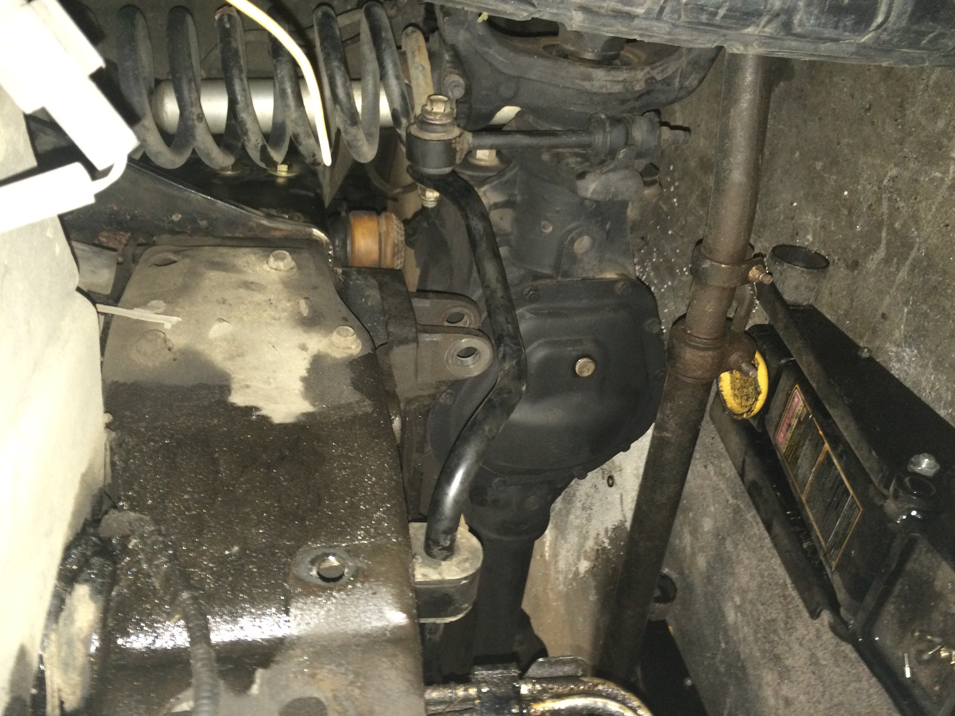

Waiting on the pitman arm but it's sitting under its own weight

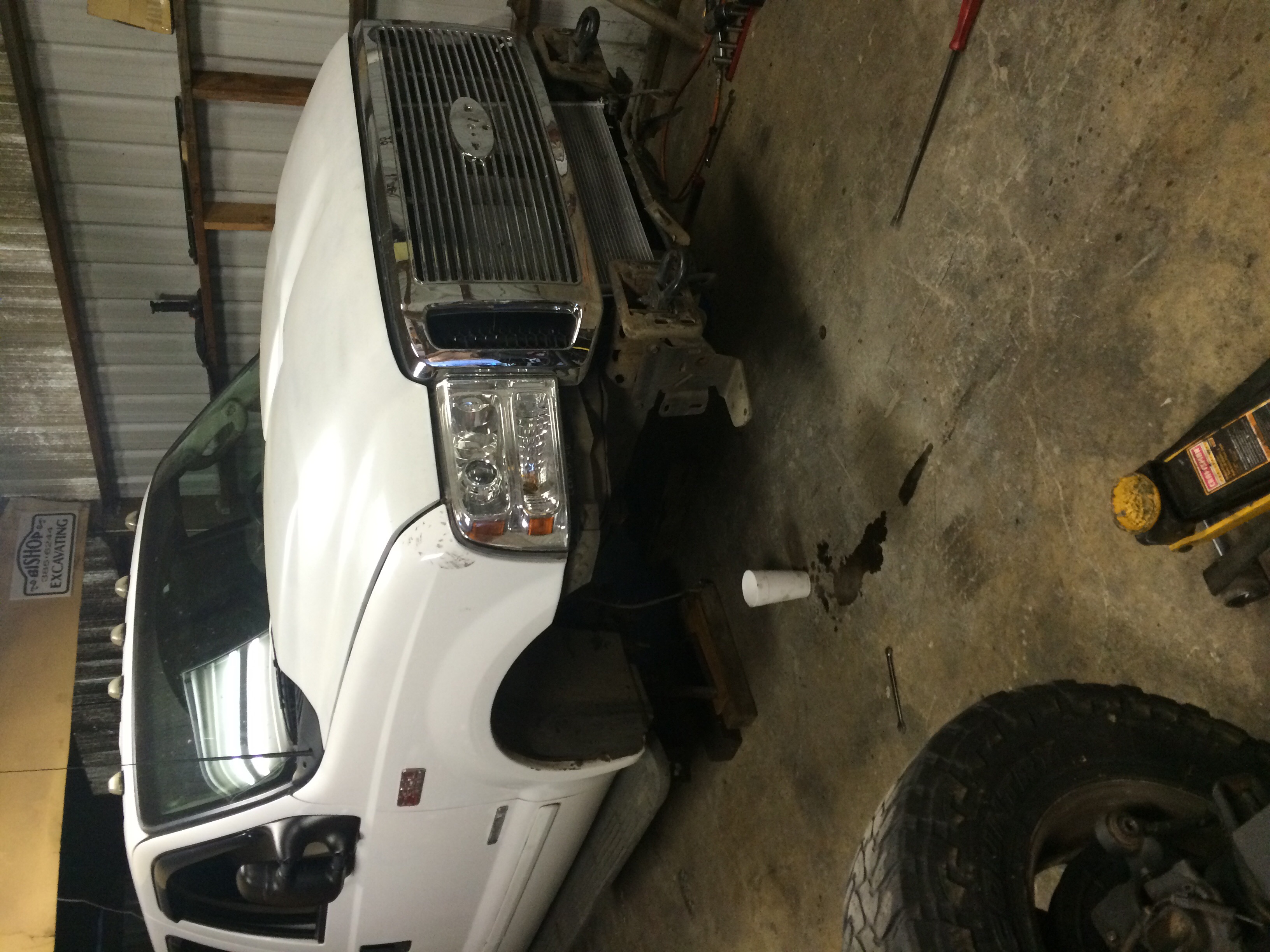

Ok I can't get the bracket under there tell I can get it on the lift this weekend. But this is what I could get.
