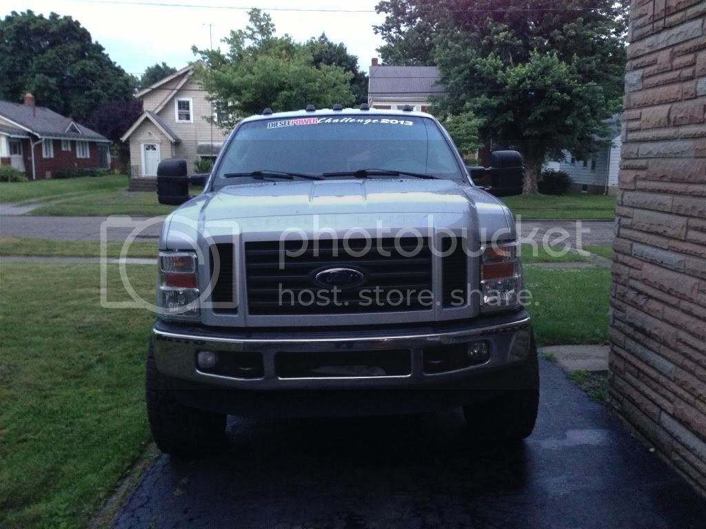

I know it's been a while since I posted in here. Iv been really busy getting caught up with work.
Finally got a lift.
Chrome delete has started
I am going to be doing the same thing with my grill but keep my bumpers chrome. That doesnt look bad I dont think. Where did you get that grill? Turbos look good as well.
