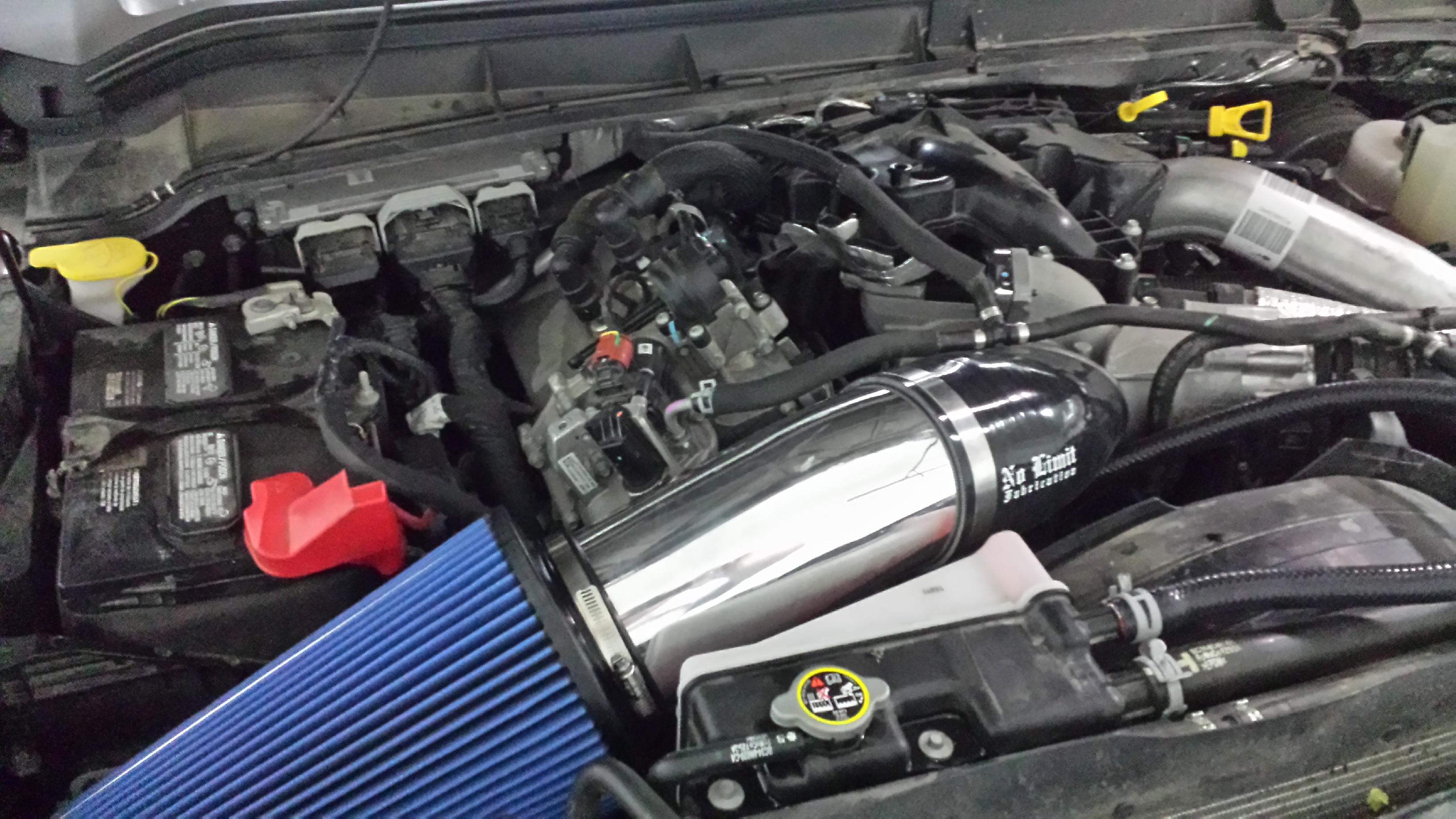

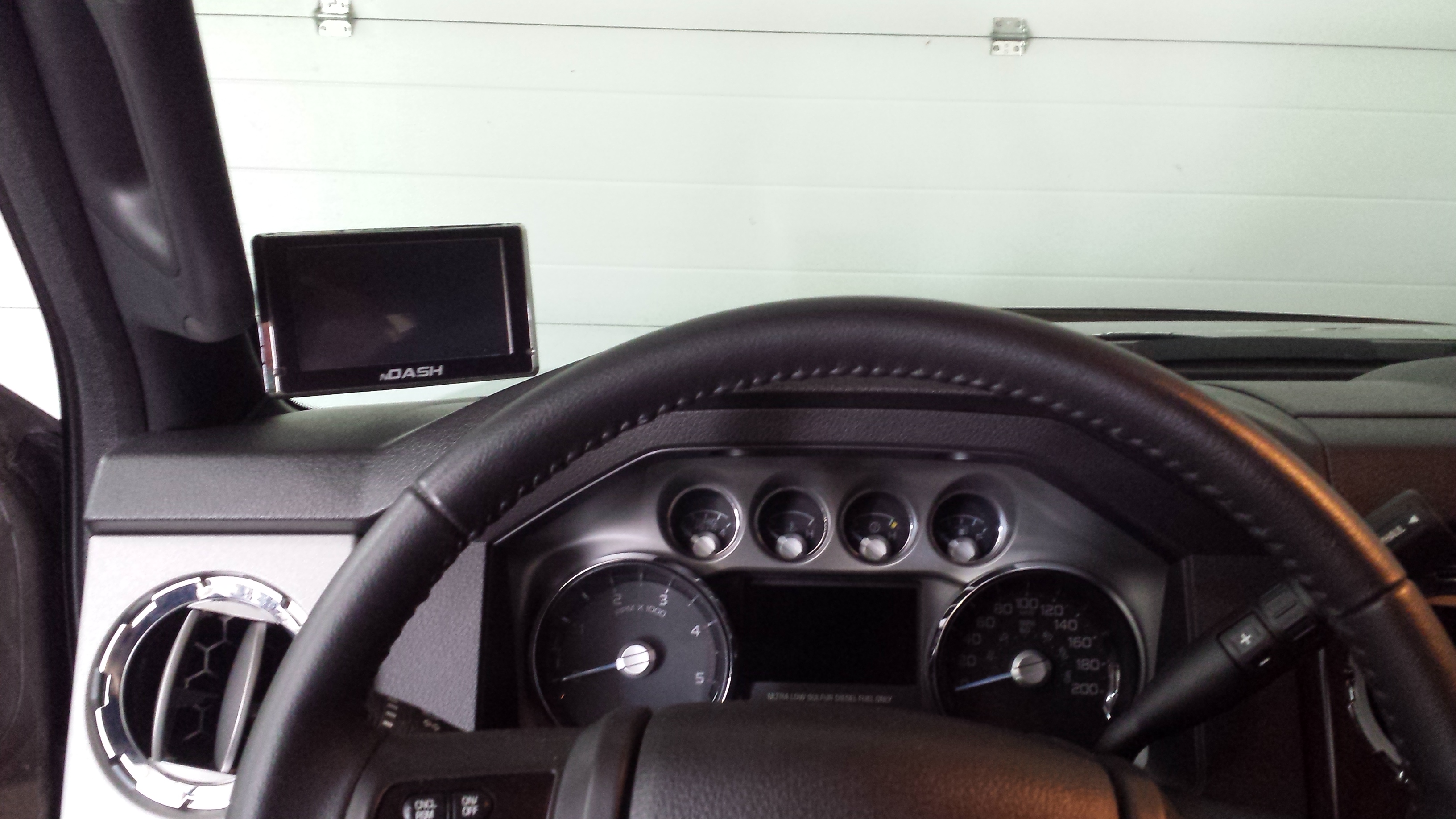

Finally got mine done with ndash and sotf. Wanted to give a shout out to Mike @no limit. Good guy to deal with putting my setup together and always answered my questions along the way no matter how stupid they were. Running the qr on the 500 right now, I told myself that is as high as I'll go until I can monitor egt's. Seems to shift good thou and pulls plenty hard, can't imagine how the 600 must feel. I pulled a probe out of the exhaust and put it in the blocker plate and plugged it into the egr, found the pid but the value doesn't seem accurate atm. Pretty happy with the spar setup thou

Really like how the sotf looks, almost factory

Pretty sure the tunes are the same for both just different style monitor. Ngauge is a round style monitor and the ndash looks like the one in my picture. I think ndash might be able to monior more pid's at once but i'm not for sure on that. Ndash just came out a couple weeks or so ago. Someone correct me if i'm wrong

actually the Ndash is the full led montior and the ngauge is just a round gauge.
