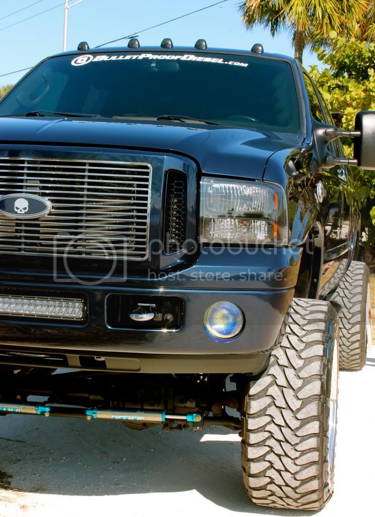

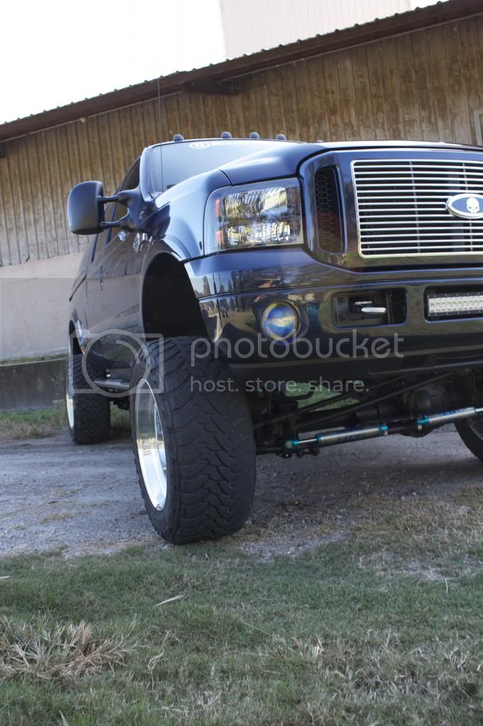

22x12.25 with 37/13.50/22's. I'd actually like a little bubble to protect the rim more.
For some reason I actually like how yours fit a little better than mine. I'm not sure which wheels you're running, but the AF 12" wheels have about a 1" bigger lip than my x11's and also stick out just a little more.
