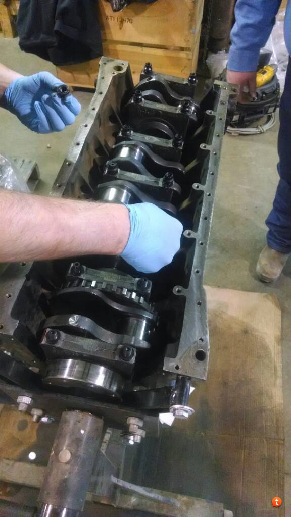

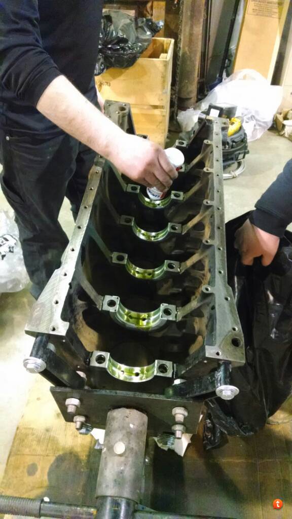

Well I got the engine back from the machine shop on Saturday! It got the following treatment; clean block & head, hone cylinders, main line check with ARP studs, disassemble & inspect head, balance crank and rotating assembly, magnaflux head and crank, polish & clean crank, install new guides and liners, fit valves and reassemble, o-ring block, surface head. A good way to spend $1,440
Patiently waiting for the Hamilton cam, ARP head studs, injection lines, and ATI dampener.

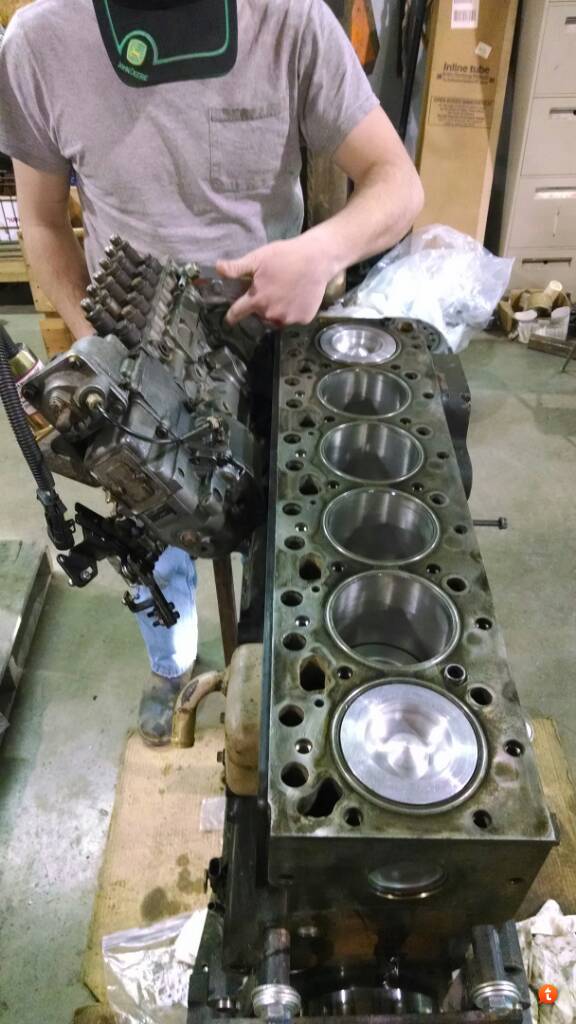

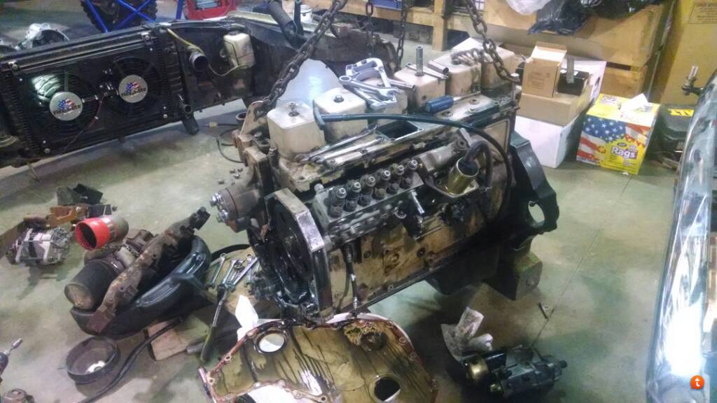

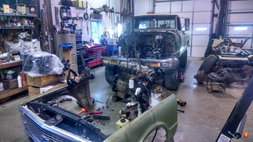

Before today's tear down.
3.5hrs later.
Tearing the old 12v to a striped long block. I have a guy in OH. that wants to com get it this week.

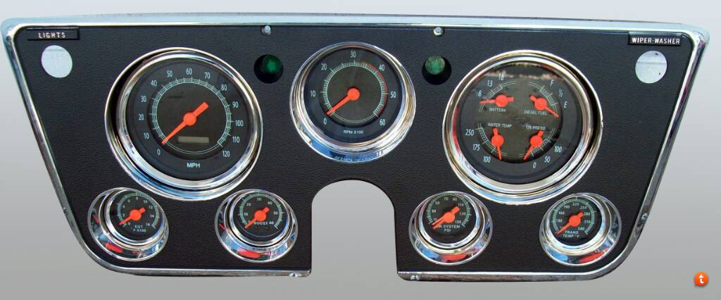

But I did find this. So clean, subtle and original! Gonna have one custom made. Guy I follow on instagram has one in his '72 with a duramax swap/ zf6 and he loves his.

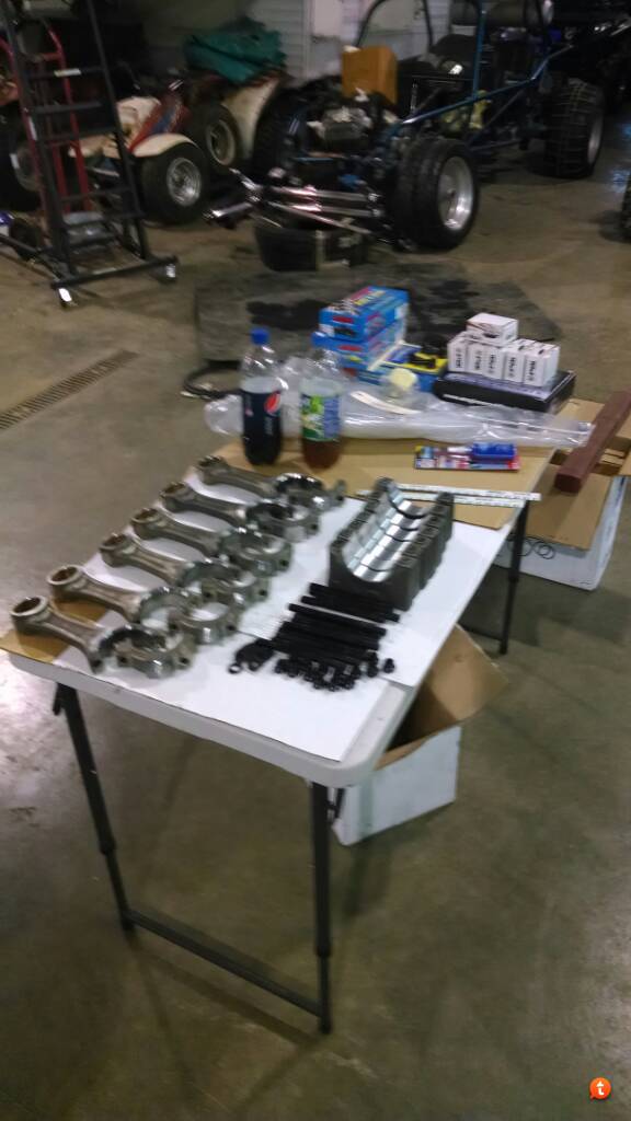

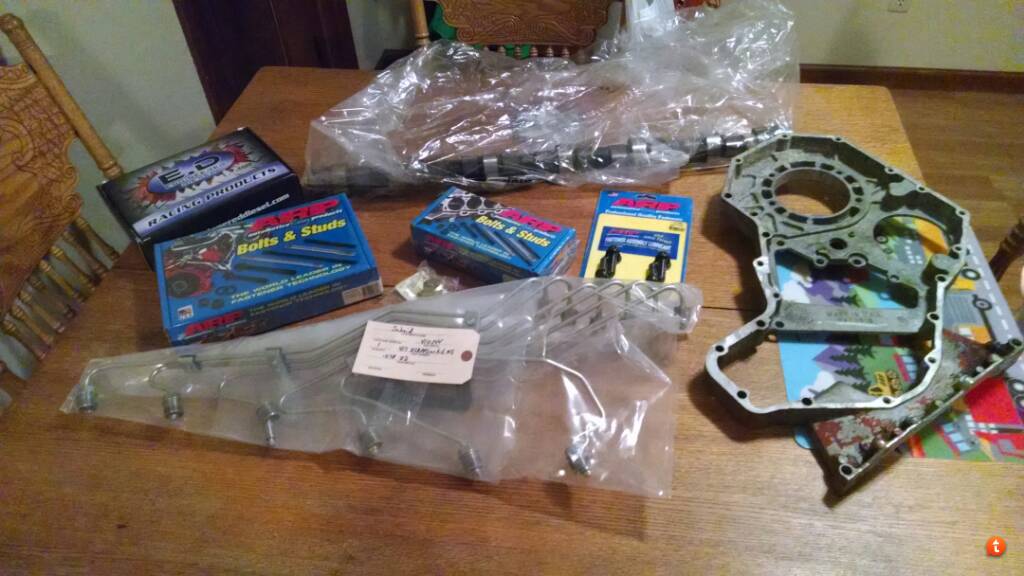

Well I ran all over the state today picking up parts and this is what I came home with!
Hamilton 181/210 cam
Scheid .073 p-pump 24v injection lines
ARP head studs
ARP rod bolts
ARP dampener bolts
Bosch rack plug (Mack)
OEM feed tubes with new o-rings
OEM '94-97 12v p-pump case.

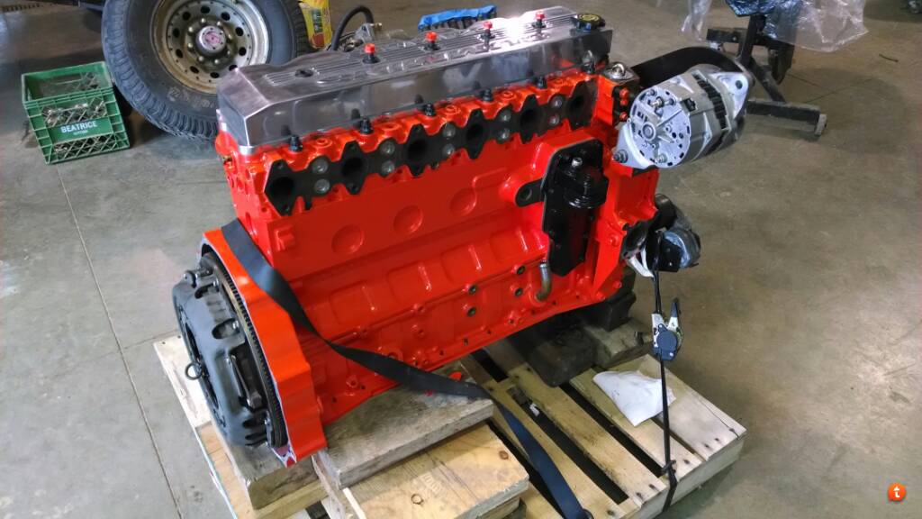

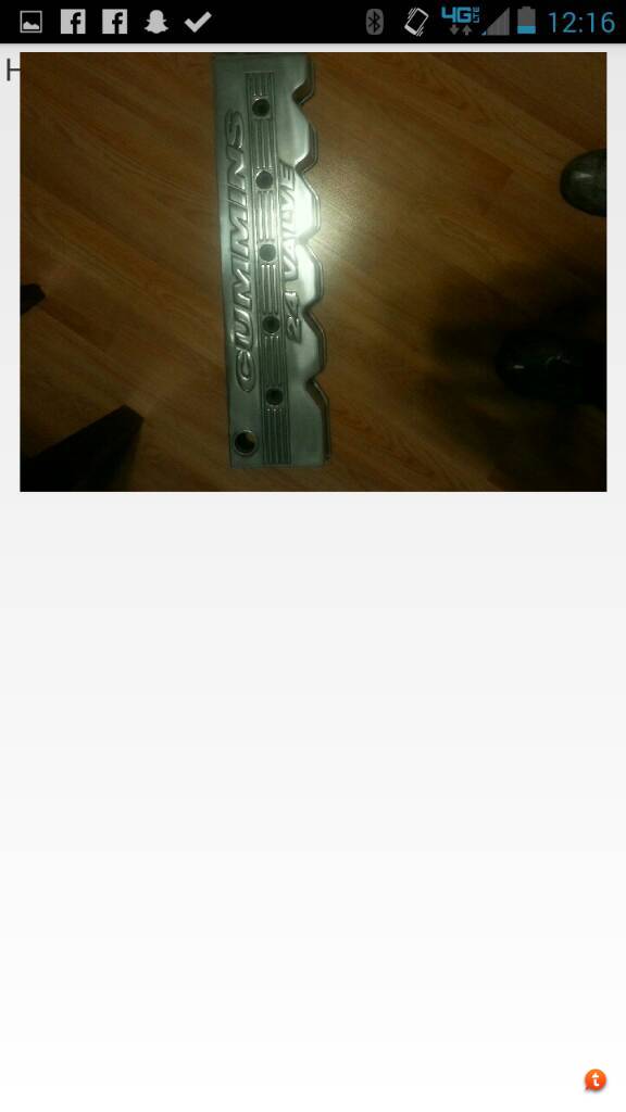

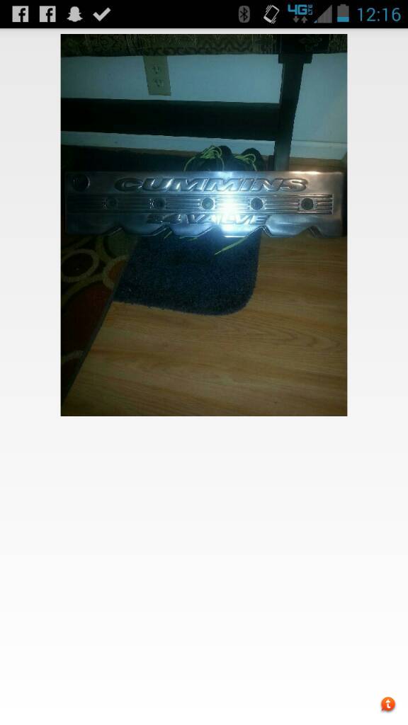

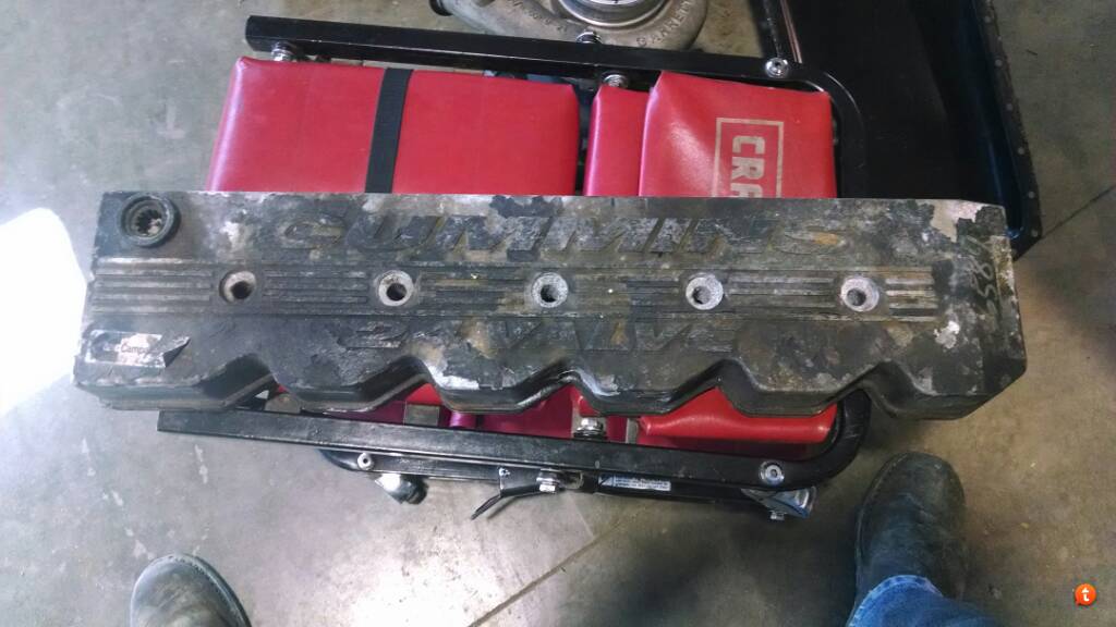

Ohhh and I got my hands on an industrial Cummins 24v valve cover. I had it cleaned up.
Before.
After. (Sorry for crappy pics. I'll take better tomorrow when I get my hands on it.)
Tomorrow is assembly day! Pictures will be updated along the way.

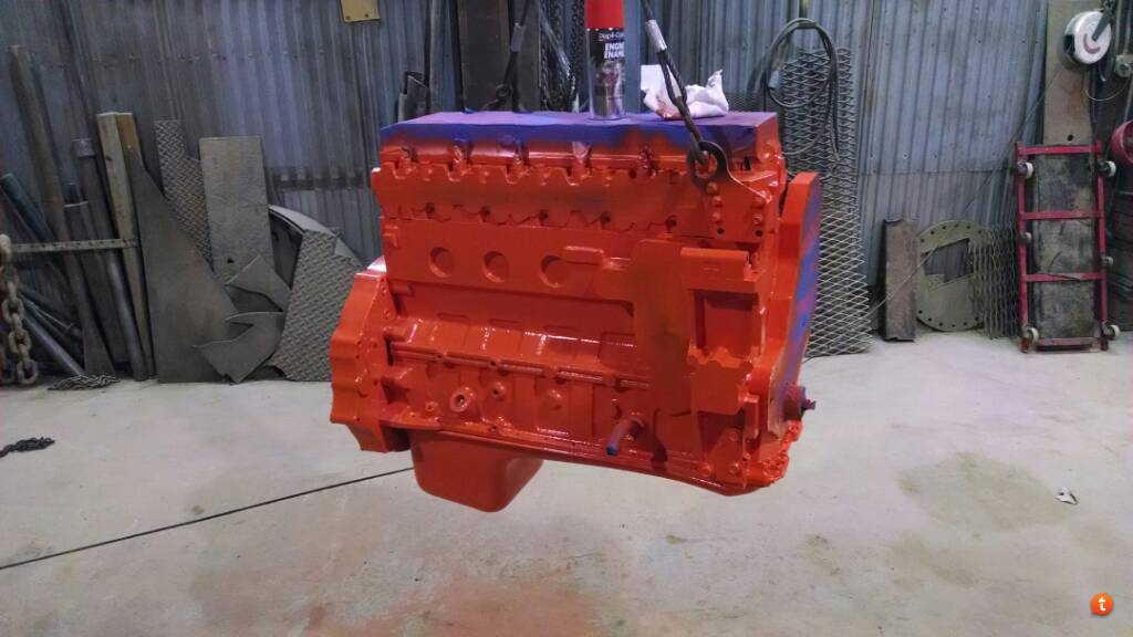

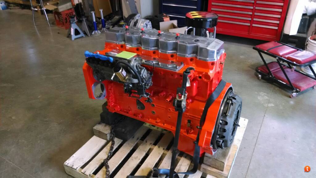

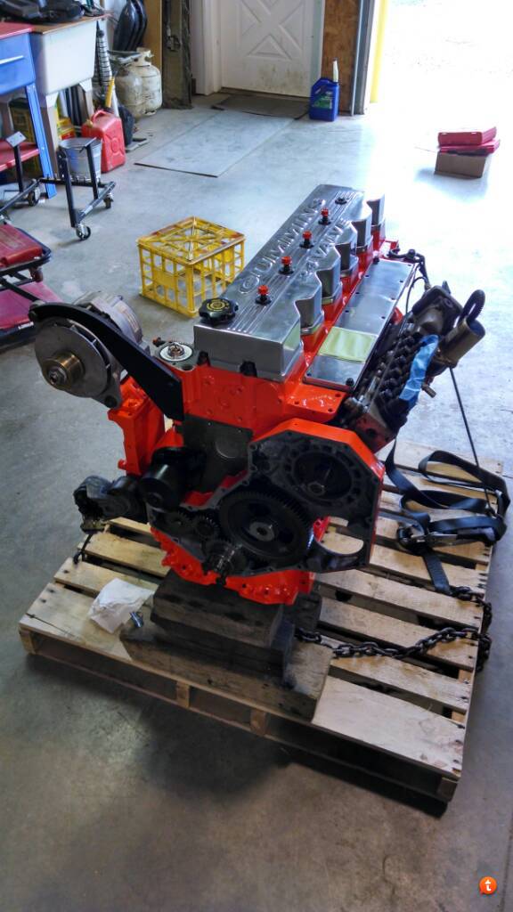

Got it all taped off and painted this weekend. This was the first coat of Duplicolor Chevy Orange 1720.

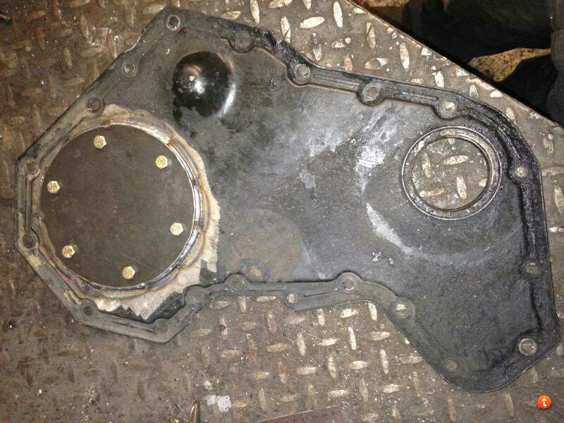

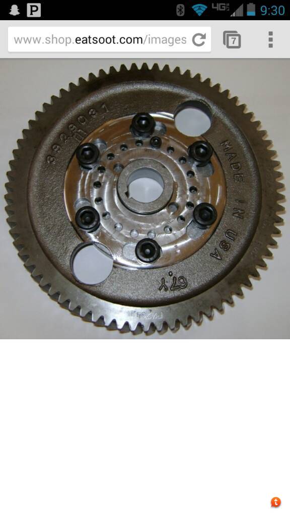

Now I just have to send my pump gear out for core to have a custom adjustable timing gear made. It will look like this
Its adjustable from 0° to 40° in 2° increments.
Then instead of buying the $350 aluminum front cover with access plate to adjust the timing, I'm gonna make one. I found this idea on CompD looks simple and I think it should work great.
