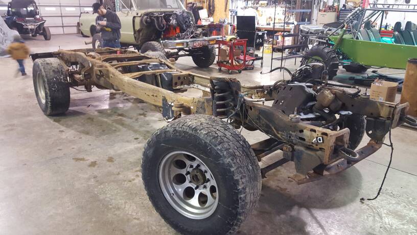

Dropped the trucks new chassis off at the Hotrod/ chassis shop tonight. They are going to cut 14" out of the wheel base to bring it down to the needed 127" for the '71's body to line up with the axles. Guy said that he was going to probably start on it tomorrow and get done in the little down time he had between two projects he had going on.
