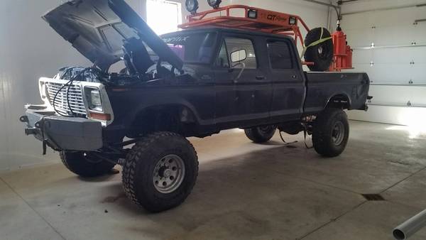

New Home
As discussed, moved Eleanor to my buddy's pole barn. As it is essentially climate controlled (fancy talk for heated with a roof), weather will no longer be a hindrance.
We cleaned out the bed (again), and removed all the tools and bits we had in the cab.
Plenty of room to do what needs to be done.

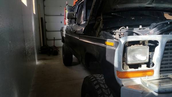

The bumper has been adjusted and new mounts made. It now fits better than previously.

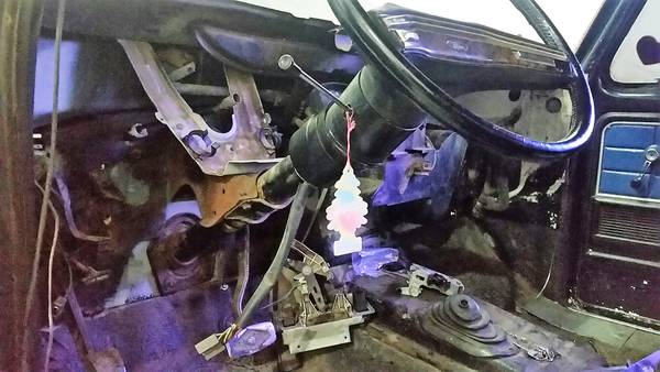

Ran out of time Saturday. Was able to complete the following:
1. bring all shop manuals out
2. bring out electrical schematics for the donor
3. start labeling factory wire harness
4. remove rest of dash components
5. Install my Pina Colada air freshner (smells like strippers from Missouri)

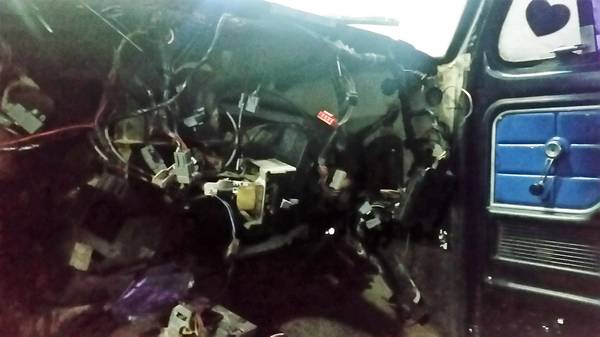

update
Old wiring harness is finally out of Eleanor. Made a list of internals that I will replace just in case, since the dash is already out:
1. Heater core
2. Heater blower
3. windshield wiper motor
4. sound deadener
Anybody have any other suggestions?

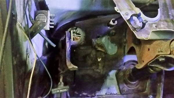

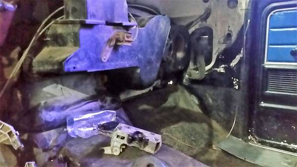

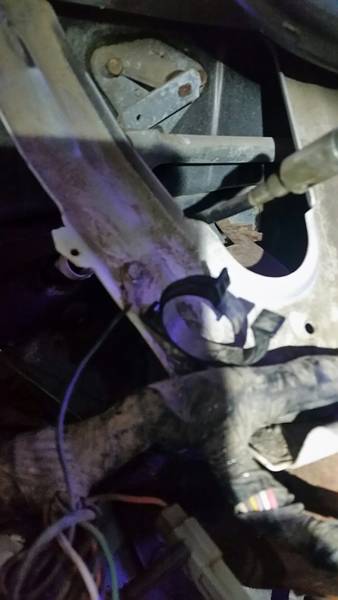

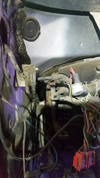

Pictures or no proof
As stated, I got the old 1978 harness out of Eleanor. Not really very exciting, but some good reference pictures for myself.
Buzzer
reference:
These will need to be modified to hold the thicker harness
cleared out:
Not much room here;
Modern-ish technology portal to link to the "brain"
