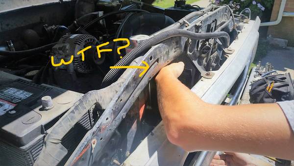

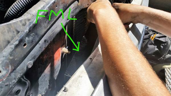

action shots of trans cooler install (sexy, right?)
Sexy stuff right here. Involves a butt plug for the rear line of the transmission (had to remove). I used a spark plug.
Installed the trans cooler in front of the radiator. Not much room to get my cow milkers in there. Good thing I acquired the protege. Skinny long arms and non-milk man hands helped out a lot.
