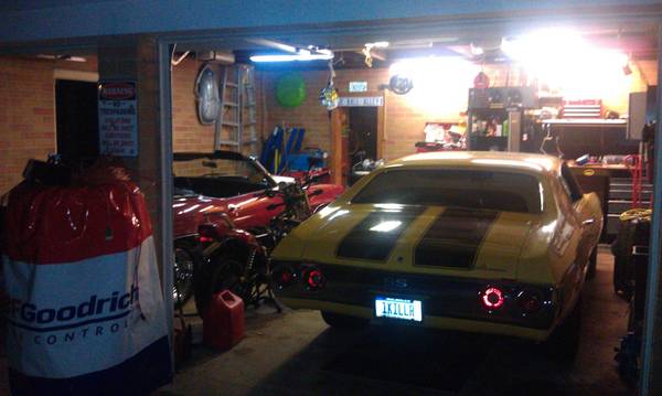

I don't have a "shop".
I don't even have a Pole Barn.
Hell, I don't even have a regular barn.
I got a three stall garage.
One of which is a make shift bar complete with pool table.
The other two stalls are crammed with my other love; classic cars.
So fortunately, I have understanding neighbors (most anyway) who respect my shade tree mechanic ways...

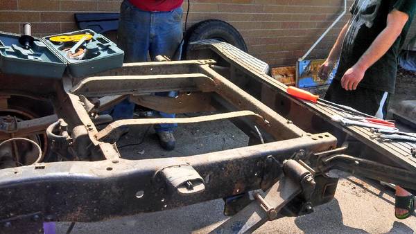

So lets just drop the gas tanks and the bumper. 20 minutes right?
Of course not!!!
At least we got it down to the frame...
Not sure about the booger welds. Will need to improve on that shock attachment...
The bumper was less than fun. Another booger weld...figures
When you break something, fix it right. Nah, that makes too much sense. Oh well, at least we can get to it with an angle grinder...

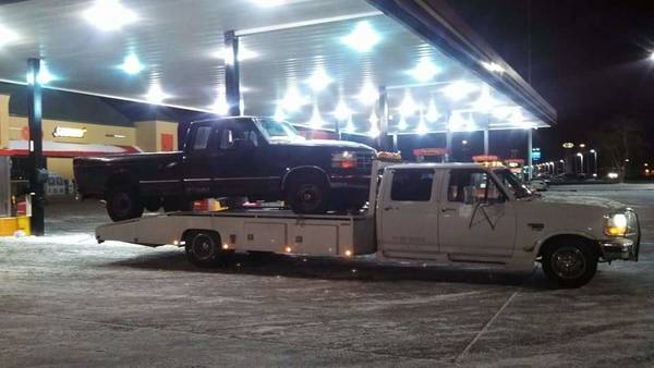

Finally, a few months (or years at least it felt like), I found one that met my criteria.
In chicago. Of course, why not near me. Oh well...load up the hauler and grab it...
Ex-plow truck, so low ish miles (160,000). Also meant we were going to find lots of crusty bolts and crap to get this monster motor out. 4x4, automatic, and derpy exhaust cut through the hood (think mini stack).
After a little debating, we agreed on a cash money price of $800. Truck runs, drives, stops, shifts, everything its supposed to do. Kid just needed money for college.

Thats a heck of a deal on that truck with the mileage. Engine alone is worth that. Good Score!
That's what I thought too. I kept seeing 2 grand for crap that couldn't get out of its own way. Or was twisted.
When this dude's CL ad hit, my phone lit up, and me and little dude were on the road with no hesitation.
Truck ran good enough I could have driven it home. And at that price, I didn't mind making it into a donor truck.

That is a damn good deal. I come across 2wd truck over here in the 1500-2k range. 800 is a steal for a driveable rig.
