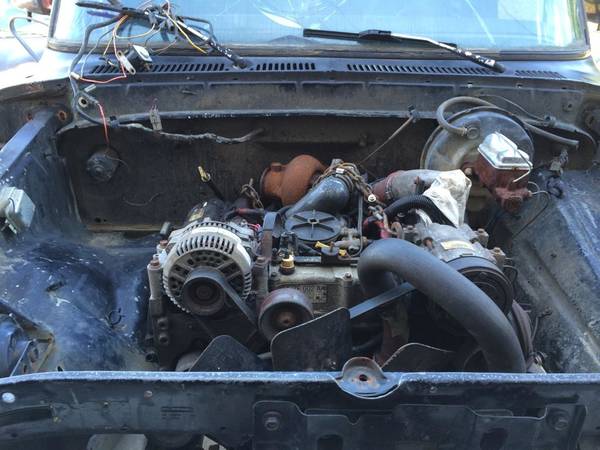

several months later
"It's done..."
The best text I have ever received at 7am (besides the "I'm not pregnant ones)...
The motor is in, the drive train is mounted, the down pipe is being built and will be in place, the custom radiator is almost installed, and the dual fans are to be set up...
Picture time....
Do I look like I am running a diesel?
sexy welds...
1killerz
Feb 8, 2016
342
Western Michigan
I know its not...
I know its not cleaned up (motor)
I know its not scraped down (frame)
I know the body needs some attention
Right now I am simply mocking everything in to place. Running wires. Figuring out where to put things, mount things, etc. The cleaning, scraping, etc., will all take place in time. I just want to be sure to do this right before I lay down major elbow grease and money in body work, paint, etc...

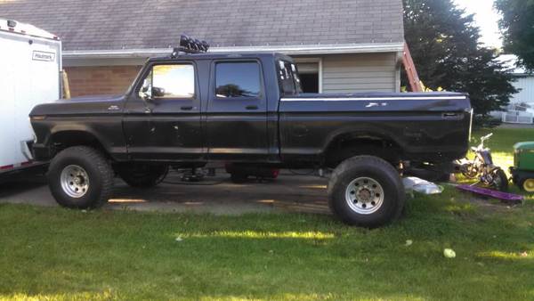

STANCE
And while I was on the internet, which is a 3 times minimum daily occurrence, in another site's forum, I searched and found some 37" Goodyear Military OZ tires with some rims for the right price.
So of course, I bought them even though the trucks not running at this point yet.
Got home, got excited, wanted to see how the truck sat, if there would be a terrible rake with the PS in the front sitting on clapped out current leafs. So like a kid at Christmas, I tore off the studded snow tires and installed the new hoops.
original snow studded sexiness>>>
single shock will be converted to dual shock once I am ready to put the D60 in... and after a bujillion dollars in stupid unnecessary stuff like air lockers and what not.
No real surprise, a little rake. Nothing new leafs in the front won't fix (hopefully)

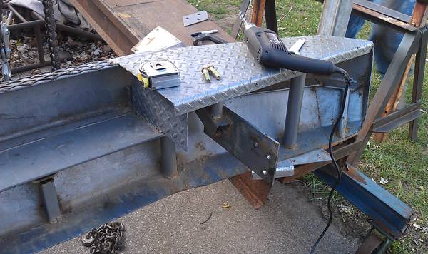

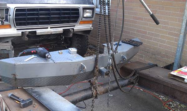

front bumper
A few years ago, I was on a business trip. I did as I always do and searched the internet for local parts.
I came across a super heavy duty ranch hand style bumper. I bought it for Eleanor, before I ever bought Eleanor.
Weird how the mind works sometimes...
Anyway, I put the bumper on my Bronco, and now that Eleanor is here, and not running yet, I wanted to put the bumper on anyway to determine how the additional weight (its heavy) would effect the rake/stance.
1killerz
Feb 8, 2016
342
Western Michigan
front bumper continued...
As it was on the bronco...
Needed to pull it off and I will put on the tube bumpers I bought to replace on the Bronco.
Pretty stout bumper...
It fits, but it needs to be set back to be more flush like I had on the bronco.
Still working out ideas for the rear bumper. I think I got an idea. More on that later.
