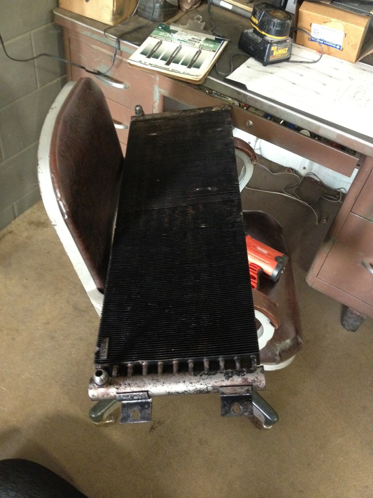

New trans cooler! It's a hydraulic cooler out of a bobcat! 33x11x2. Should keep my Trans nice and cool

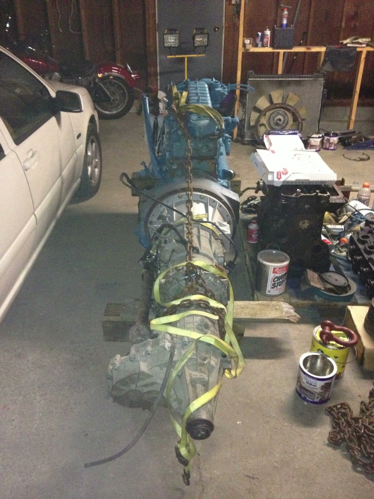

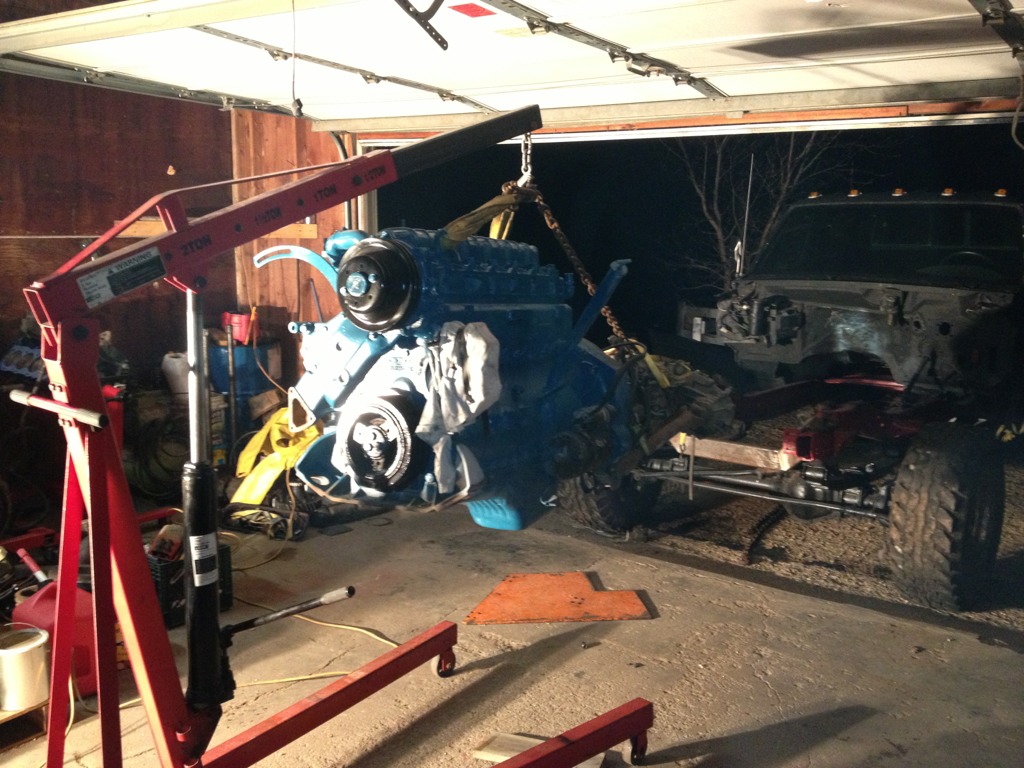

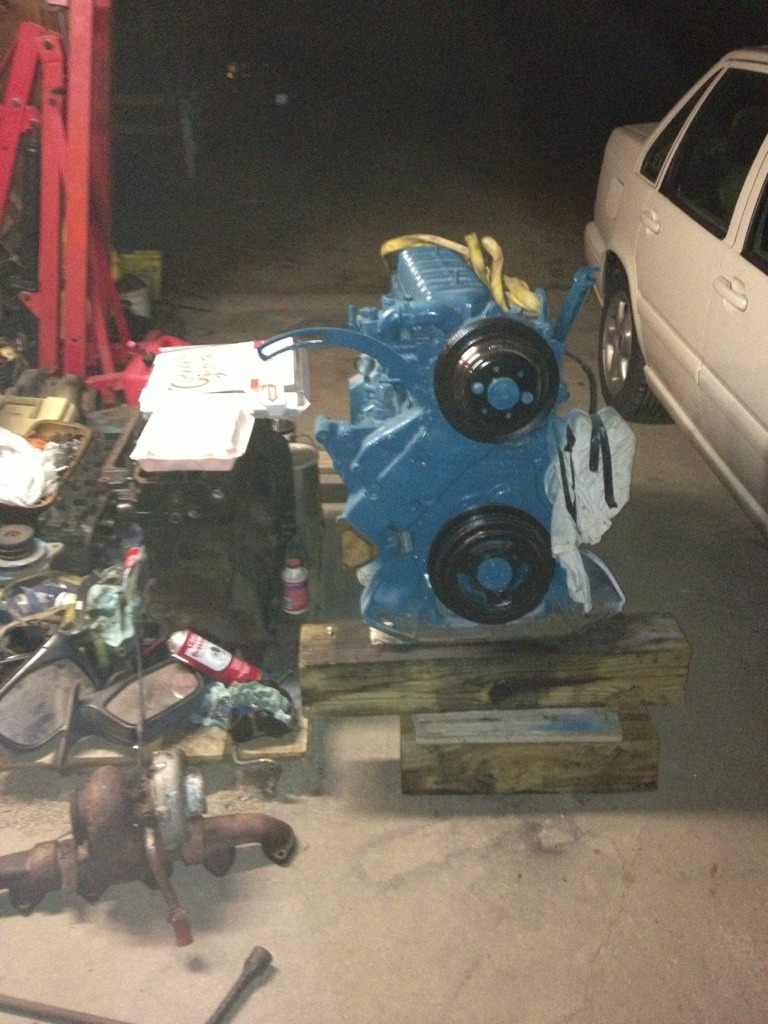

Here's some more pics. Getting it all torn down to finish welding the frame and reblast and repaint it. Then on to final assembly! My cherry picker surprised me Thursday night by lifting 2000 pounds on the half ton setting! It's almost down to bare frame, all that's left to remove is the cab and axles with suspension. Injectors are going in the motor this week, and I ran in to some issues and haven't been able to pay for my pump adapters or turbo rebuild kit and header yet, but I'm optimistic. Hoping to be back on track soon so I can get it done! The last 2 pictures show it next to a 5.9 cummins.
