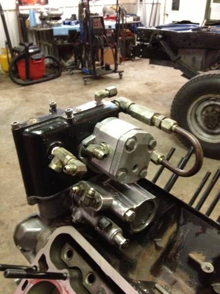

Wow, there are quite a few connections on that Gen3. Where do they all go?
Looks like you are going to have one bad@ss truck!
Beau
Nov 7, 2012
106
Buffalo, MN
One dumps oil into the Oem HPOP, one fills the reservoir with oil, oil pressure sensor, and oil temperature sensor.
