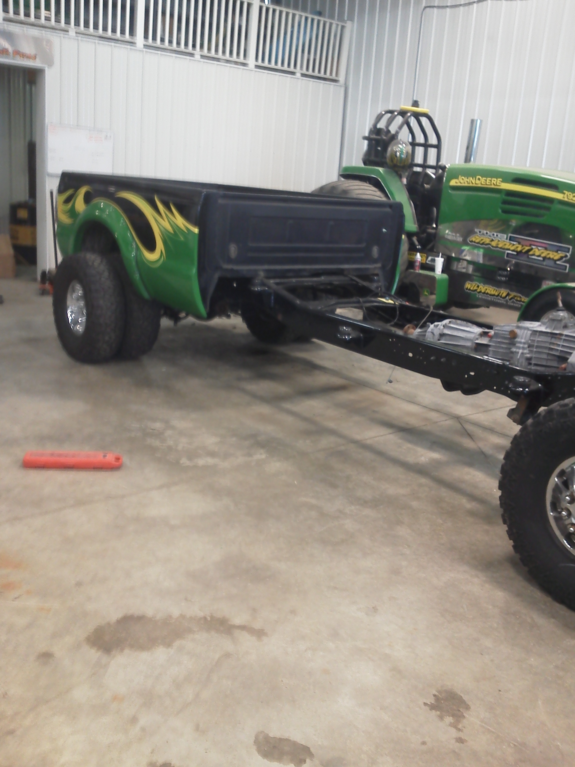

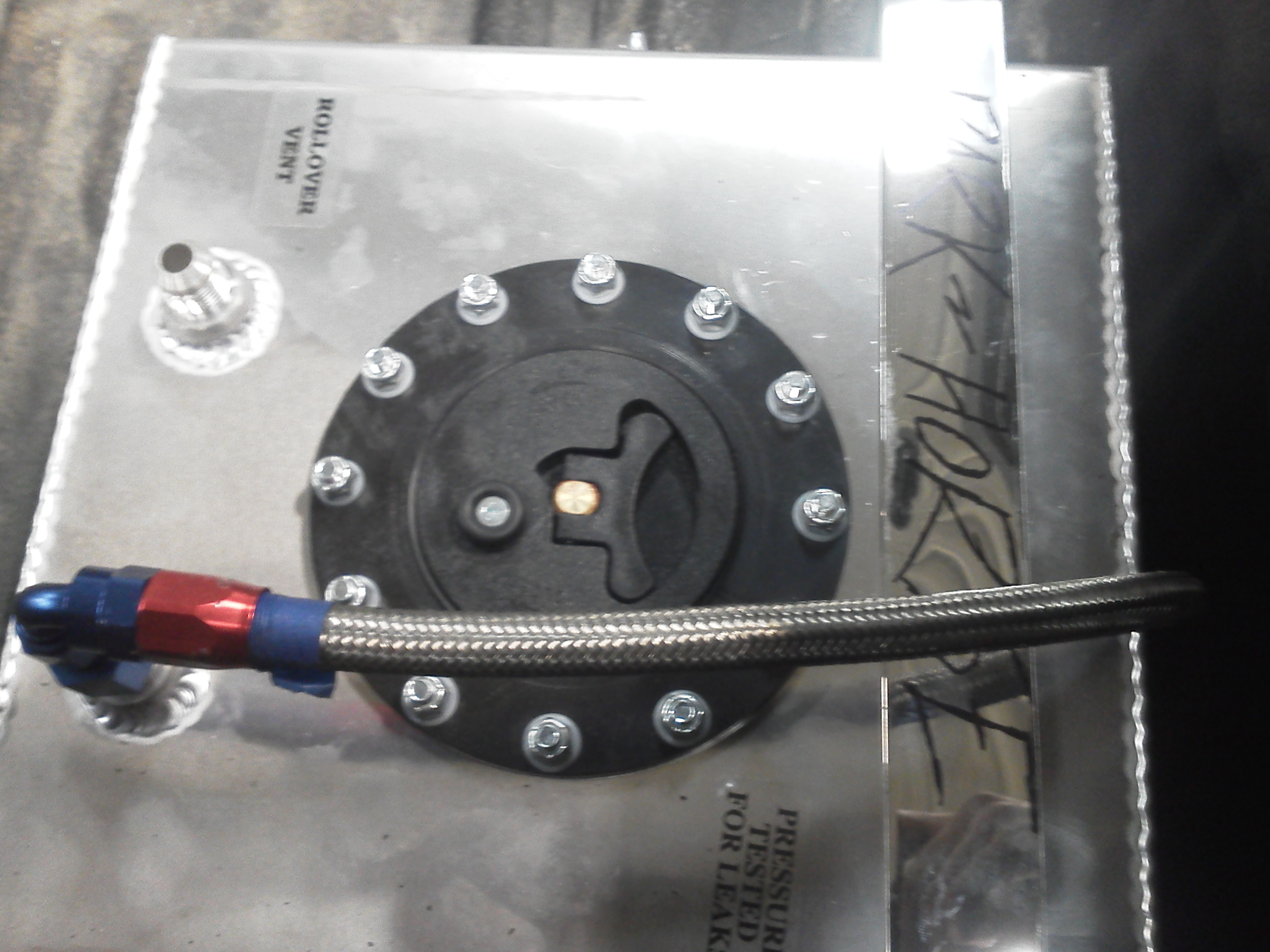

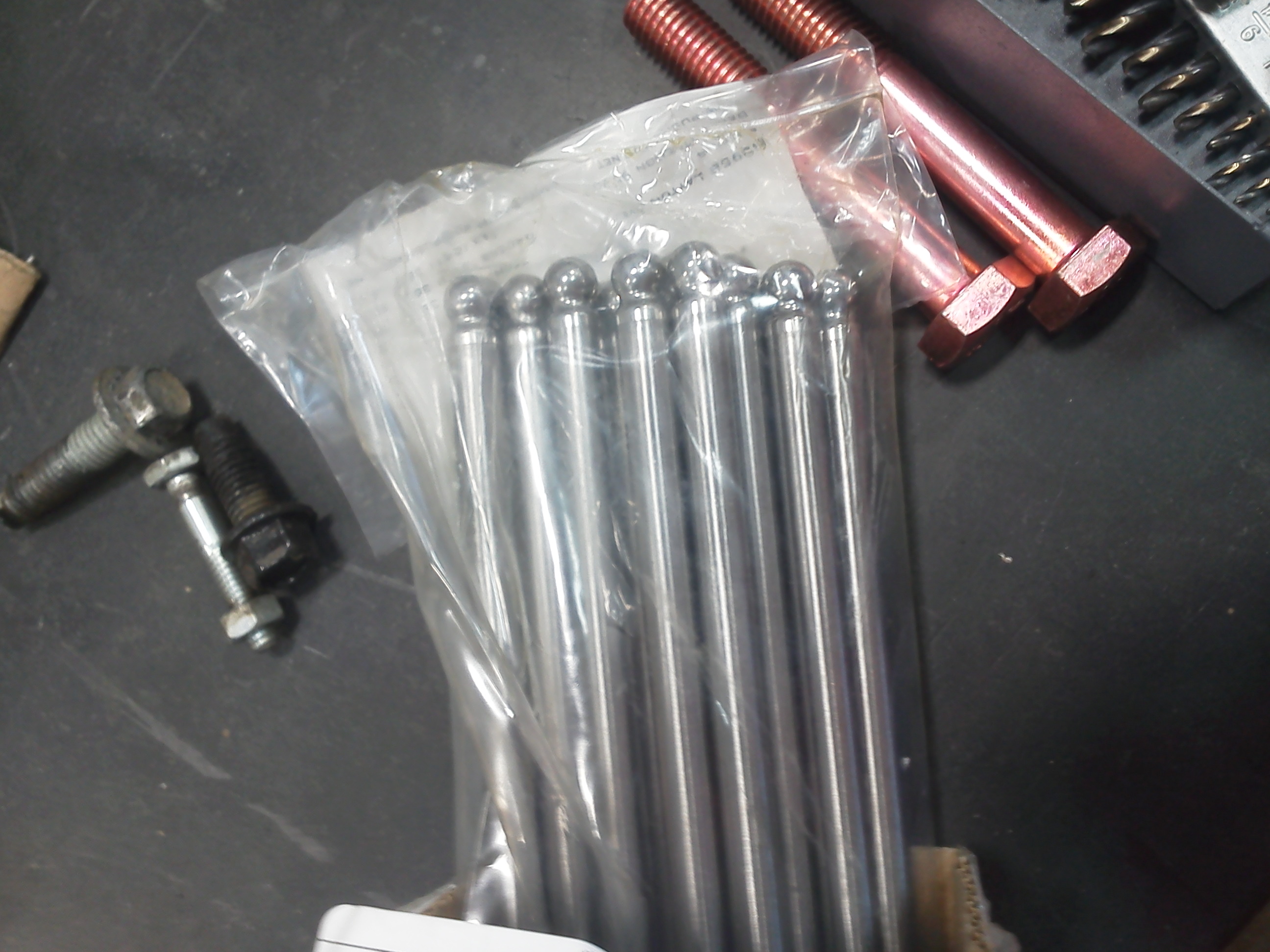

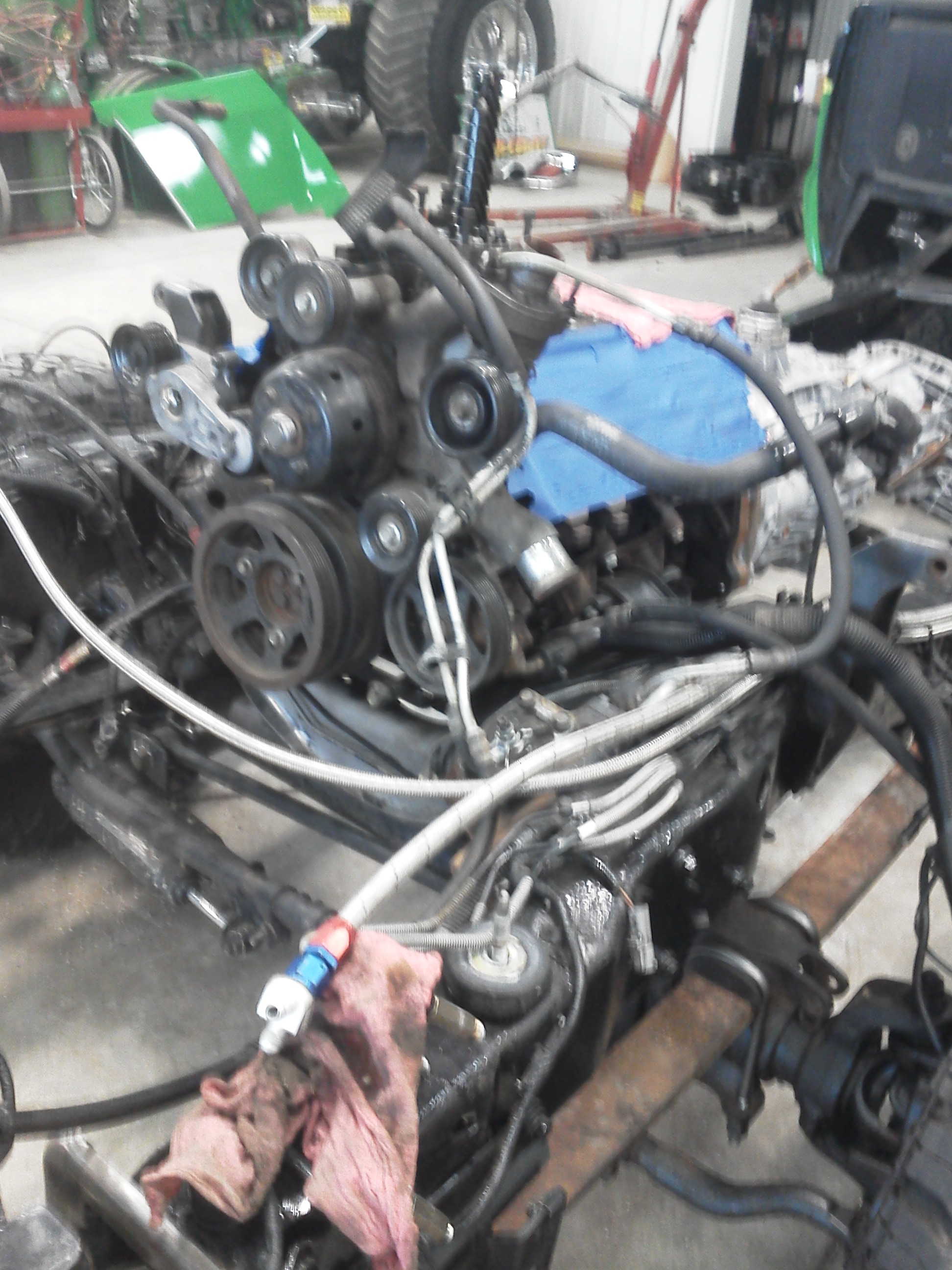

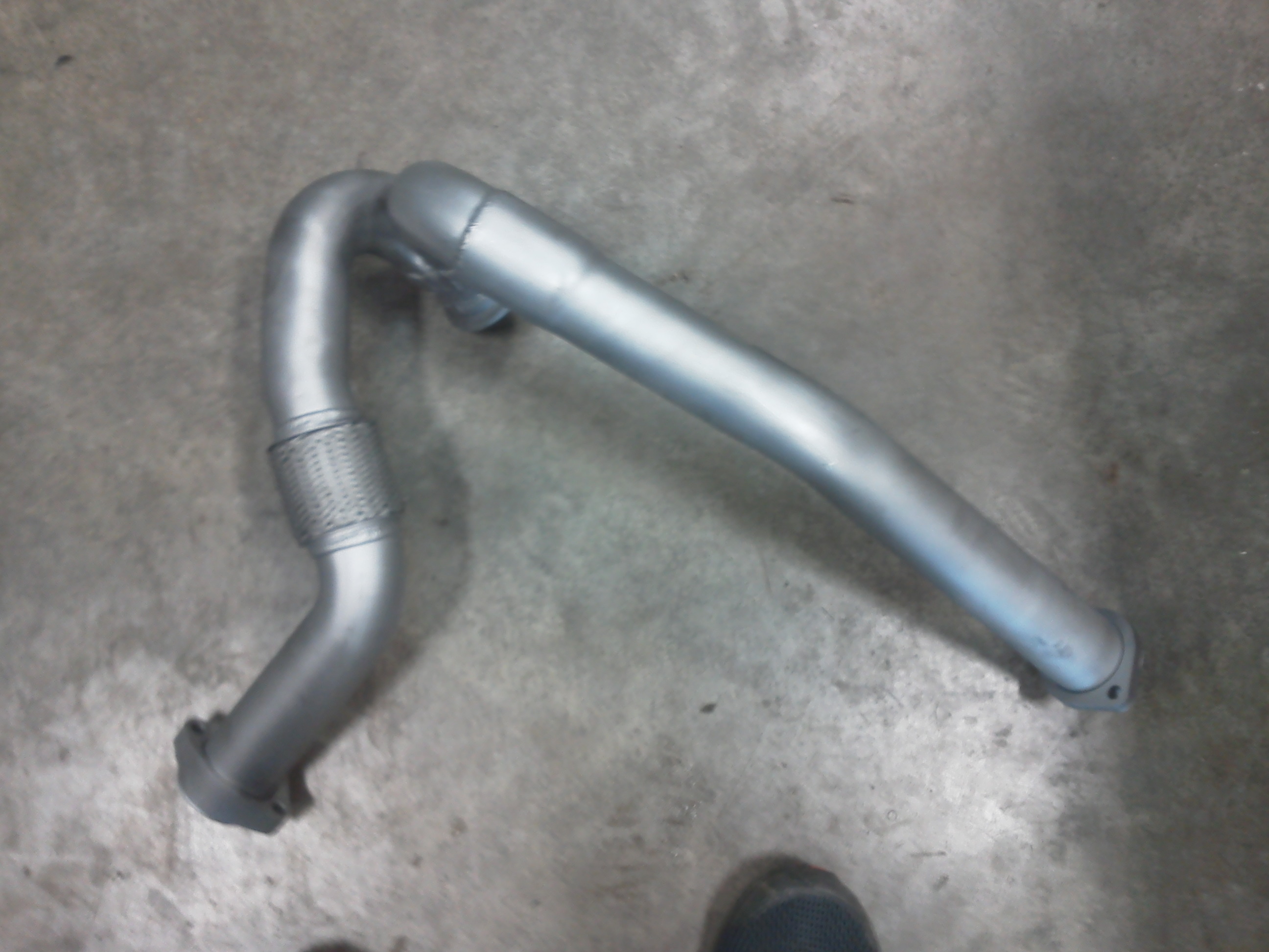

sorry been really busy on this and work, getting harnesses swapped,bodys swapped, so on but here are a few pics of the progress! smith bros. push rods, 5 gallon cell, fuel system is not complete as of yet but you can see I have a start, 4200 Iron giant and a set of Liberator solid up-pipes..more to come!

looks good except those pos upipes.
kyle43335
In the Brig (Banned)
2,364
Well Kyle inform me on em ? Why POS
Its a modified stock piece. The collector flow is horrible.
The bellow on the drivers side necks down to 1.75 inches.
That y pipe is a turbulance nightmare.
Build something that will actually flow.
If you need ideas pm me and ill send you some pics
this^

that's really nice Kyle! But why not use HD bellows...they look stock. Where did you get the Y collector with flange that clamps to the turbine side? Or did you make/fab that up? Also where did you get the flared ends that clamp to the manifolds?

those are hd bellows,made from t 304. the actual bellow is inconel.
they look similar to the stock bellow,but arent the same.
the collector is a bent merge collector from spd,its also made from t304.
the flared ends are/were 2" t304 straight pieces flared to roughly 45*.
everything was bought in raw form to make that.
the flange for the turbine was cut from a stock unit,cleaned and welded to the bmc.

Well i found the right thread this time.. cab is on and should be firing it up tonite, I also had to mod the up pipes cause they wouldn't fit!, as it sits now it has a 4200 iron giant, billet HO hpop, 275/150s,ported heads, s366 batmo with a .91 devided housing, full fuel system, and so on, shouldn't be to bad to start with, but its gonna need a s4 or somthing of similar size..more to come!

Had some wiring issues, but we got it all figured out, built the Hoodstack last night, and im planning on having it at the Warsaw,in test n tune this sat.
