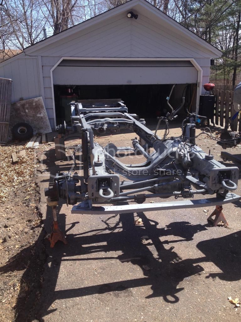

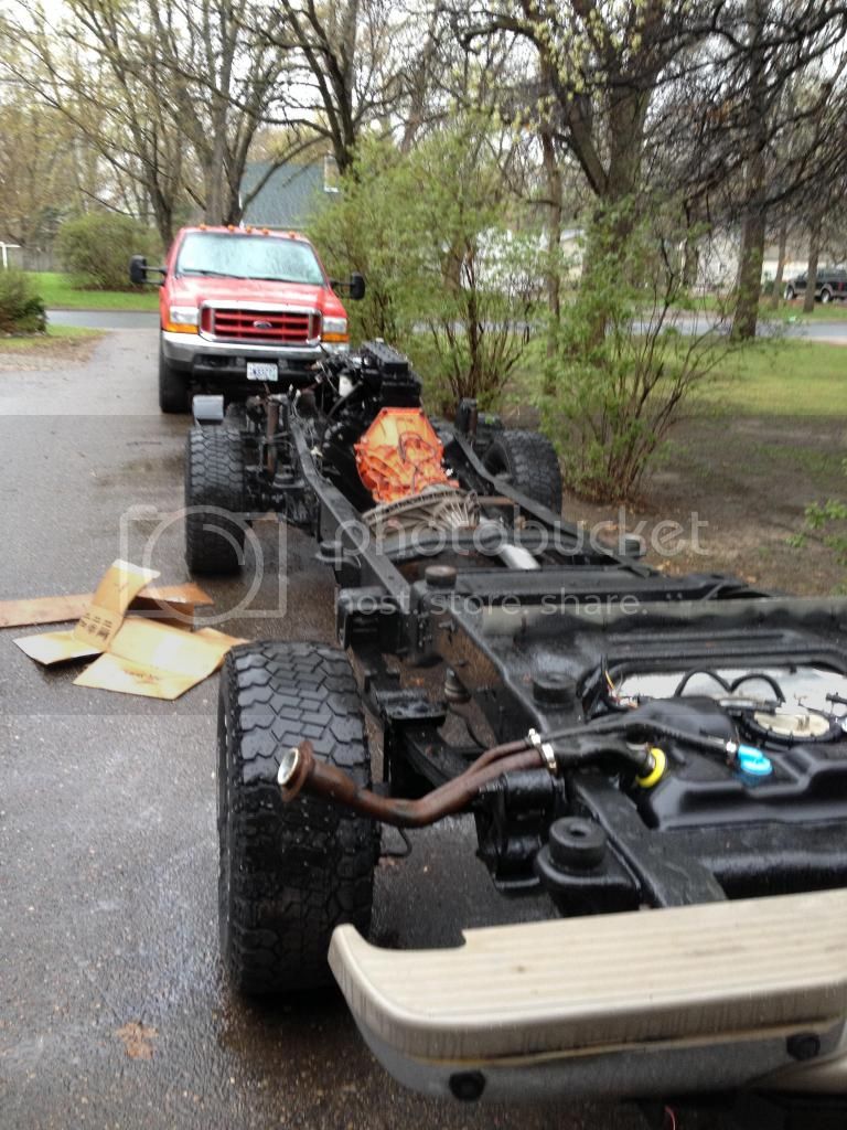

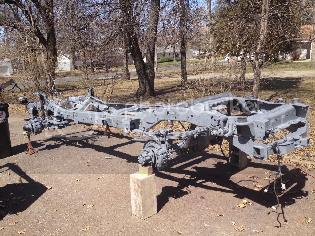

Looks like a left off with the frame and body were separated. I took a day off of work “sick” and Por-15 the frame then did a black top. This turned out great, since its been about 4 months since I did this it seems to be holding up great. Will see what this winter brings. I also Por-15 the underside of the body, raptor bedlined it then sprayed that with a Black top coat. Its tough as nail.

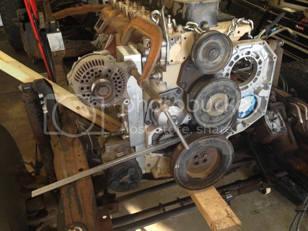

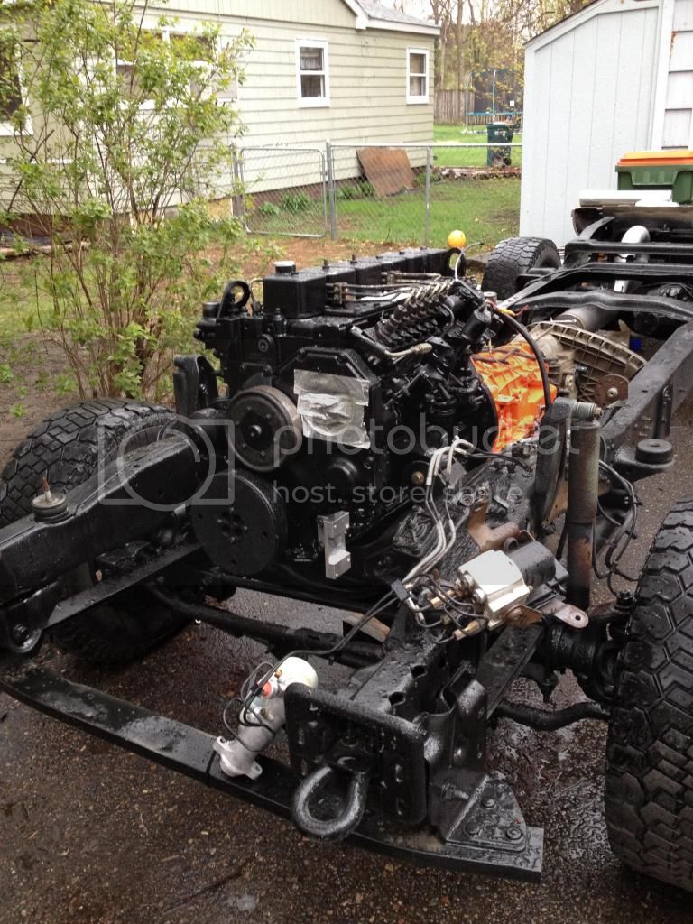

Next it was onto building some motor mounts and getting the motor mounted in the frame. I like everything I do cant pay someone for something I can do my self, so I made my own motor mounts out of dodge 2500 control arm bushings. Things are beefy and I figured if they can hold the front axle on a 3/4ton truck they will work just fine for motor mounts.

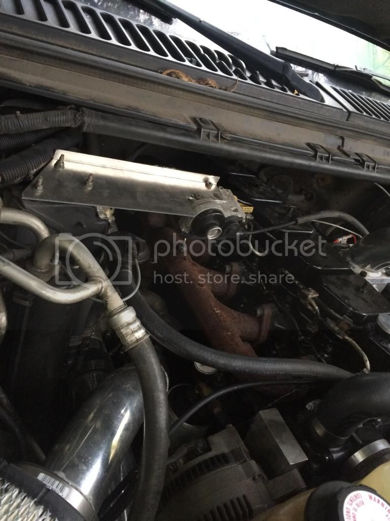

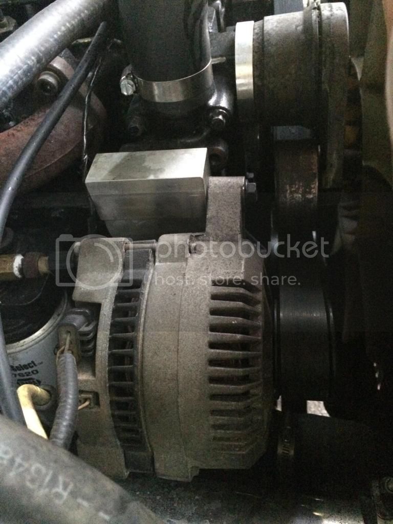

Next was I wanted to use Ford Alternator, Powersteering Pump, and Ac. I spent some time in Cad and then made a few brackets. I also had to use the fan hub out of a new Common Rail since the one I got was out of a MDT and sits higher.

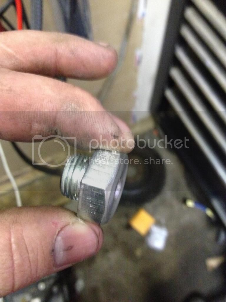

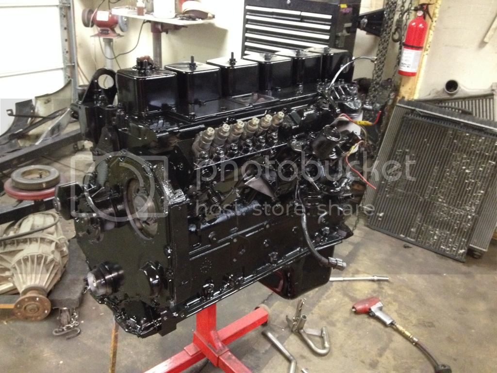

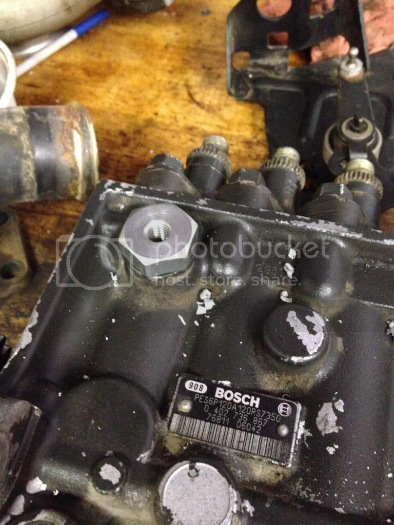

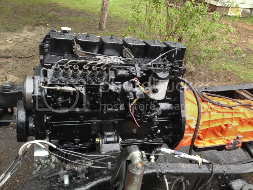

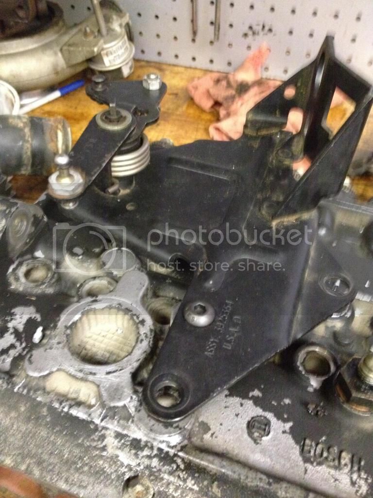

Next was onto assy of the motor and getting it painted. This is where S#$T kinda of hit the fan. I knew all along the pump wasn’t out of a Dodge truck even thou I was told it was. So I picked up some throttle linkage(stuff isn’t cheap) then had to make some special bolts to mount it to the pump.

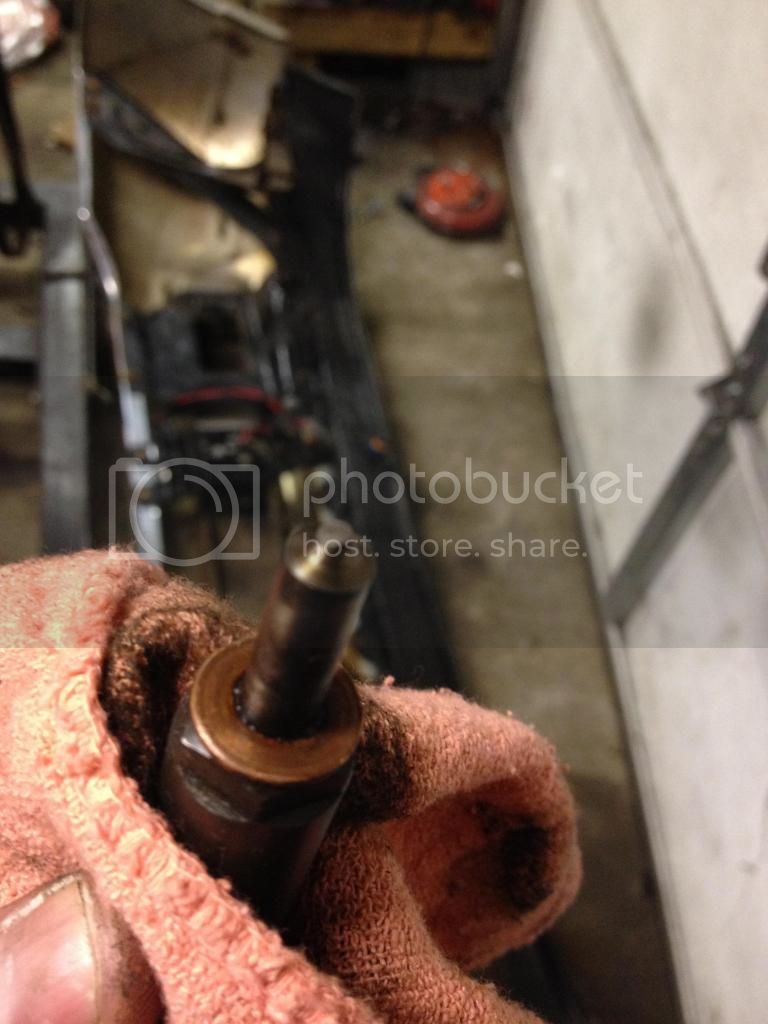

Next it was onto assy of the motor so I could paint it. During assy I noticed that one injector either some dropped or hit with a hammer, Yippy now I get to buy new injectors. Order up a set of 5x.012”

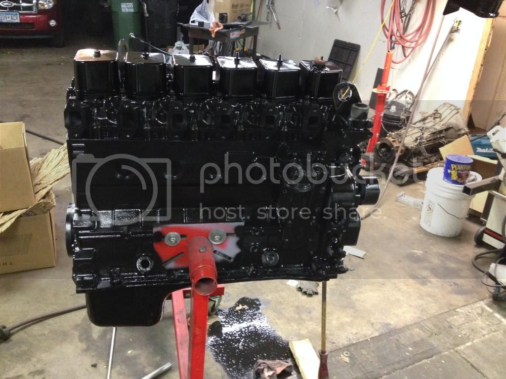

Got the motor painted, transmission installed and in the truck ready for the body togo back down. At this time I wish I would have ran the exhaust but due to some outside reason I didn’t.

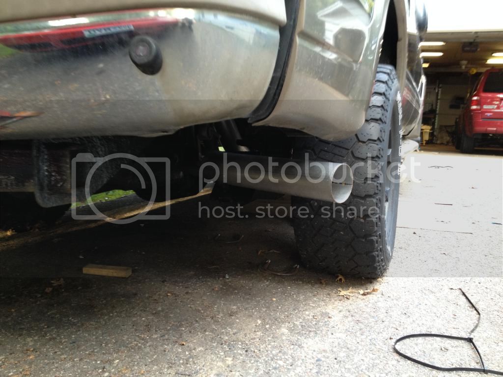

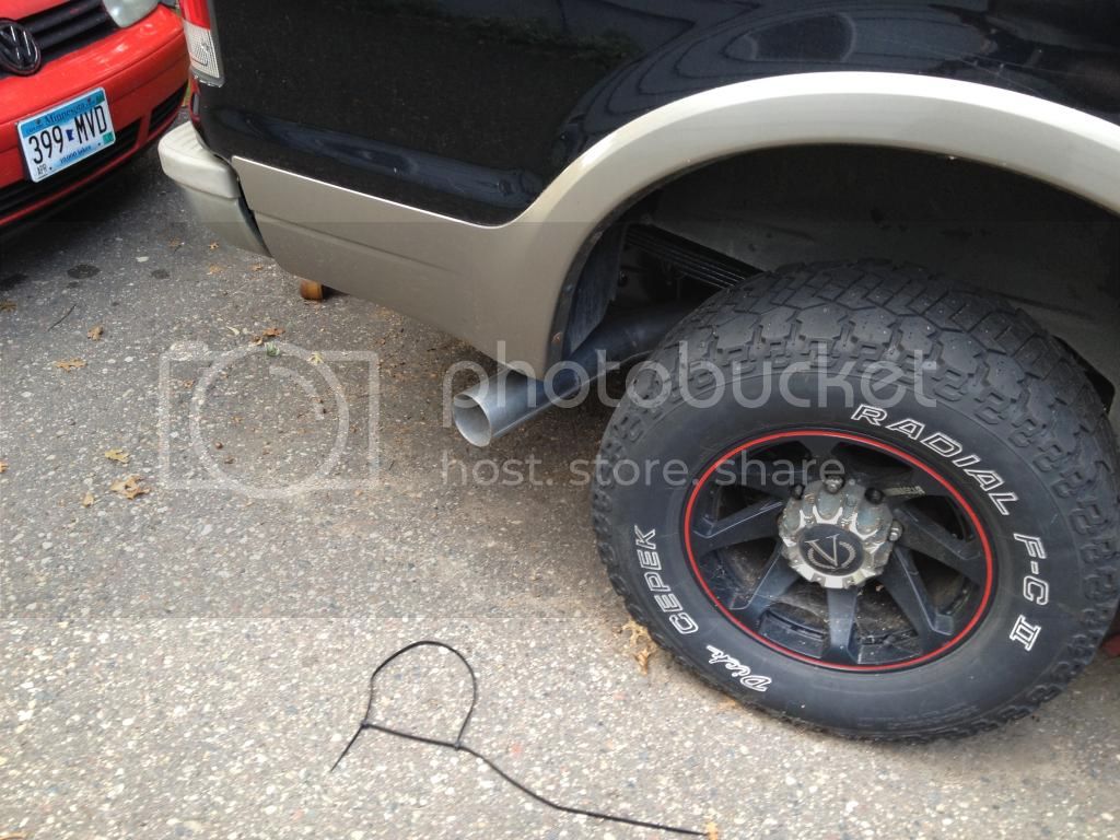

Next was exhaust, During expecting of the turbo that came with the motor the Wastegate was froze up, After trying to free it up I purchased a HE351 and CR manifold. Like man who have done this swap no, they don’t make a Downpipe to fit these trucks. I order a complete exhaust for the X from diamond Eye. To be nice it fit like crap, I spent many hrs fitting the back part that went over the axle so it wouldn’t hit the shock, gas tank etc. I’m very happy how it turned out but there was a ton of cutting and welding just on the back part. I also had to make my own downpipe that actually seemed eaiser.
I’m very picky on how exhaust exits a truck not to low, not to high, and must be level. I think I accomplished that.
This also gave me a chance to see if it runs and it does Yippy Yippy WIND BACK IN MY SAILS

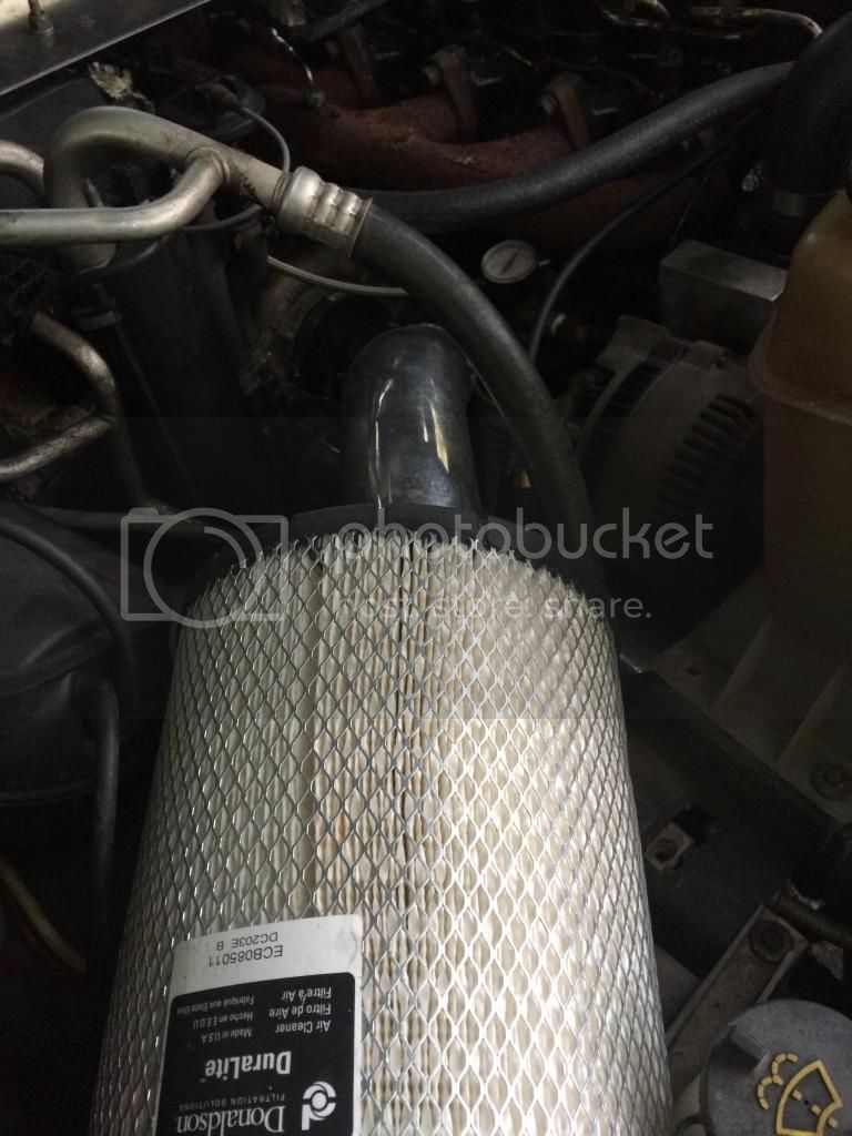

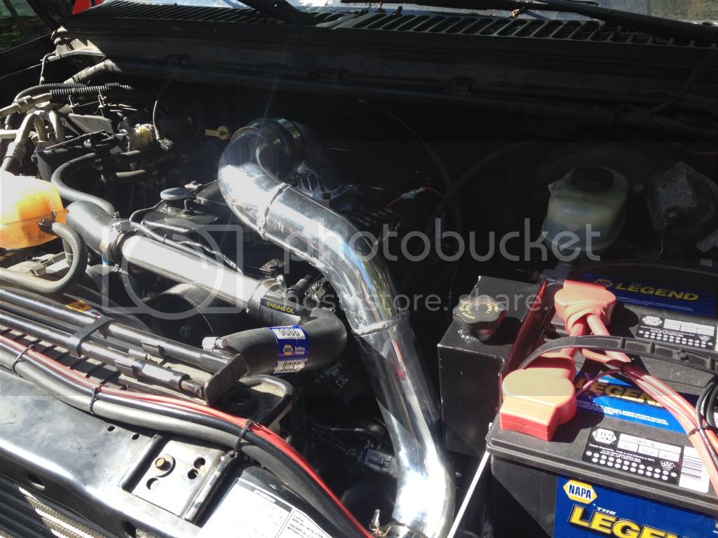

After that was intercooler piping and air filter. (getting close)

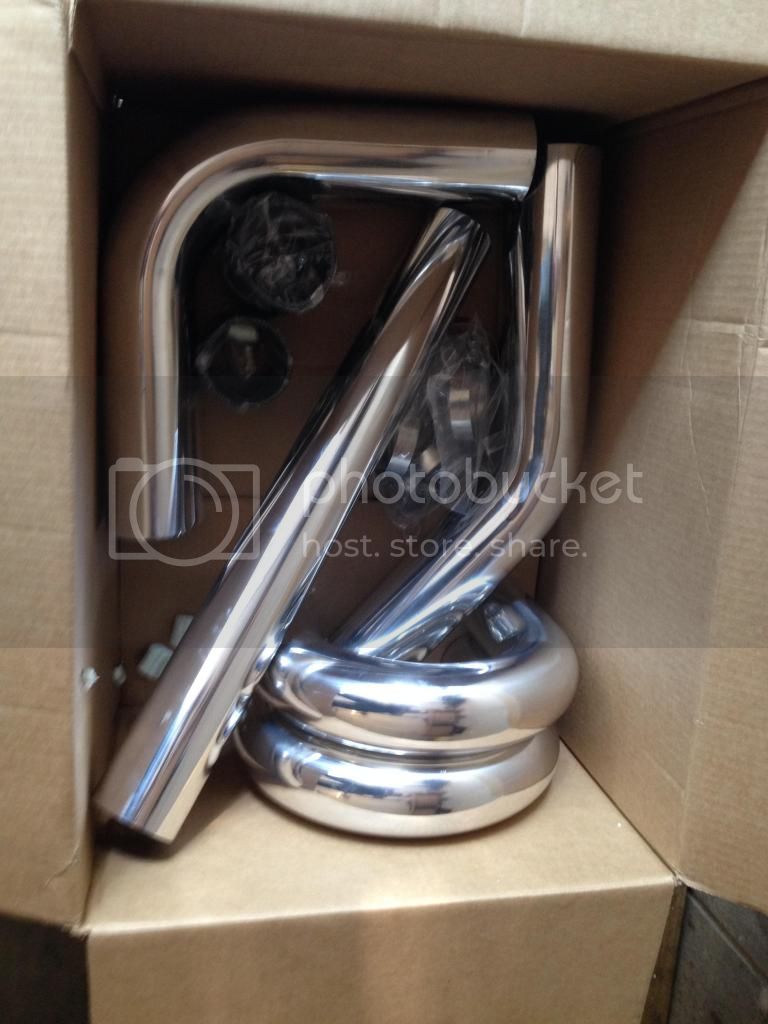

Order a pipe kit and started cutting.
Air cleaner Pipe Good ole 6637 filter

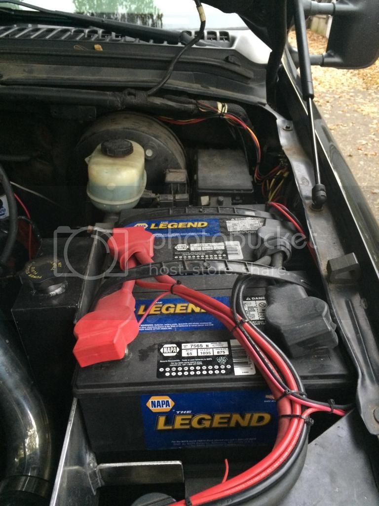

Next was onto wiring and battery. The main power was all run with 0 gauge wire. I also was able to sneak two full size batterys on the drivers side it was tight thou. You will also notice my custom PS tank I made.

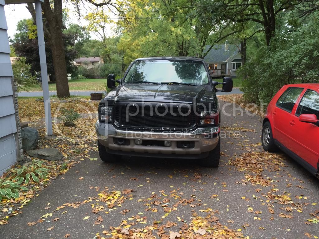

This is how the vehicle sits now. Need to paint the grill and give the truck a good buffing. I have a little over 1000 mile on it(in a week) and have average 19.6mpg. I have done zero tuning on the pump the only thing I have added was a Tork Tech OFV and 4k Springs.
I have a few little things to fix here and there like a small oil leak, and the back up alarm doesn’t work. Otherwise everything works like it should.

Turned out nice! what was the intercooler pipes made of?
Thanks I'm very happy with the truck and the wife loves it (which is the only thing that matters)lol
I bought this "kit" cut and welded my own piping together. I have done this on a bunch of different projects and it works out great. Getting better at figuring out where the cuts need to be.
http://www.siliconeintakes.com/aluminum-pipes/aluminum-pipe-p-764.html
