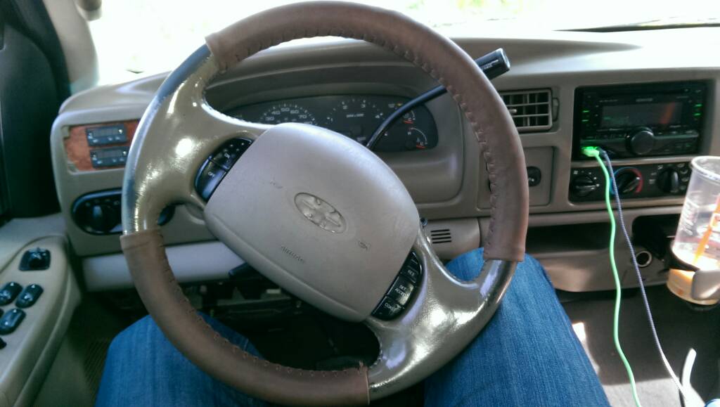

swinky
Apr 25, 2013
8,350
Eastern, Nc
Wow that's not bad at all. Thanks
Took a peek and my wheel looks decent..pics tomorrow
it goes over the existing stuff, honestly I'd do this even if my wheel was in good shape. it's super comfortable having that extra thickness.
