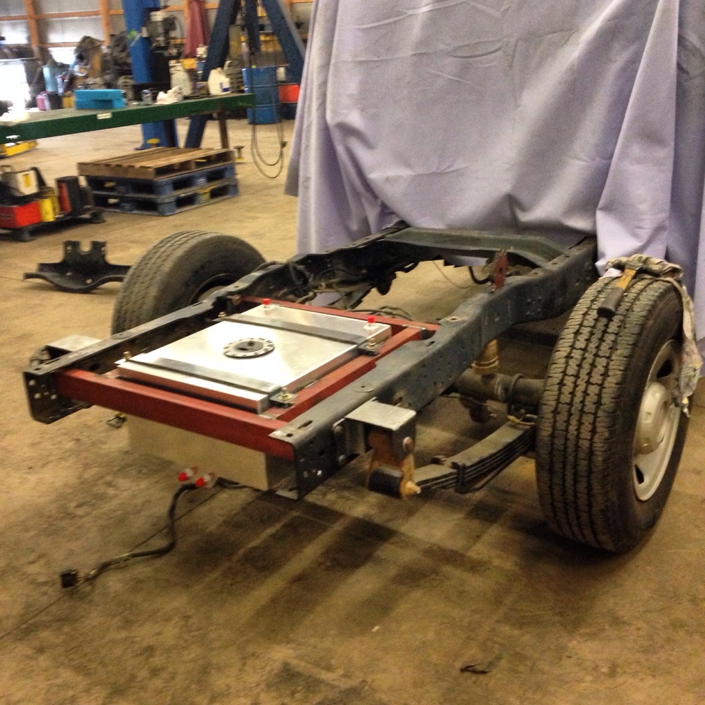

There's room for a nice 20 gal fuel cell where the spare was, but your exhaust probably won't fit.
We are kicking around ideas... May go fuel cell and nitrous bottles in bed :redspotdance:

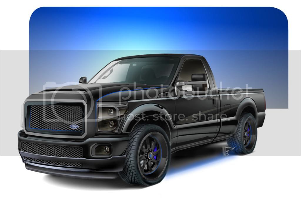

sooo i got bored at work and proceeded to draw up (a very elementary version) exactly what i want my custom console to look like....

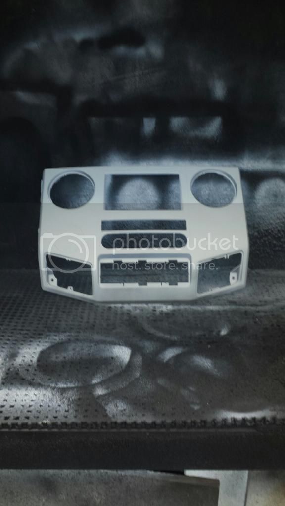

i wanted to move every control to the center... kind of "Kodiakish"...
the H&S will still be retrofitted into the panel where the light switches usually are.
As you can see on the dash trim a couple holes have already been filled.. waiting on the part from Soundman before it can be finished (Should be here Saturday), but when it does it will be tilted slightly with the bottom out and everything else filled in and smoothed out there running down to the controls.... On the drawing i orignally planned on putting a IPad mini above the Kenwood deck, but that wasnt room... So we went with kenwood up top and ipad air below....
You can see on the door trim peices where the holes have been filled in and will be sent for leather.. (i elected leather over paint to match for this.. idk why but i did... i feel like everyone paints them to match)

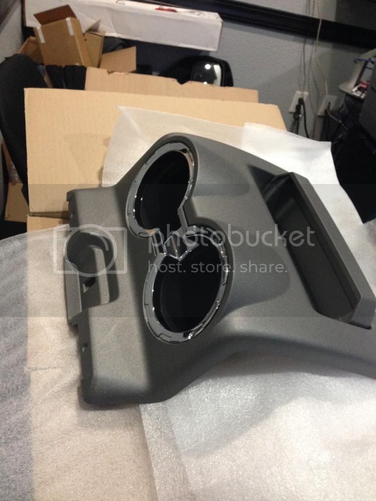

Trying to stick to the "upgraded factory look" as much as possible i got cup holders from 6.4 Harley because they match the 6.7 AC vent.
