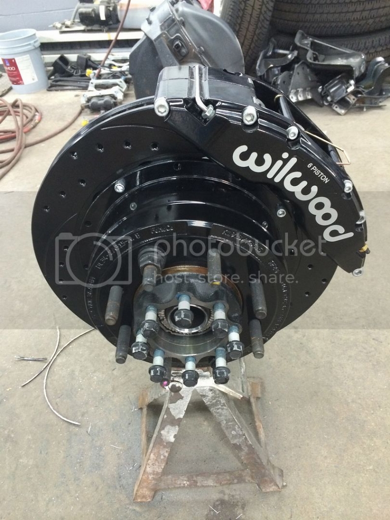

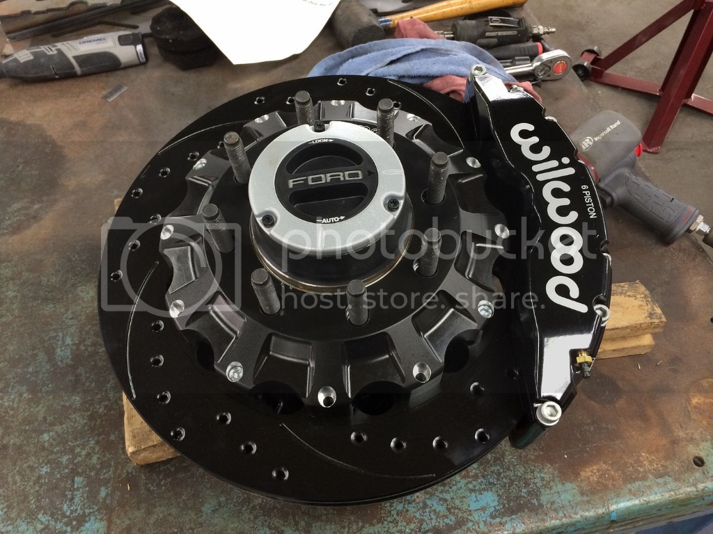

Okay off the interior for a little while, back at those wilwoods. I still can't get over the massive 16'' rotors. Like mentioned before if anyone wants these things Todd at TCE performance is the only way to go. Full blown kit with instructions and every nut and bolt needed, plus the after purchase support and knowledge is always great.

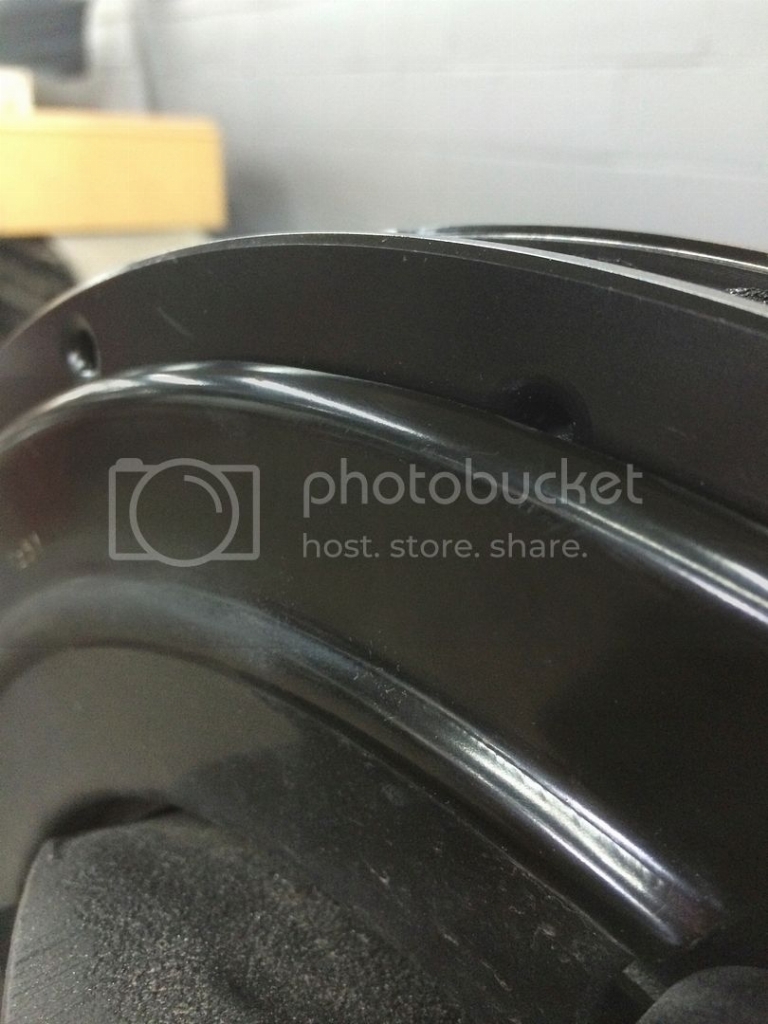

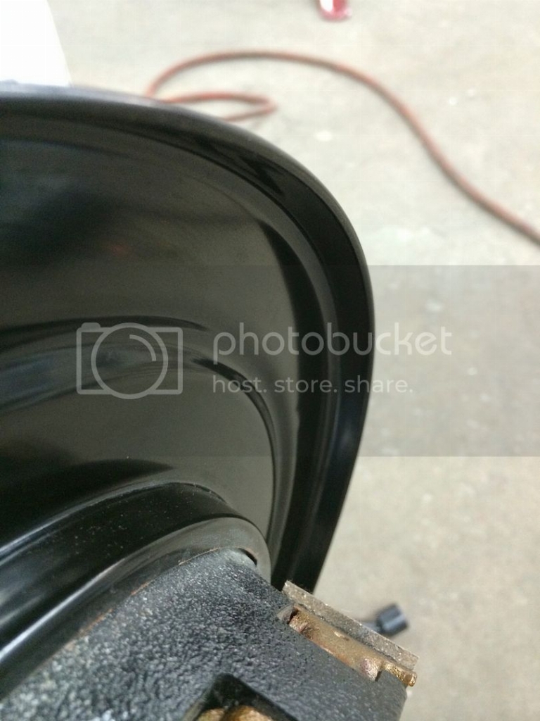

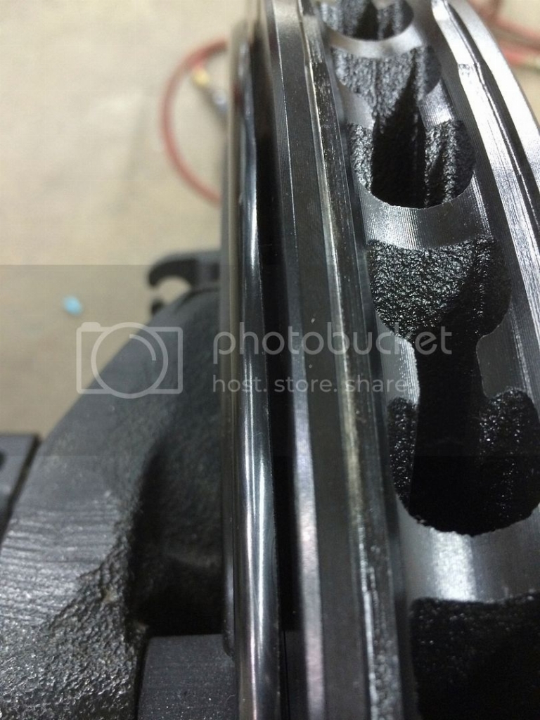

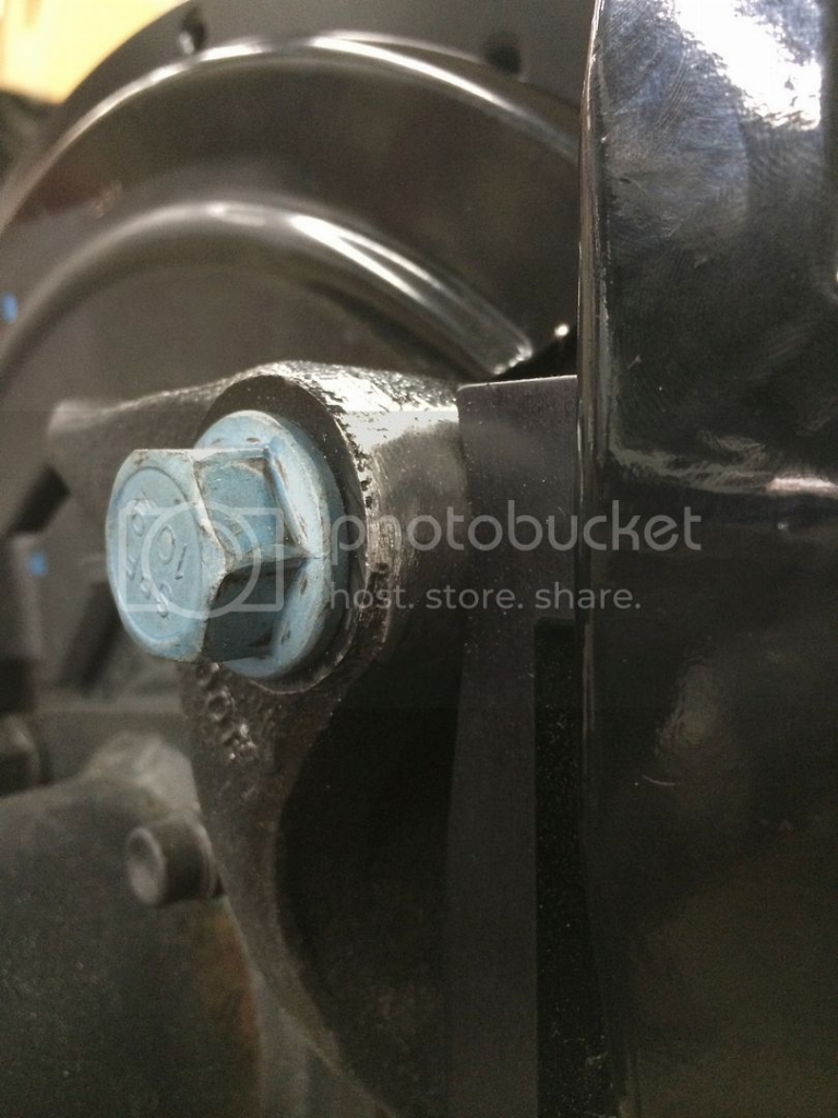

Anyway I knew there was some fitting to do with this kit, this was stated up front. You know the rotors are huge when they stick out past the dust shield about an inch, that took some good trimming and fitting. The iron mounting holes for the caliper also need to be shaped to allow room for the TCE machined radial bracket. It makes a lot more sense to trim the iron slightly than to sacrifice a lot of strength by making the aluminum bracket drop in. I'm sure this all can be done quickly, but first time and trying to make it as clean as possible takes time.
The big lip before,
After some cutting wheel and grinding action,
These front ones seemed to drop right in which was cool, not claiming this though until everything is said and done,

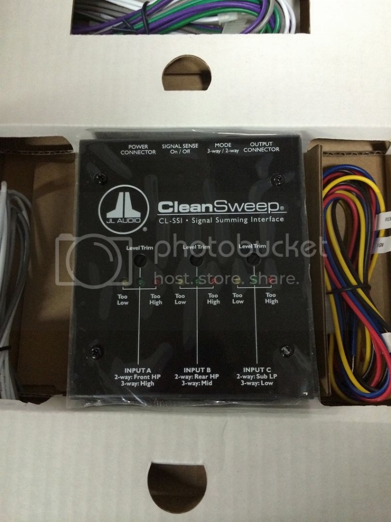

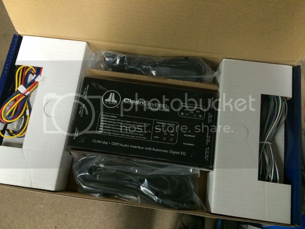

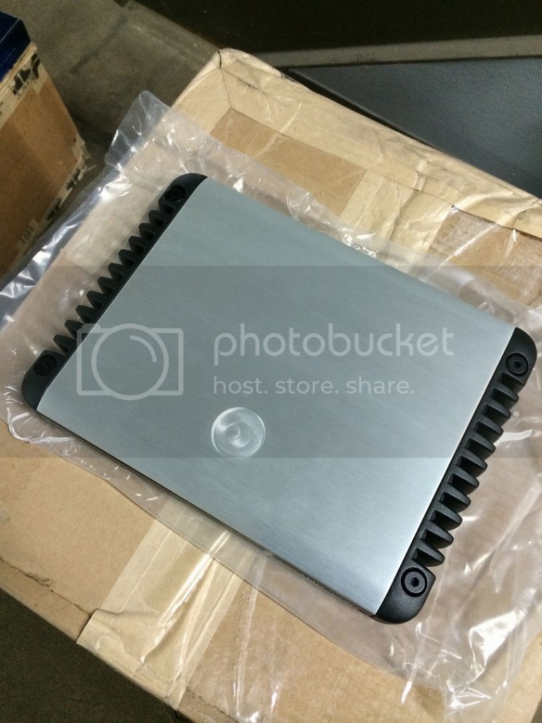

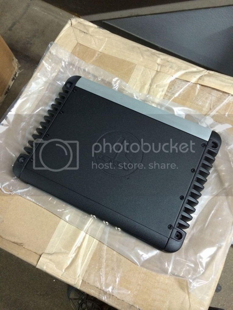

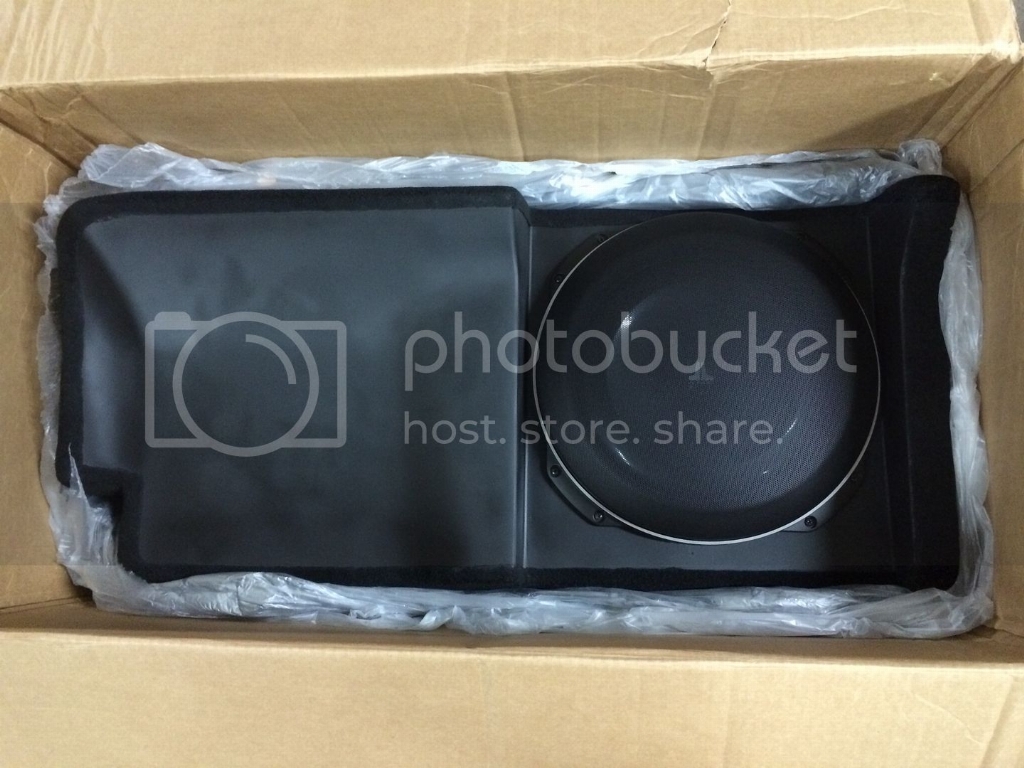

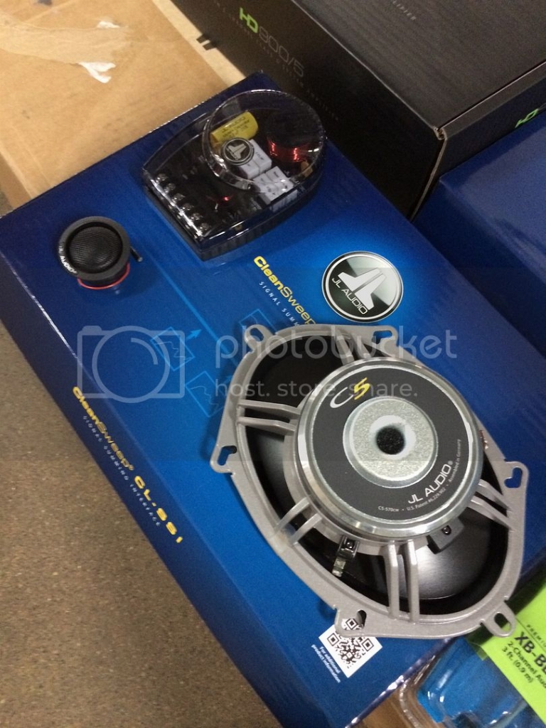

I pulled the trigger on a little bit of an audio upgrade for the truck, honestly the 13+ system is miles better than the 12- I have heard. But still it is no where near a quality aftermarket system. I'll say it right now, I am not a professional audio installer. Everything went we'll so far and there has been no surprises yet but the installation in newer vehicles with multi speaker systems is becoming rather complex.
I decided to drop in a full JL system, I've always liked their products and they had a lot of drop in options for this truck. I'll be running C5 components in the front and rear along with the JL stealthbox with a 13tw5. An HD900/5 amp will be used to power everything, these hd amps are such an upgrade from the older slash series. So small and compact, they easily fit under the seat. I chose to use cleansweep products to clean up the factory signal for a few reasons, one the processor sets up itself. I don't have the proper tools or knowledge to tune one. It was also nice to have all JL products, the processor and summing interface were meant to work together so it makes things more manageable.
