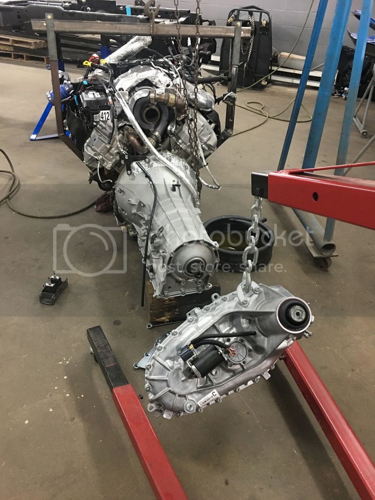

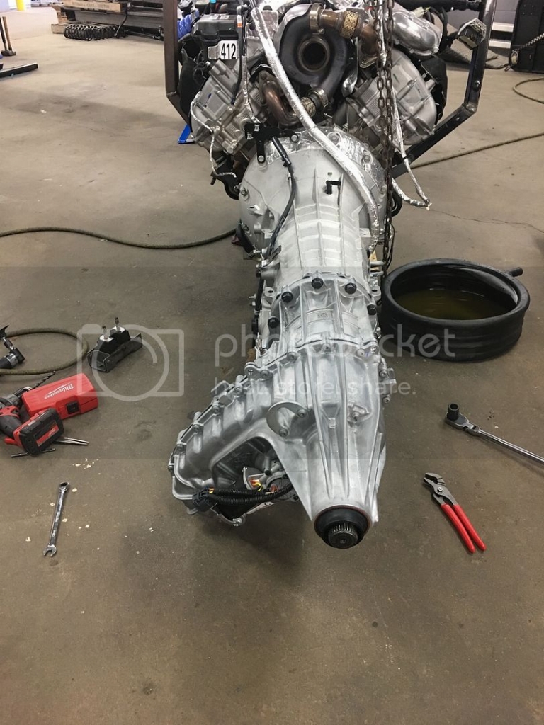

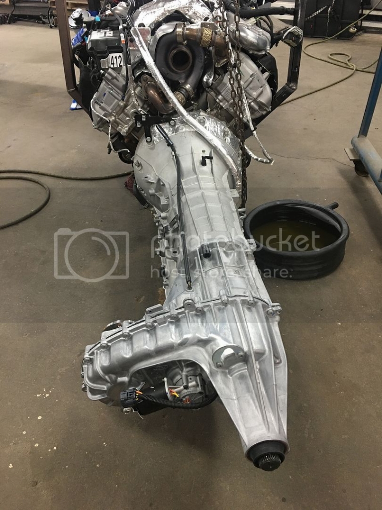

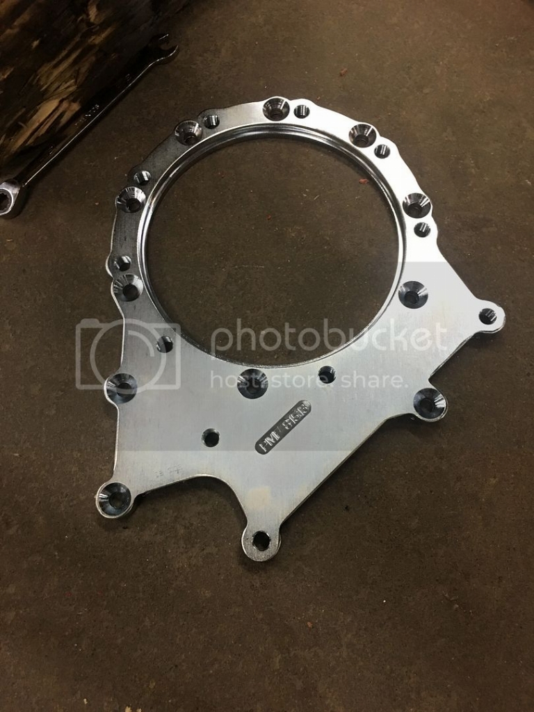

Install of the PMF Suspension transfer case index plate to decrease front driveline angles on big lifts like this truck will be seeing. Slickest thing around, clocks the case downward about 15 degrees or so, install is very easy as you can see.
Before,
The plate install between the rear of the trans and front of the transfer case, barely noticeable but a critical piece no doubt.

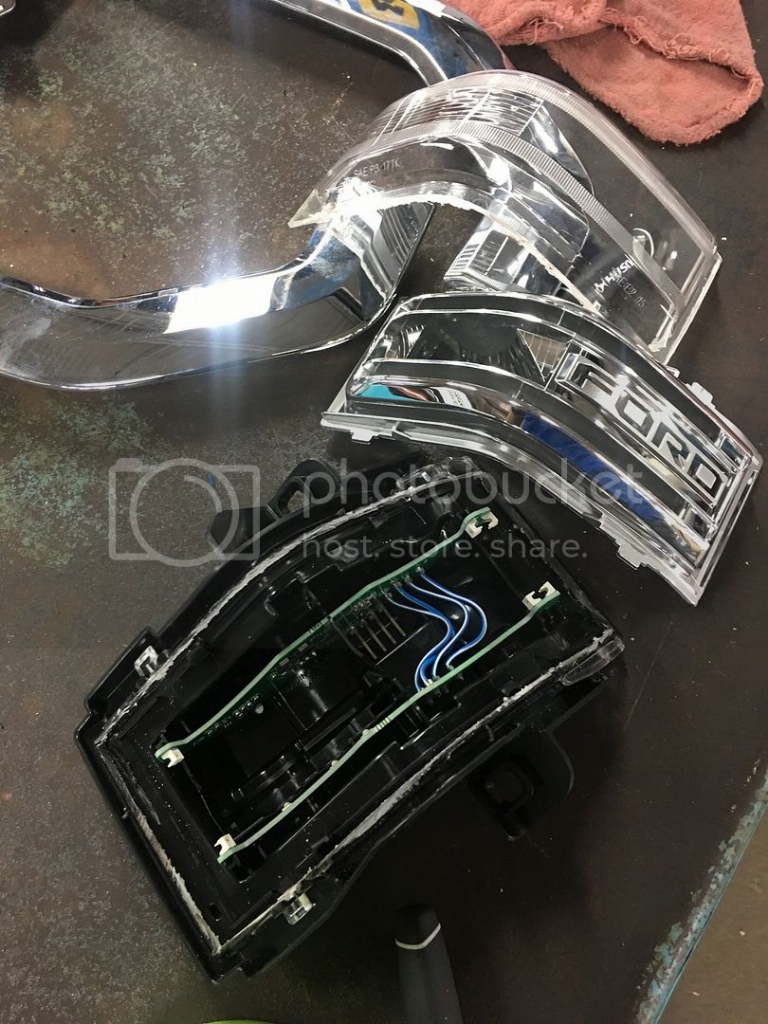

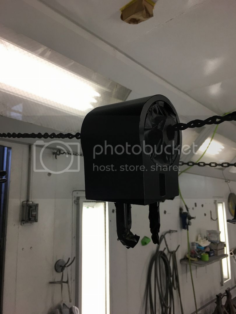

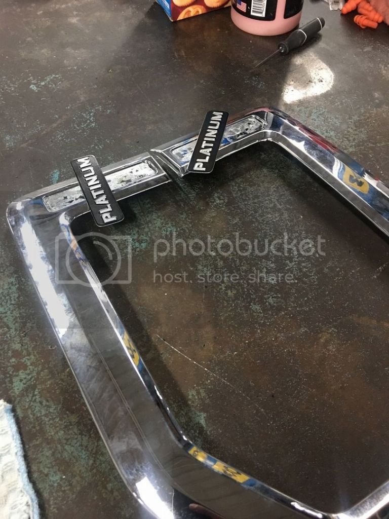

Little bit more tear down of some minor pieces, the emblems do come completely apart. I opted to open up the side marker mirror lights and will be painting just the guts as the lens is clear. They should look pretty cool, rather then just smoked!

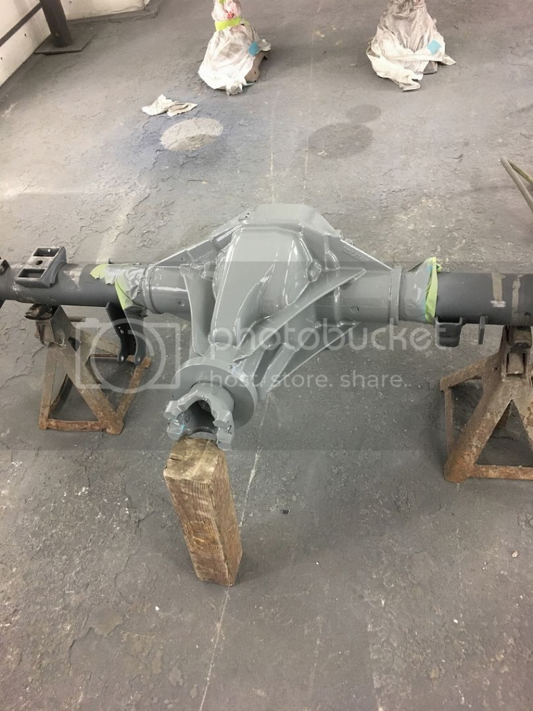

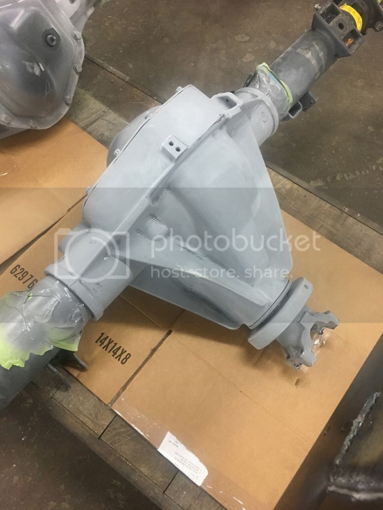

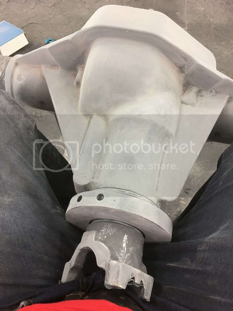

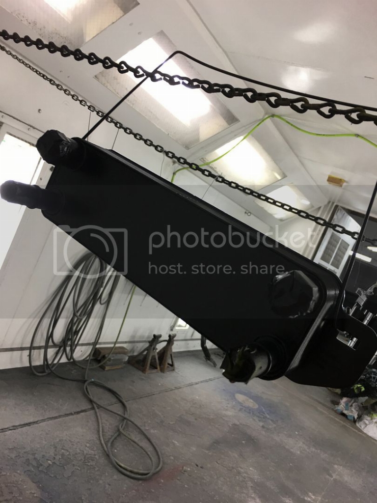

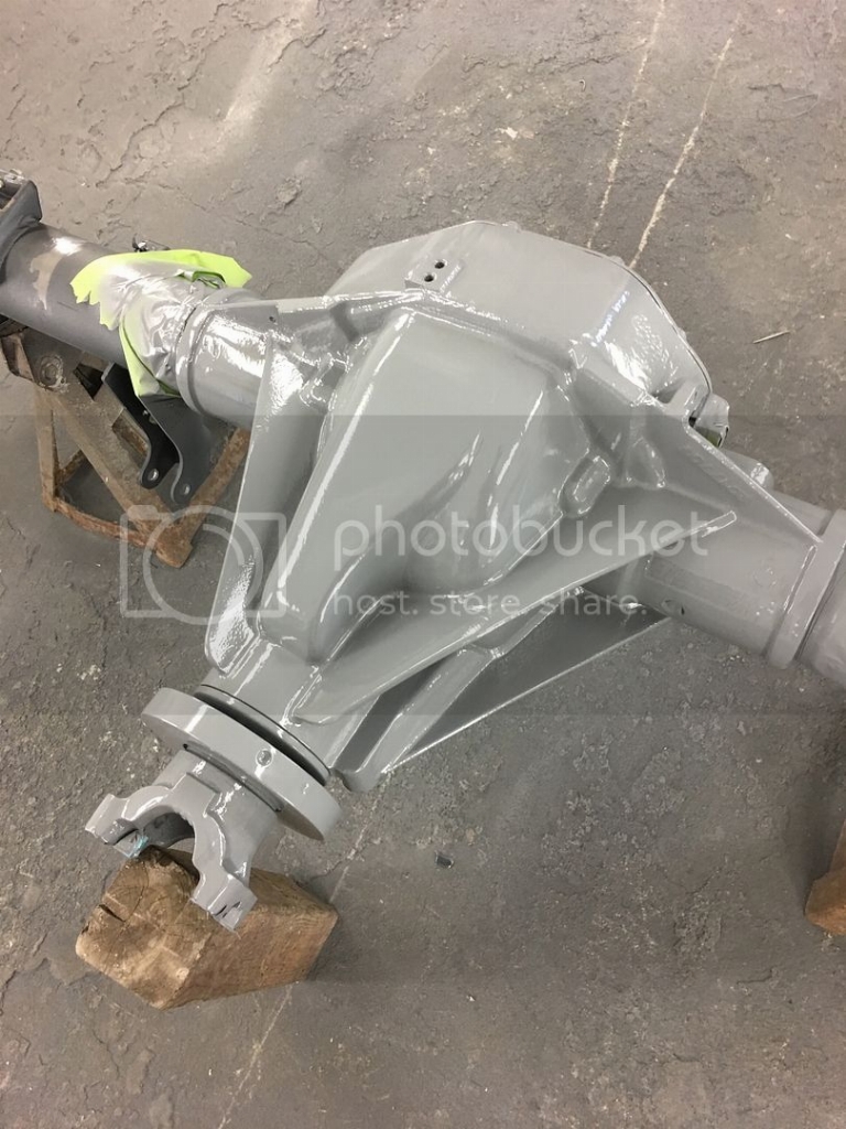

Little bit more diff action, primed up about a 1/4'' thick lol. Then sanded down nice and smooth, ready to fit the trusses now.

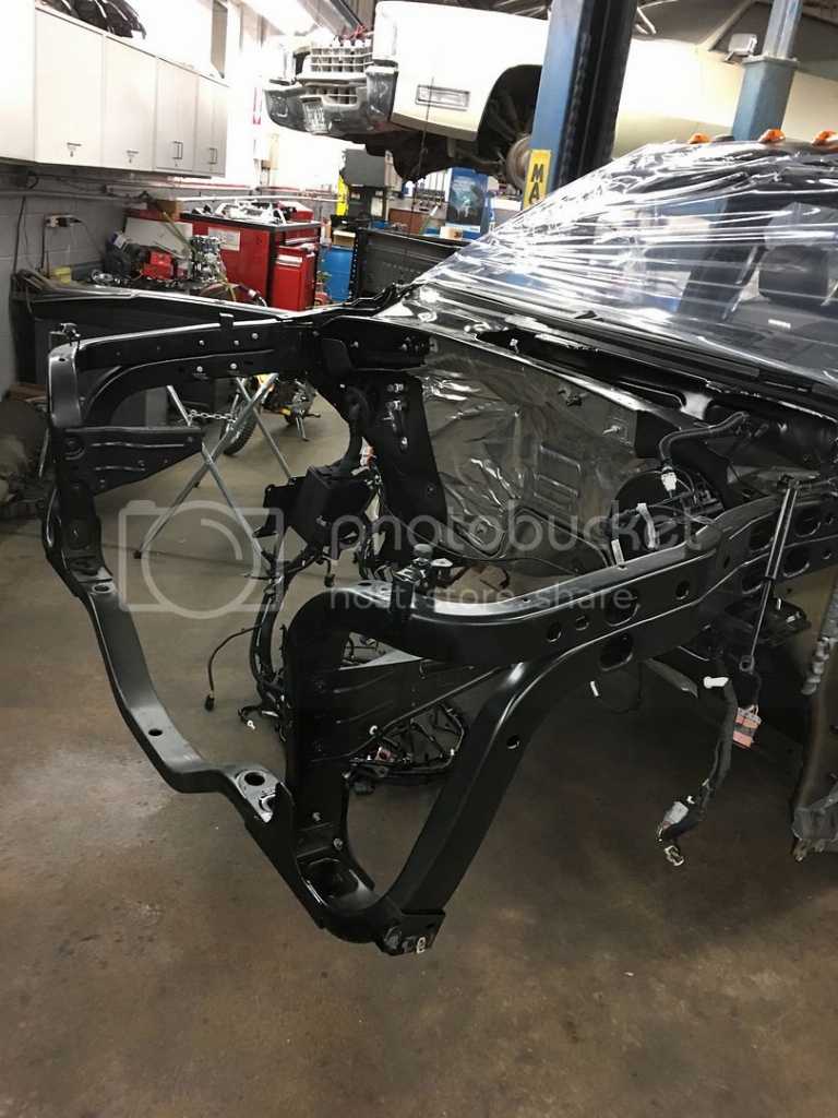

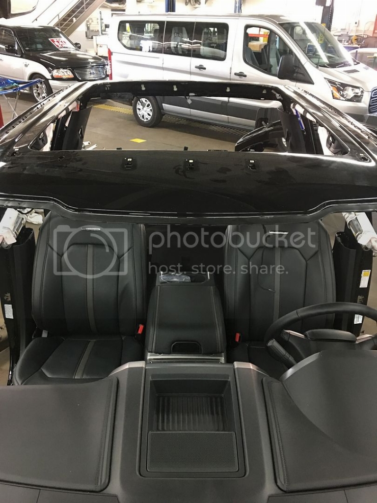

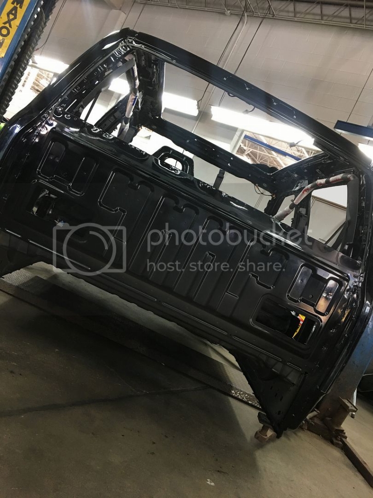

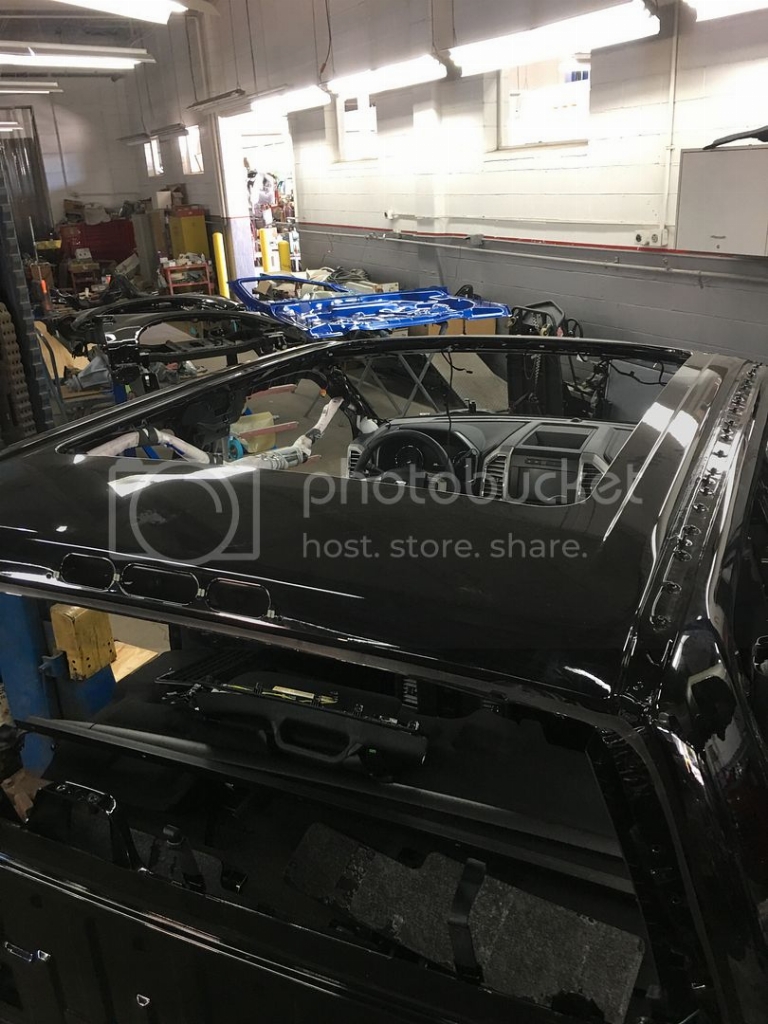

Tackled the cab next, getting it ready to be painted hopefully late this week. Engine compartment fuse block, modules and main harness was removed. Cowling, head liner and that huge sunroof as well. The cab is almost ready to be scuffed and sprayed.
Just about a week ago it looked like this! :doh:

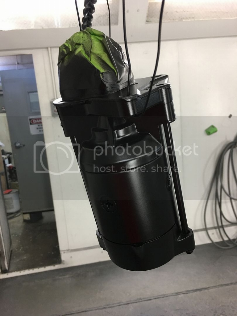

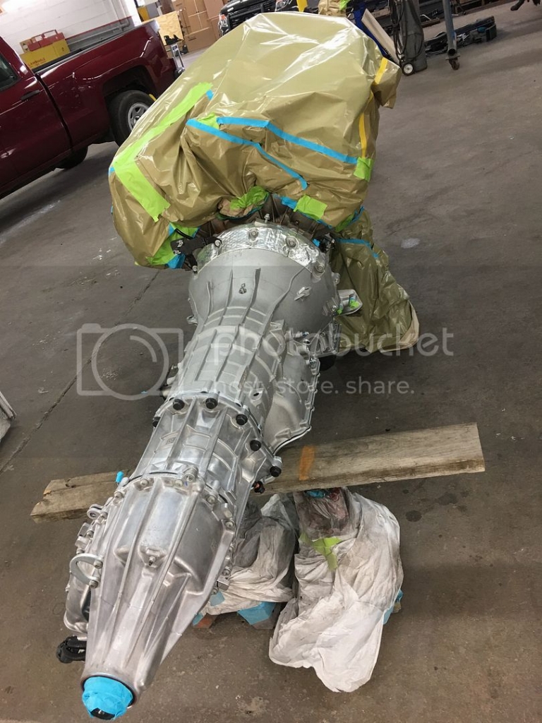

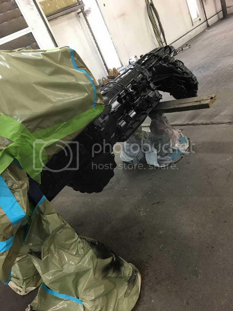

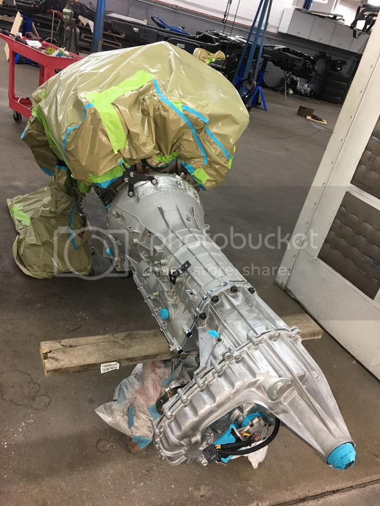

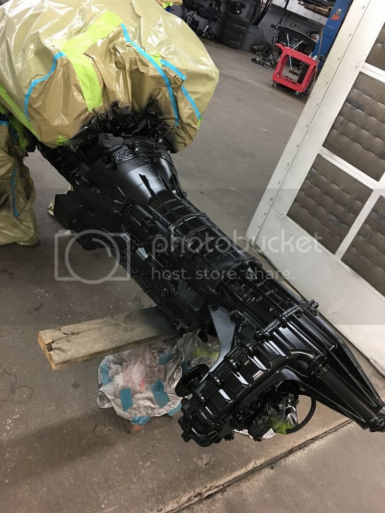

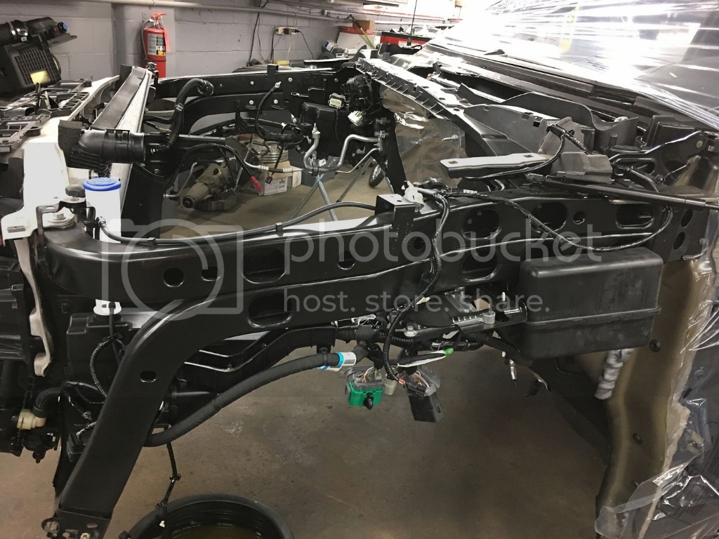

The engine and transmission were up next. Nothing crazy, just satin black to keep back the rust and make everything look uniform underneath when the truck is all assembled. Taping took forever, starter, some of the wire harness, and some cooling lines were removed and painted separately. Already all assembled,
