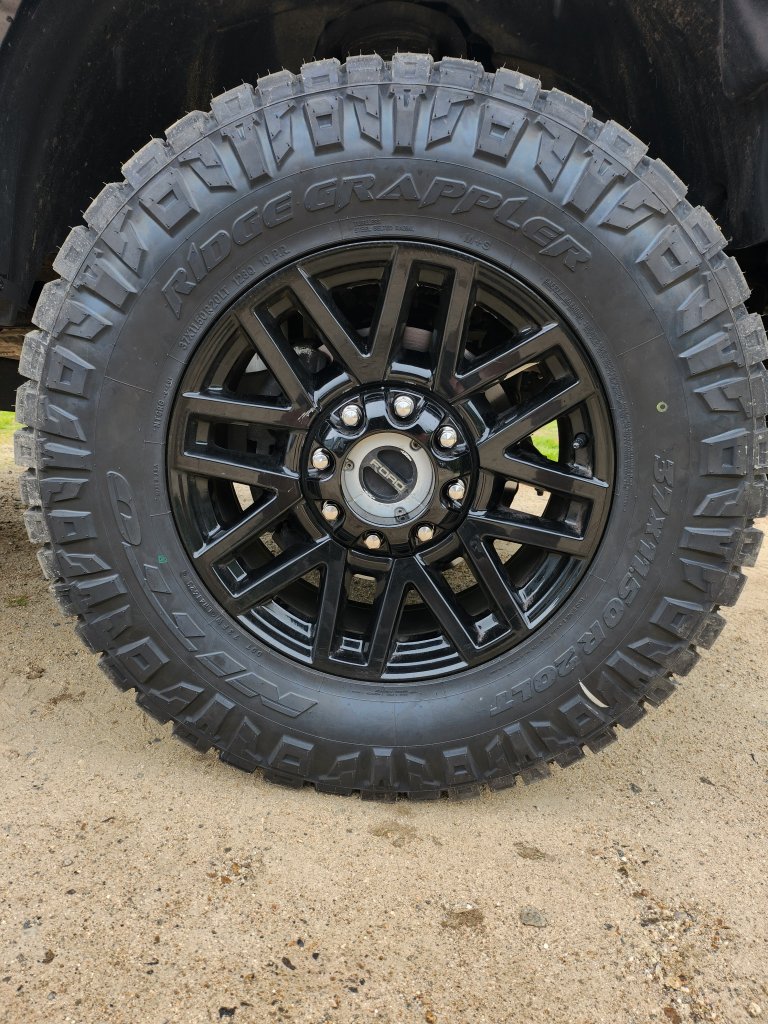

Ordered a set of 37x11.5R20 Nitto Ridge Grapplers.
Sent from my SM-F721U using Tapatalk
ToMang07
Jan 25, 2012
6,567
181
Mainah!

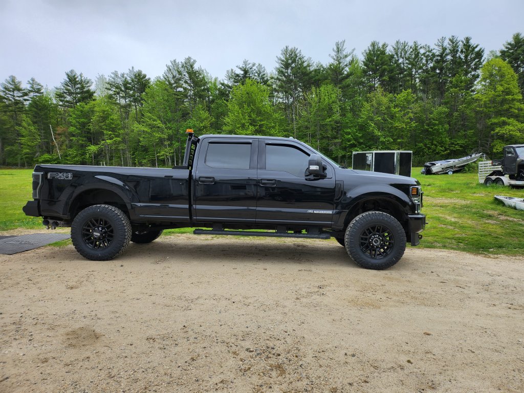

Well, got them mounted this morning, made it 10 miles and turned around and went back, wicked vibration at 35-60.
Something tells me this is gonna be a long ass day.

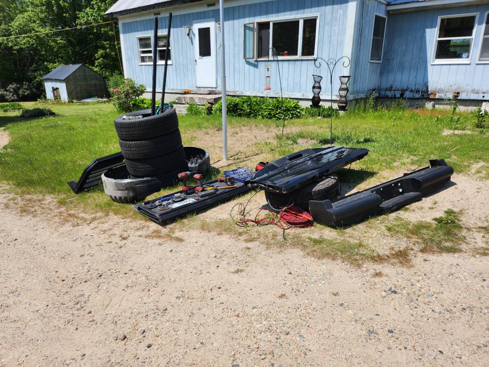

ToMang07
Jan 25, 2012
6,567
181
Mainah!
Black AOD
Aug 6, 2014
3,466
76
Ohio
They’re either bad tires (one of them at least) or need road forced Balanced would be my guess
ToMang07
Jan 25, 2012
6,567
181
Mainah!
I agree. They balanced them again, couldn't get them right, then added 8oz of beads. Still vibrate, but not as bad, but ran out of day. ****in irritating.
RascalMafia
#hashtag
Moderator
Feb 11, 2013
216
28
Middle GA
Road Force balancing is the ticket. I fought balance issues for way too long, even got new tires. Problem persisted. I swore it was the driveshaft. Road force balance, problem solved.

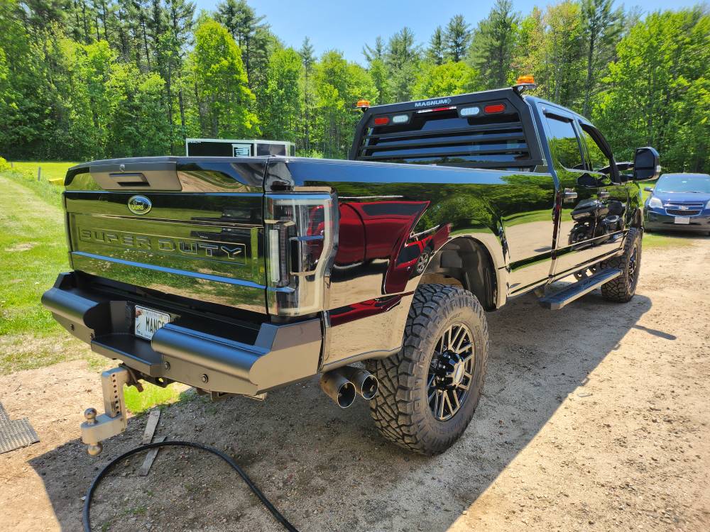

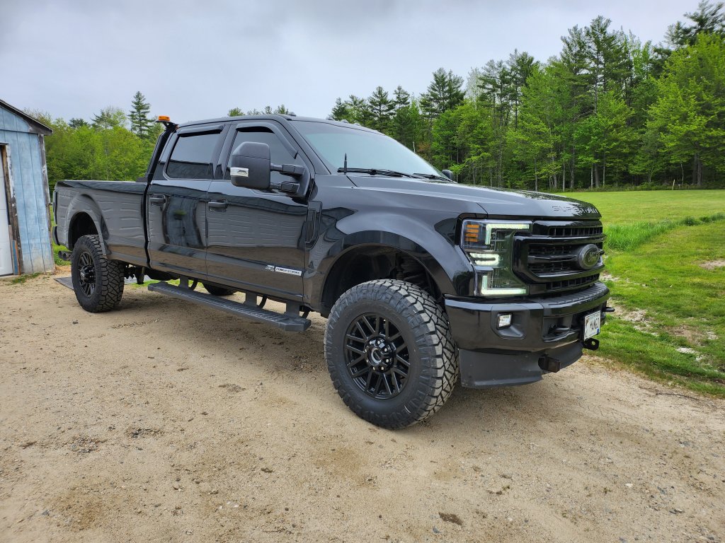

Much, much better. New bumper came in and is thankfully even. Did a claybar on the bed and washed/ceramic-waxed the rest. She looks better than new!

Got the tires replaced under warranty, no more vibration thank God.
