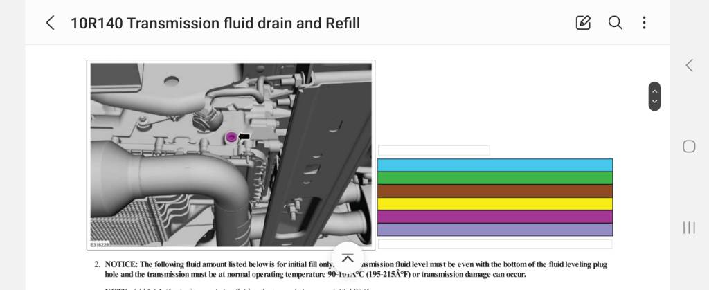

According to Ford, there is not a dipstick there. There is a service dipstick you put in that hole, but it is not mounted or stored there. View attachment 187200

I can’t read what you attached, but that’s odd. Really stupid if you ask me. All the manufacturers have gone away from conventional dipsticks, as most people are ****ing retarded and put the incorrect shit in, but ford has always had the short little dipstick in the plug since like 2008 with the 6r80. Weird they have now removed the dipstick. Probably saves them $.40 per truck and they tack on an extra $100-200 somewhere to further the profit…

That’s dumb. So it’s got a fill plug like a diff and you fill until it runs out from the driver side using a pump bottle.

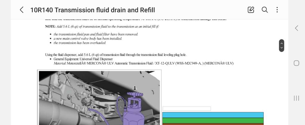

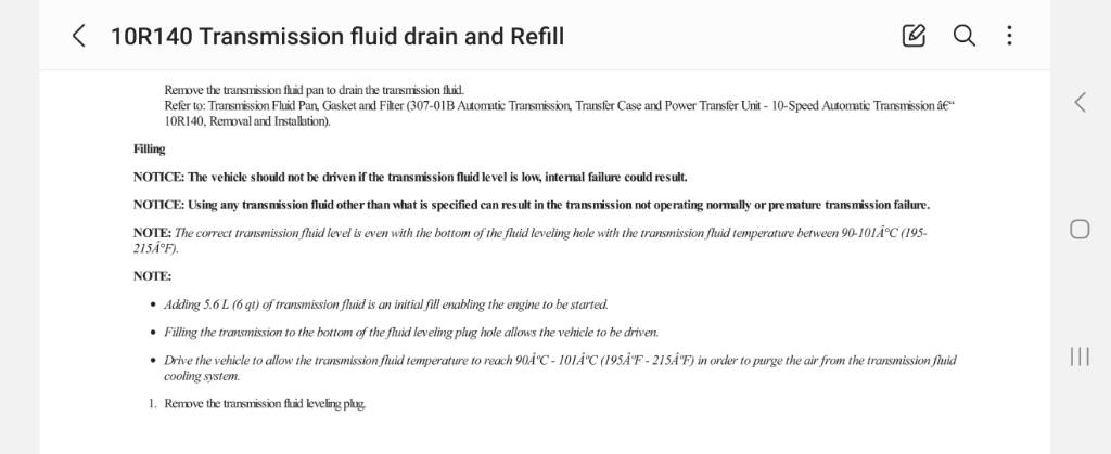

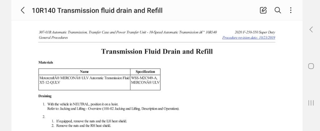

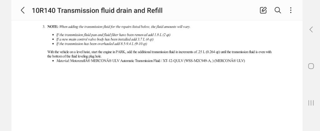

Not the whole thing, but yeah. Pretty much.
