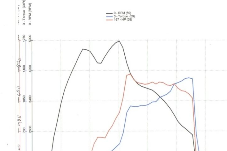

910s will be more than good at your desired level. This dyno graph was a 7.3 no head or cam work just 910s and pushrods ImageUploadedByTapatalk1391687906.188923.jpg

910s will be more than good at your desired level. This dyno graph was a 7.3 no head or cam work just 910s and pushrods View attachment 25739
by chance got a stock graph to compare it too? this ones all over the place shoulnt it be more arched
ken6881
Oct 8, 2012
429
It's an engine dyno so it won't look like a chassis dyno graph. Black line is rpm red hp and blue torque. Also you have to look at each scaling on the left for each individual one. And no it's not my motor so I don't have any other graphs to compare it to but with 910s it was making over 750hp. And spinning it 4k once they got it loaded. The graph looks a little odd because they let it spin up then pulled it back down with the dyno.
i gotcha now! sorry a lil slow and never deal with just engine dyno sheets and thanks!

No problem it's all a learning experience. FYI that was a 2.6 pulling truck motor with 400/400 injectors
how much hp/TQ was it pushin?
ken6881
Oct 8, 2012
429
Not to be a smart ass but look at the graph. And it's not my motor I pulled that graph off of this site. You may know the pulling truck lonestroke (I think is its name). He said it was probably making another 100 hp with a water to air intercooler he had in it when it was in the truck. Graph is with stock intercooler.
