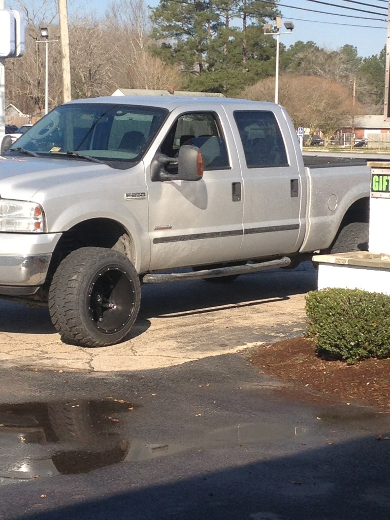

Ya I'm guessing the spacer makes the inner part of the tire rub the fender when he turns.

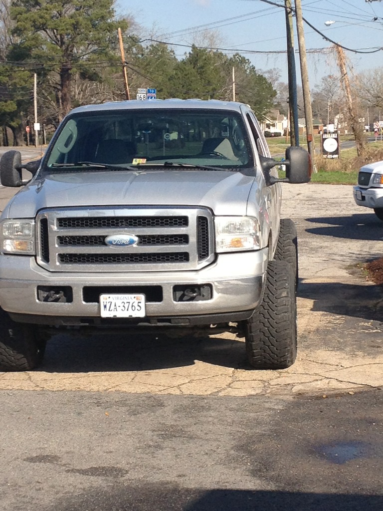

Any modifications done to fit that without rubbing? Or does it rub?
Well it's on an 05 so it's tough to compare. Similar but seems like you 6.4 dudes have a little more clearance. But either way just minor trimming on the fenders. Still rubs the liners a tiny but that doesn't bother me. And I'd rather not cut them all up

ordered some 20x12s thru my local tire shop. get a phone call 5 mins later, "you know that rim alone is gonna stick out 4" past your truck" me "thats fine". phones me again 5 mins later, "you know its gonna require custom work to get that to clear right?". me "it wont but thats fine".

It will work or you could do this but it would be a inch narrower on each side.
20x14s with a leveling kit. 33x12.50s
