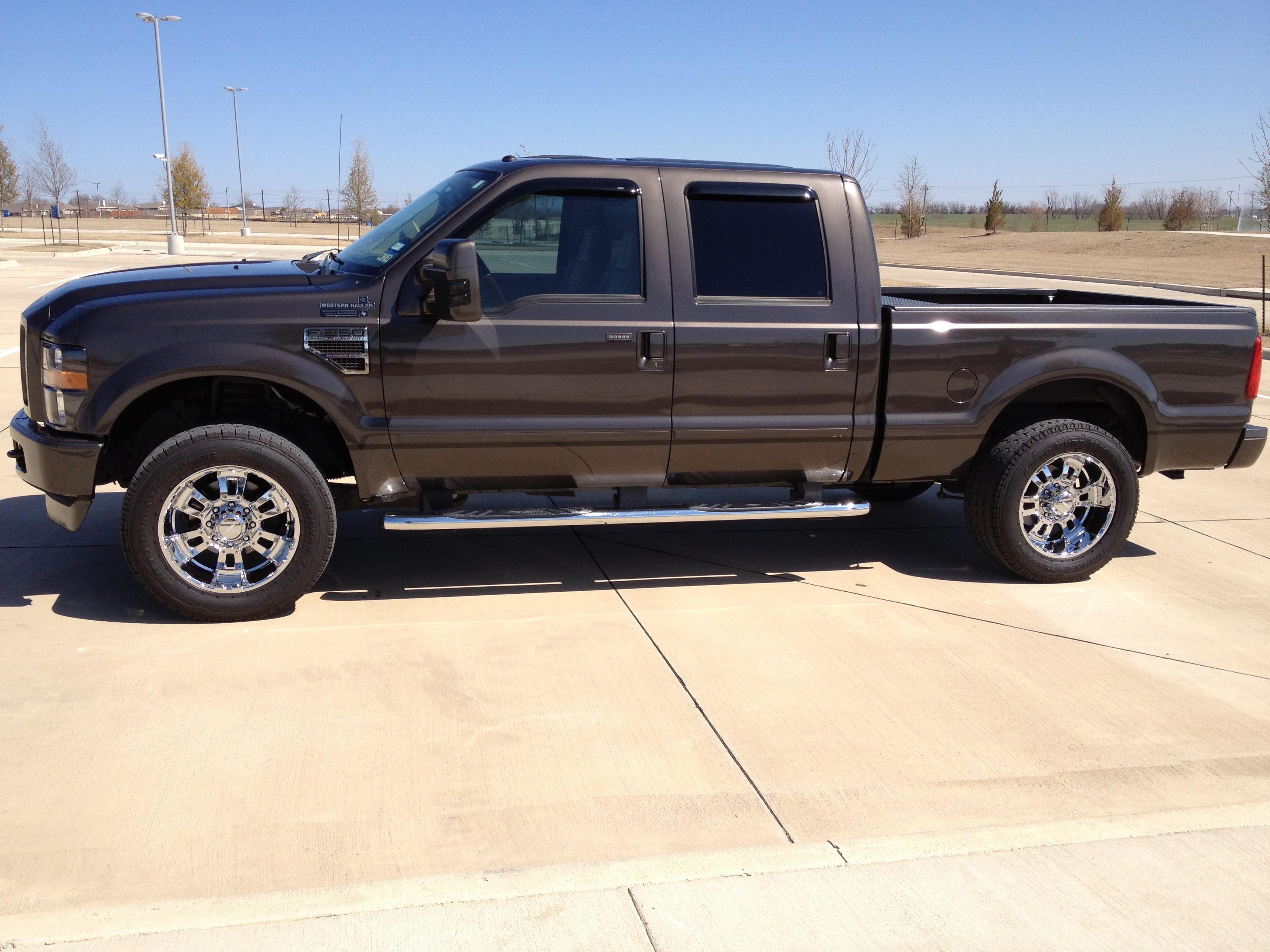

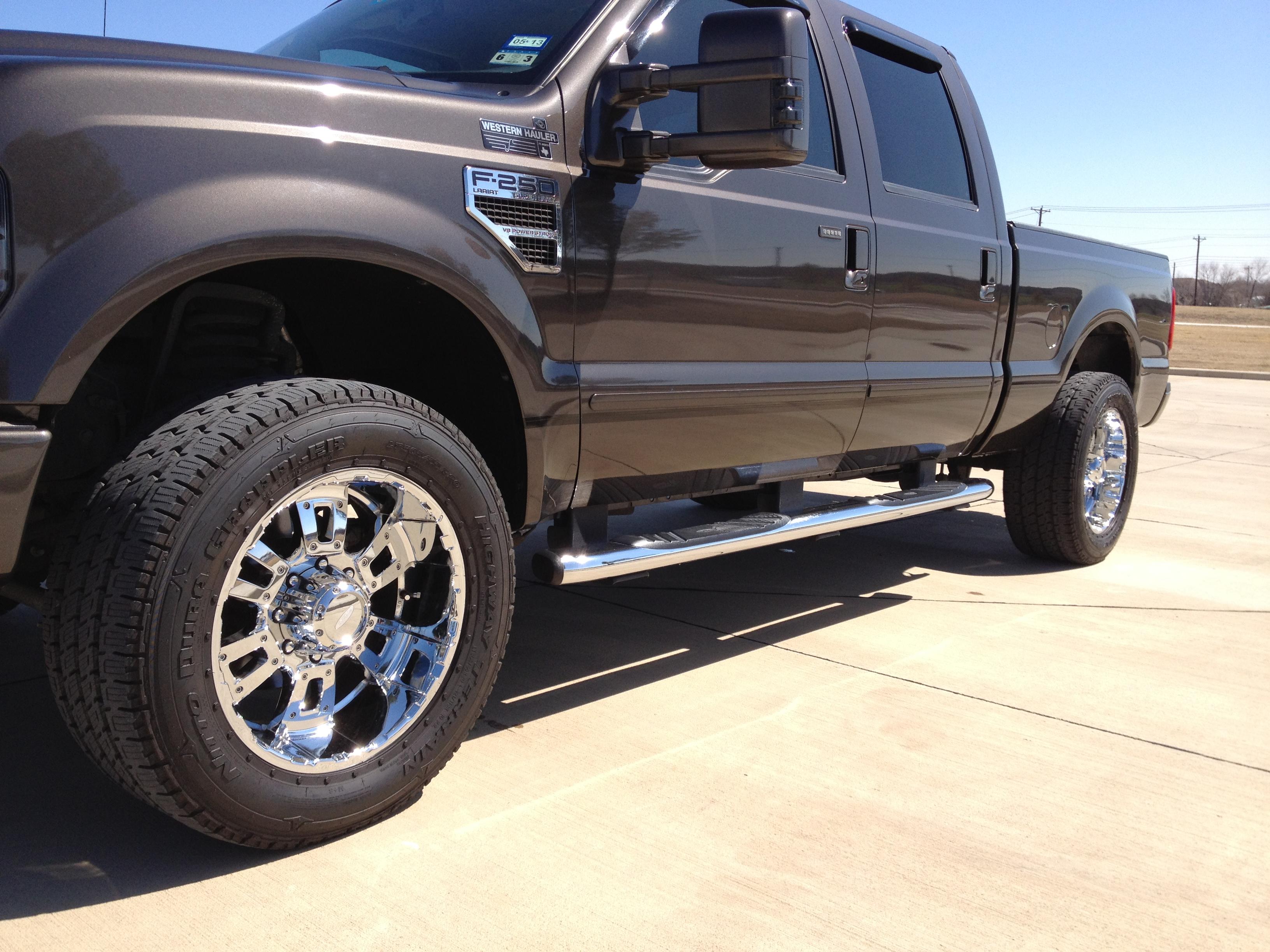

Can't decide on 20x10 or 20x12 American Force Independence SS on stock suspension...
I currently have Diamo 17 Karat 20x10 with -12 offset and zero rubbing, but I'd like to swap to the American Force Independence SS with -25 offset (20x10) or -40 offset (20x12) rub? I really don't want to mess with the stock suspension... Thoughts?

I'm currently running 305/55/20 Nitto Dura Grapplers, which I think is a 33" tire. So, it sounds like I'd have to trim the fender well to stay at stock height... I'm cool with that. Thanks for the reply!
