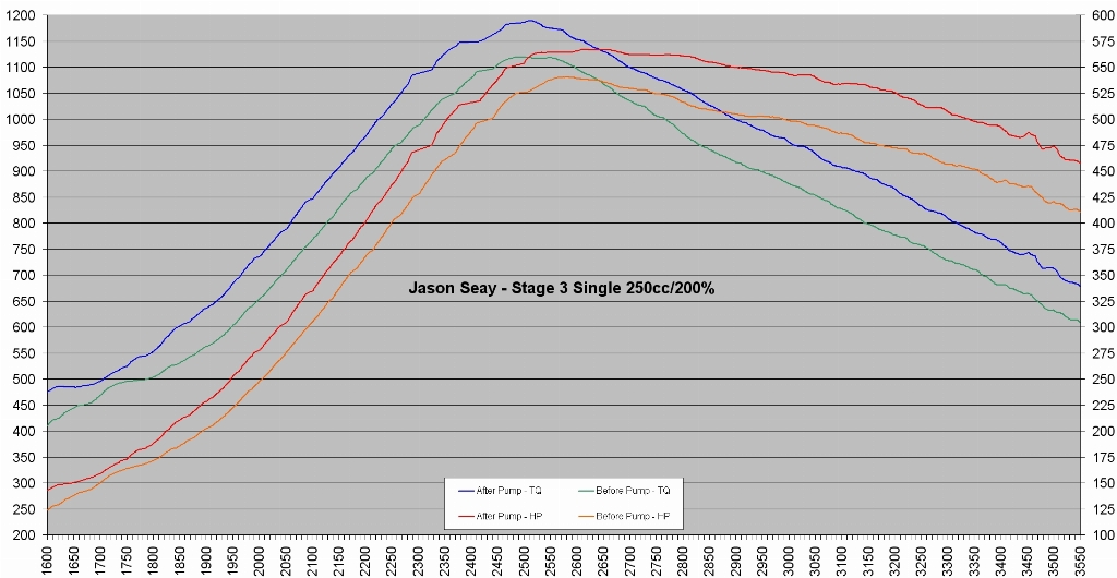

Bill, nice job on what you have shown here. I do have one question I would love to hear your side on. Why is the peak at 2650? What after all this time do you feel the reason for the limited RPMs is??? DO you forsee anyway to break this long standing barrier? I have seen first hand some of the hold ups on the injection side. What can you share with us on the tuning side??

Was that before or.after the fuel pump upgrade?

It was after while the TQ peak seems in normal range @2500 the HP peak was only 100rpms high in the 2600s. Just from what I have seen from other dyno runs I would have expected to see a 3000 rpm peak for HP +/-100 rpms.
Could it be from maxing out the turbo already and maybe bring fuel in a little slower would have broadened the HP curve and taken the peak up in the rpm band? I am guess at this. I could just be a tuning preference as well :shrug:
Here is the dyno graphs of the various run before and after the pump was added. It looks like you could change the fueling to bring it up slower but then have it in turn fall off a bit quicker as you only have so much PW and fuel in it.

A 200% nozzle can move 238cc of fuel in 2.25ms of pulse width(3200psi ICP). 2.25 ms/pw is allowable by the IDM at 4800 RPM.
Thats what raises why curiousity. If fueling is there, what on the tuning side can help open up some RPM???

Maybe im missing something by replying while not reading the entire thread-- In this dyno graph above it shows over 550hp. You are making that Lowdown on your truck? Thought this sucker had pmrs?
That is just the electronic limit set by the IDM as you can not have signal overlap. That does not mean you have than much crank angle window time to injector the fuel in. Electric vs mechanical limits.
