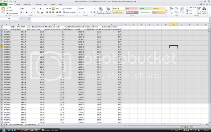

WOT run. Just a quick burst up into 3rd. But my EGTs hit 1400 in about 200mtrs
so I backed off.

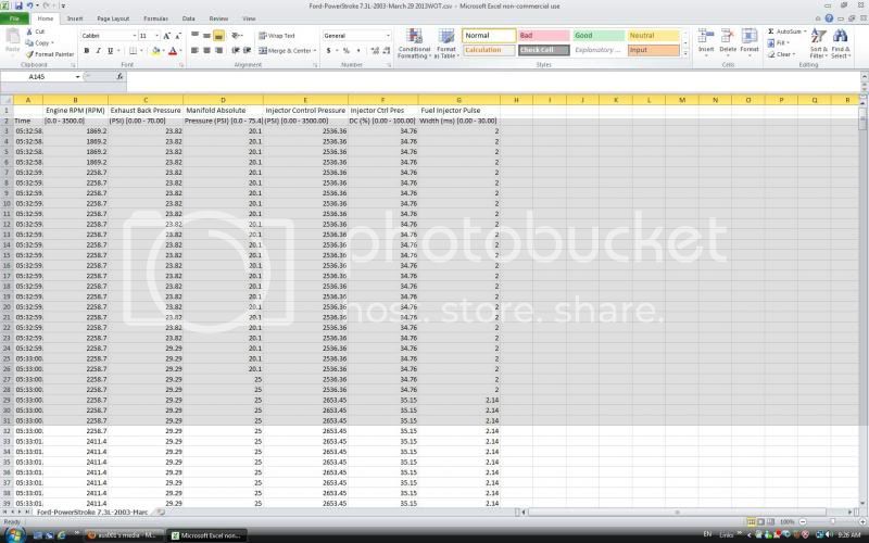

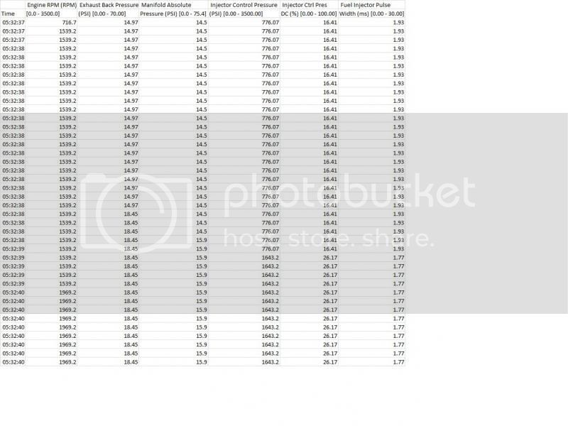

I didn't look but a quick glance, if you're running 1600 or so psi ICP at WOT.... bingo.... problemo... Big one.
I didn't even check to see if you had MFD logged.
On Edit:
Alright, I didn't see MFD, but if your WOT pull only got up to 2100 and change ICP at higher rpm, then you're not making good pressure at all. That's not even in the ballpark.
It looks like it's maxing the upper duty cycle limit Matt set at 30.47%, so it's asking for it.
You have an oil leak maybe. If it's idling like crap, then you may be driving around with a blown injector O-ring, or poppet seal issue and not even know it. It should idle like stock unless Matt wrote you something special.
You might want to do an oil pressure test. I suspect you have a blown o-ring, or an armature hitting.
I would say run a contribution, but that's highly useless most times with larger than stock nozzles. Maybe check change in rotational velocity from cylinder 1 through 8 to try and narrow down the ass hole.

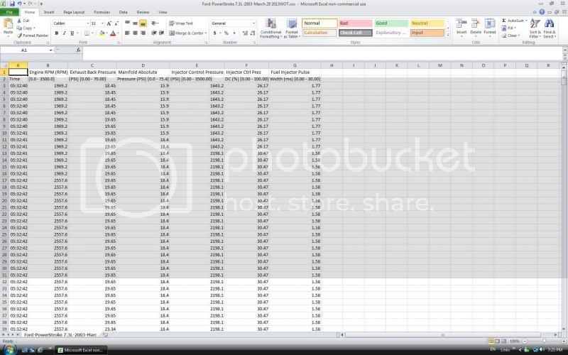

1.6ms of pulsewidth means it isnt calling for full fuel if it was at wot. And the map sensor is only seeing 5lbs of boost.

I live in a valley and its a steep climb out. I started the recording from first gear, got up to third but like I said I had to pull up once I hit 1400 egts.
Hears some more. Higher up in the rev range.

Im listening to what you are saying Charles, But would those figures explain why one minute Im pushing 400 at the wheels and the next Im down to 15lbs of boost and Egts that I have never seen in the 4 yrs I have had the truck. Besides the leak test, all I have done is taken the turbo off and put in the WW2 and I have ended up with this.
What you are suggesting is maybe why Im not seeing 500hp, but to end up in this situation. Man I dont know ???

Still looks like you are down on both PW and ICP if that was a high load situation.
Could it be that the heat is from operating the turbo out of its map(under)?

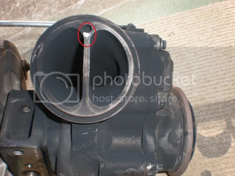

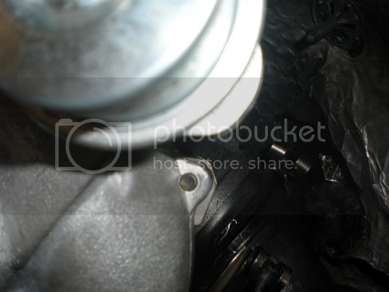

well looks can be deceiving. You can see where the locating dowel was sitting against the back of the turbo. The rear of the turbo is covered on soot.
