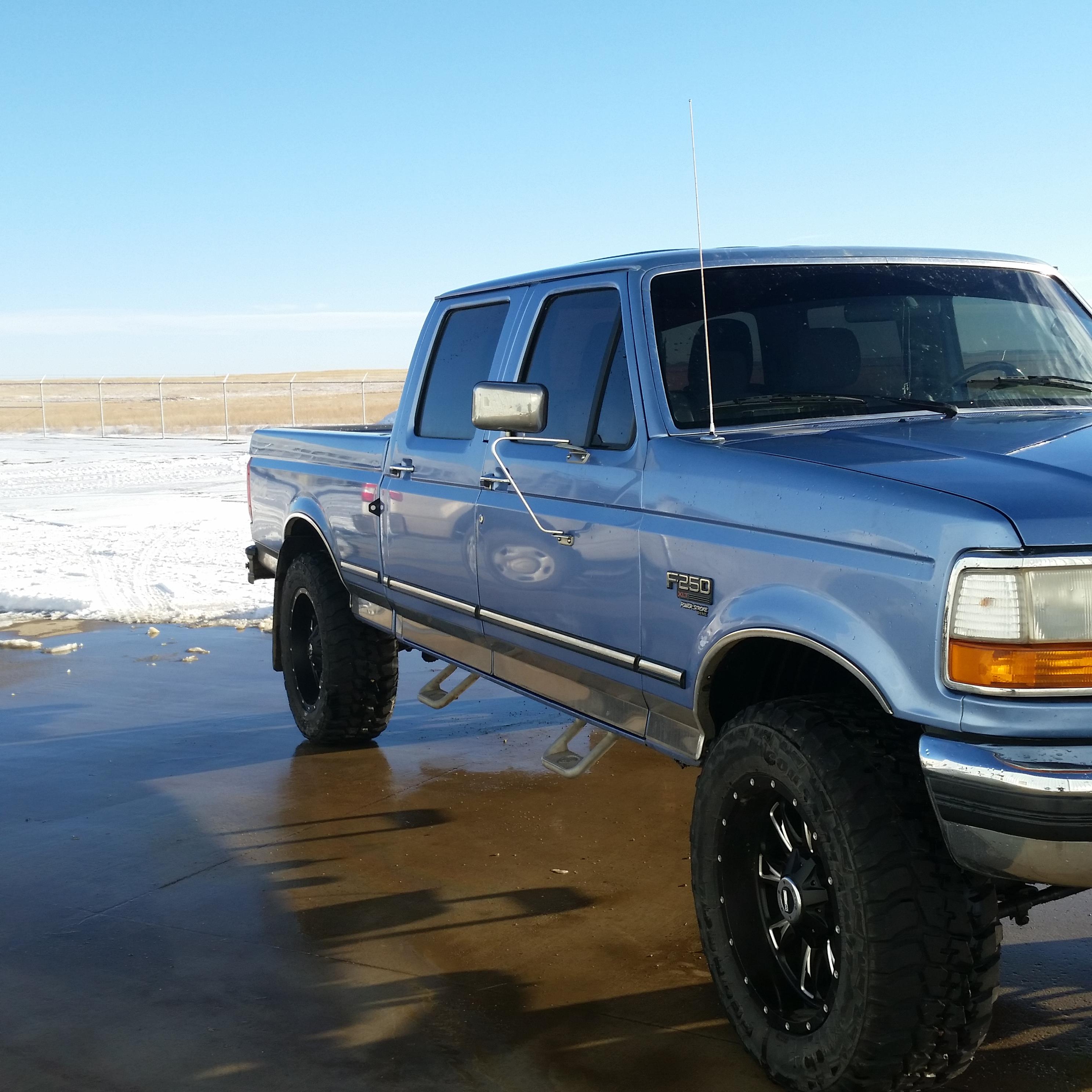

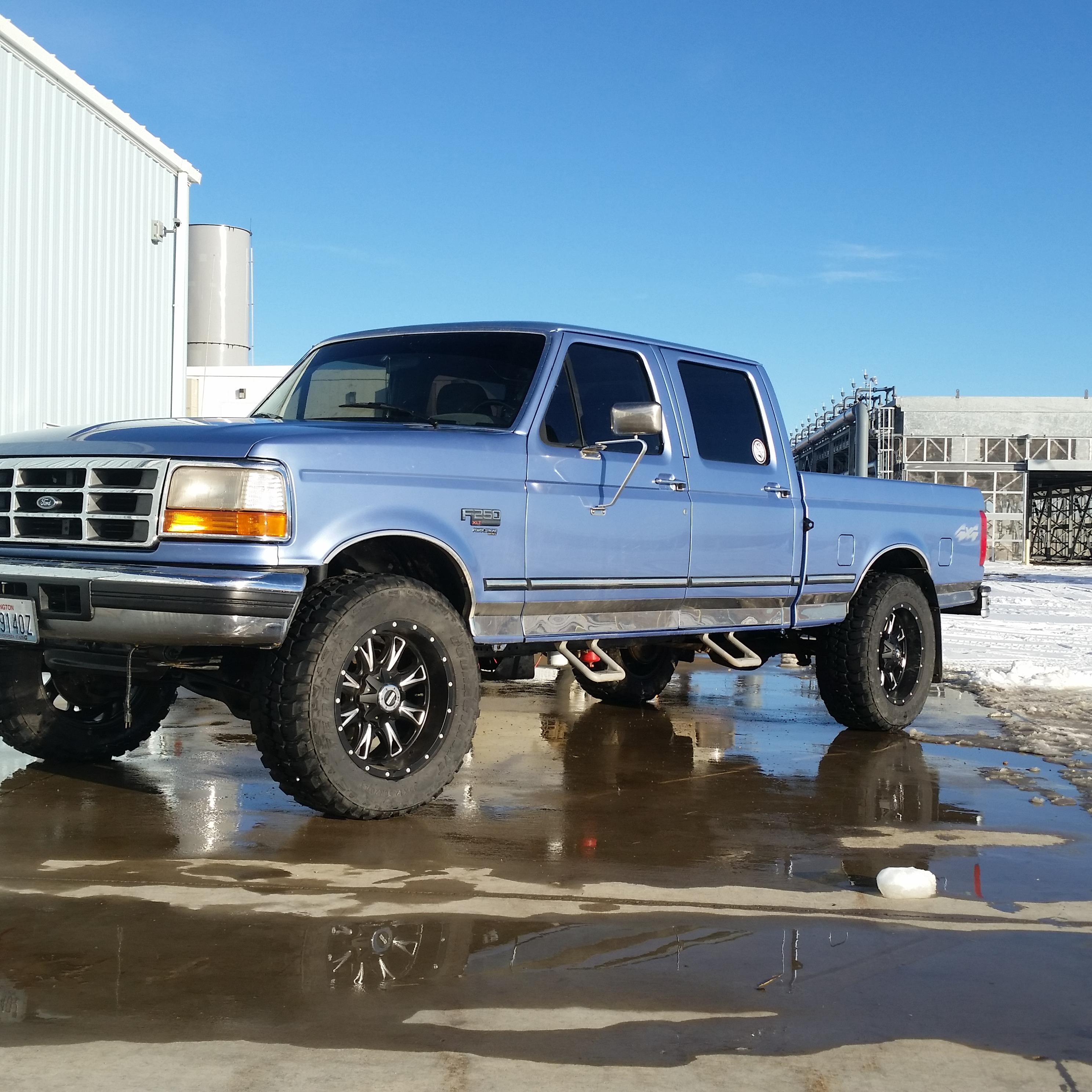

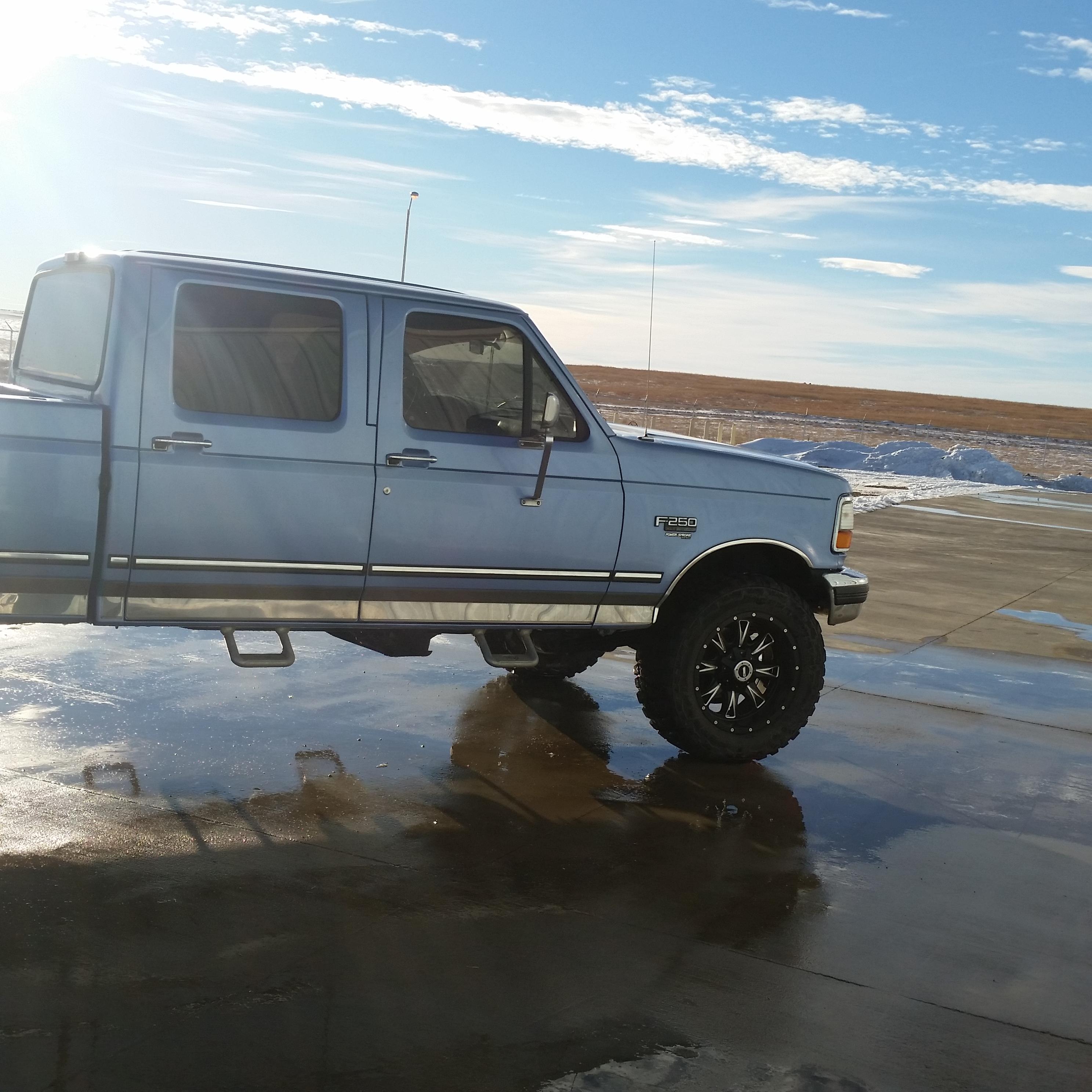

Stock height.. bumper is spaced forward 3" and trimmed a little bit. no rubbing issues rims are 20x10s
