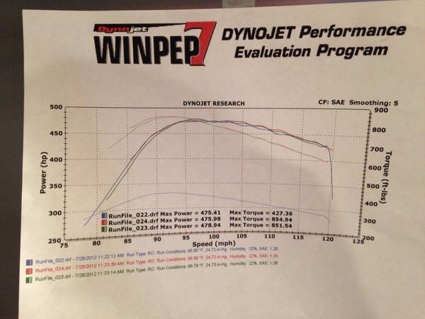

The setup was:
250/200 FFD injectors
38R with deleted EPBV
AFE Stage II
MBRP 4" exhaust
6.0L intercooler
BTS Trans
5r110 trans cooler
Stock HPOP
Billet aluminum intake plenums
Home built fuel system with Walbro pump and regulated return
6" lift, 36" tires, 4.30 gears
My own tunes. Pulsewidth maxed at 2.3ms, about 3100 psi of ICP, boost I don't know because my gauge pegs out at 35 psi... probably close to 40 psi on those runs.
Here's the dyno sheet. First run didn't record torque correctly, 2nd and 3rd run did. Granted this was with correction, but also done close to 6,000 ft elevation. Notice how the torque curve leading up to the peak doesn't resemble a stripper pole:
