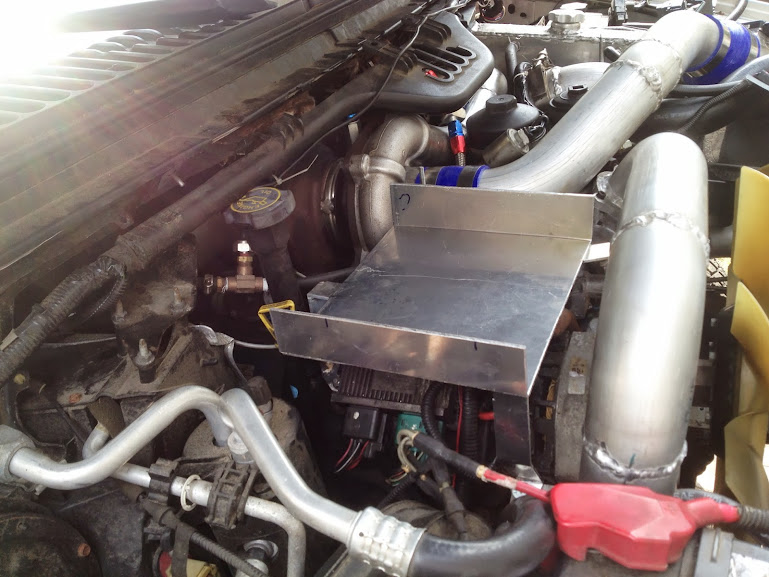

New mount for the FICM so do not have another OOPS moment and blow another $550.

Here is the FICM in its new permanent location, safely away from harms way of the battery's positive terminal. Hopefully no stray baseballs or small meteors will find their way to that spot on the hood.

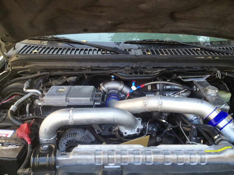

Another angle of the new FICM location. Please spare the criticism of my welds. I am just learning how to TIG weld, they're all air tight at the least.

It's looking great!! Congratulations on your upcoming baby! Pics of the little guy/gal are going to be mandatory I think

That's awesome man! Get the piping and FICM powder coated when you're all done, that'd be sick

Thanks for the good words guys! I'll definitely have some baby photo's come February. A photographer friend of ours will be doing some belly shots of my wife before she pops, I'll post some of those when the time comes as well.
