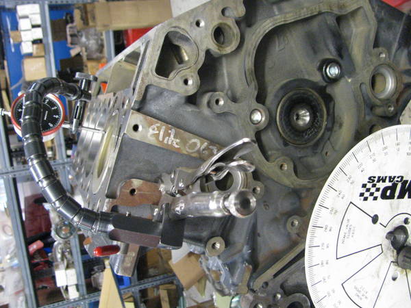

engine coming together. Won't be needing the mock-up unit any more!
Are you using the dial indicator and degree wheel to find top dead center? Are you using this to check piston height?. If so I guess I dont usually see it done that way. I usually use the deck height measuring tool for the block and then subtract the rotating height (1/2 crank stroke + rod center to center + piston compression height = stack height) to figure piston height on a block. The dial indicator will work but it doesn't give you a true reading because of piston rock.
If your using it for something else then disregard the previous statement. I'm just curious.
Fast-6.0
771
Alamosa, CO
Using it to find TDC on the degree wheel for degreeing the camshaft.

That was what I originally thought. I wasn't sure how necessary that was without an adjustable cam gear. Are you just jumping to the next tooth or are you re-indexing the cam in reference to the gear with an offset key?
Depends on what is required. I have jumped a tooth but typically that's way too much. I have a gear that is machined to two additional keyway slots to fine tune as needed. That way I can advance or retard the cam 4 deg or 8 deg.
