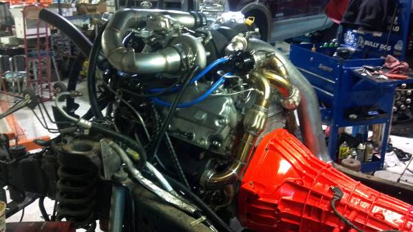

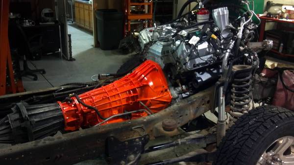

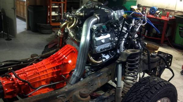

Update:
We finally got another key component in for the truck. Stage 4 transmission with Extreme Duty converter. Steed speed manifolds & FS 2500 are also on.
A few more days, and the turbos & up pipes will be on.
