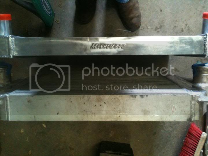

here are some pics next to a Sperco. is it a bigger core than that now?
Not sure what the core thickness is on the Spearco unit, our thickness is 3.35" which we found to fit perfectly and provide the efficiency needed for both stock and modified trucks. Although core thickness is a key component for heat transfer, keep in mind that core composition and fin density also play key roles in reducing intake temperatures.

I would assume they are now including the inlet/outlet and brackets in the new dimension.
Correct! Our new dimensions include the brackets attached to to the end tanks as well. Our new intercooler design provides a core thickness of 3.35".
